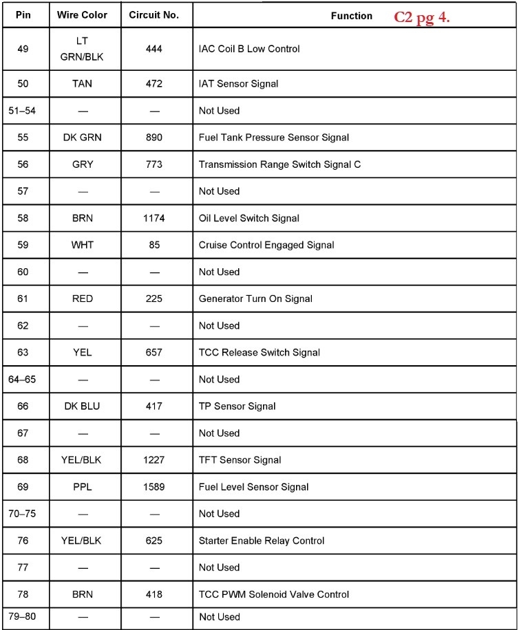

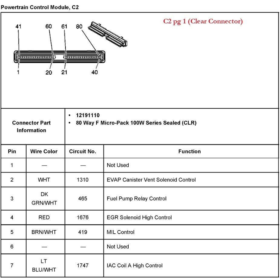

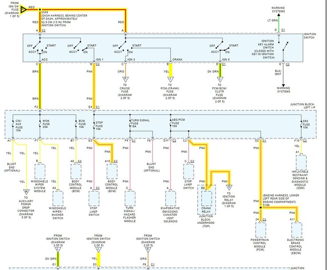

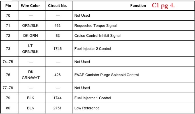

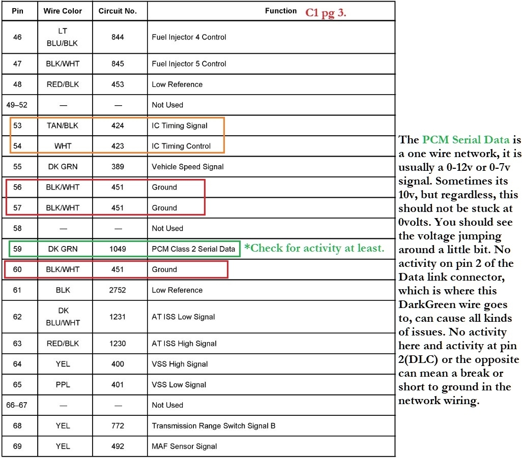

I will look up the powers and grounds for the PCM. The IC timing signal and the IC timing control are both PCM outputs to the ICM. Remember that when the ICM is in bypass mode during cranking, it grounds both of those circuits so you would read 0volts on them during that time. The PCM will then apply 5volts to the IC timing signal circuit which switches the ICM spark advance/timing to the PCM. So that 5volts being applied from the PCM is what will cause the ICM to switch over timing.
At this point you have no spark and no injector pulse, correct?
Monday, June 2nd, 2025 AT 6:47 PM
AL514
  • 5,584 POSTS

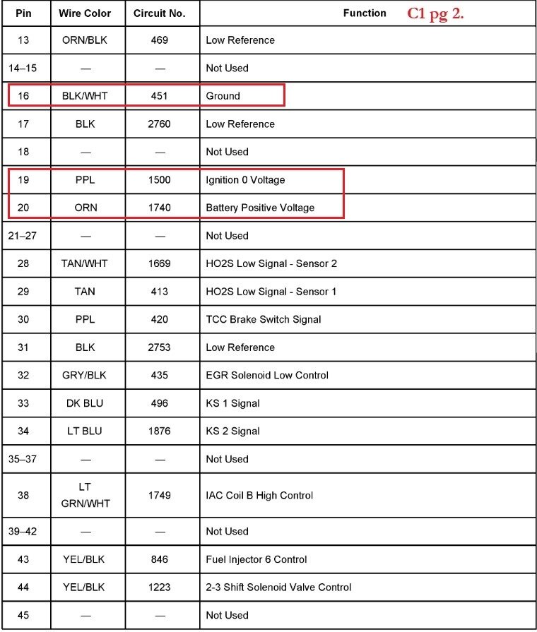

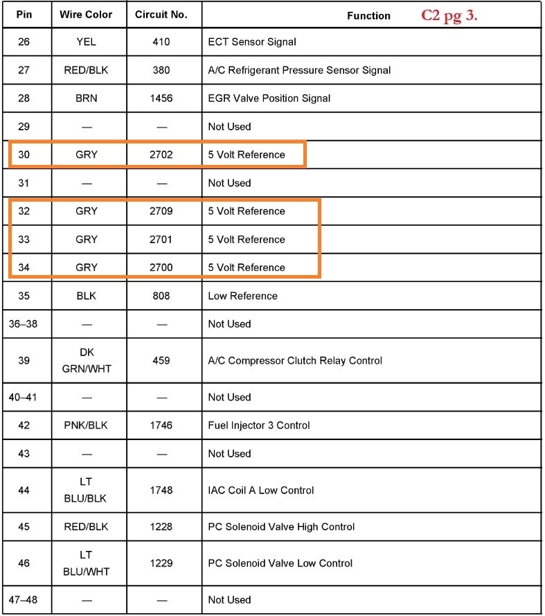

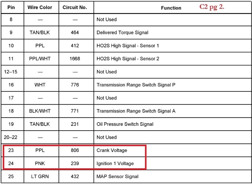

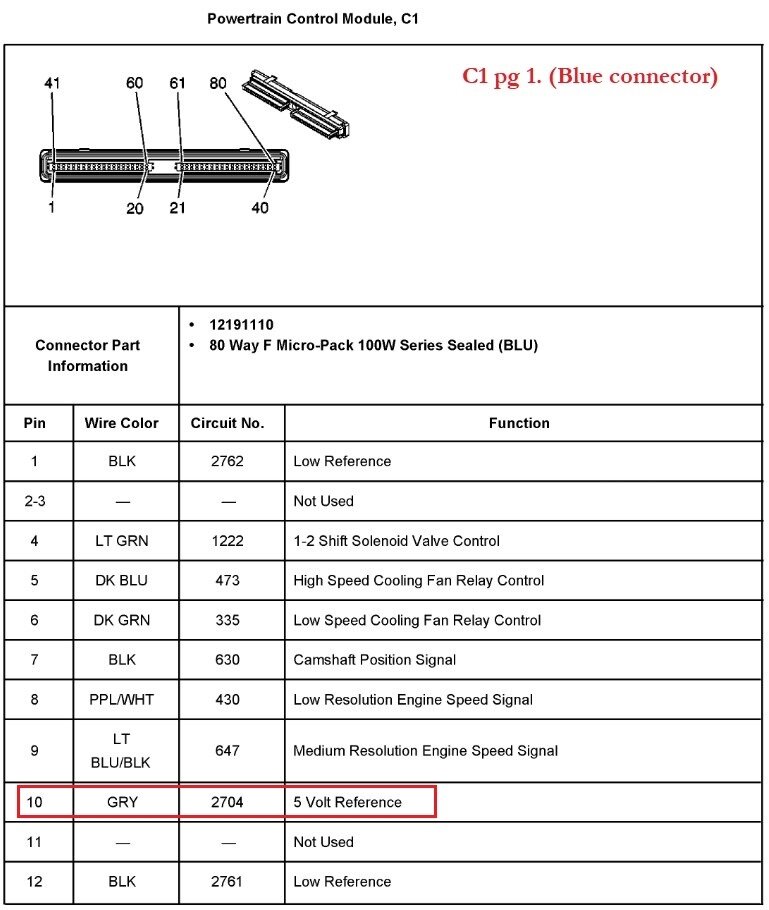

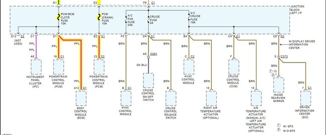

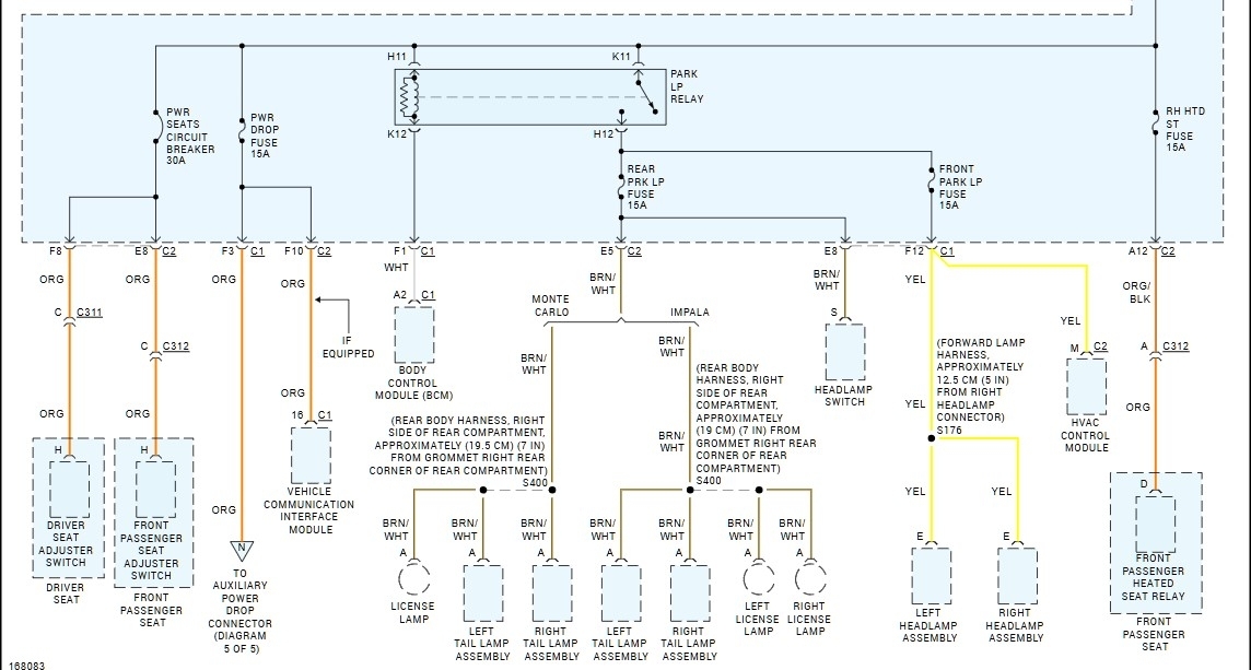

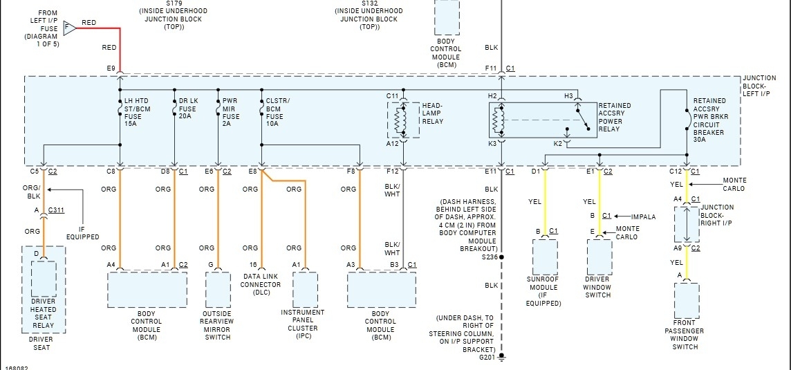

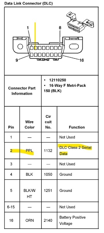

These are your PCM connector pinout diagrams, I will check the power and ground distribution diagrams and post anything relevant. Make sure to load test the PCM powers and grounds from the PCM connectors.
Monday, June 2nd, 2025 AT 7:30 PM
AL514
  • 5,584 POSTS

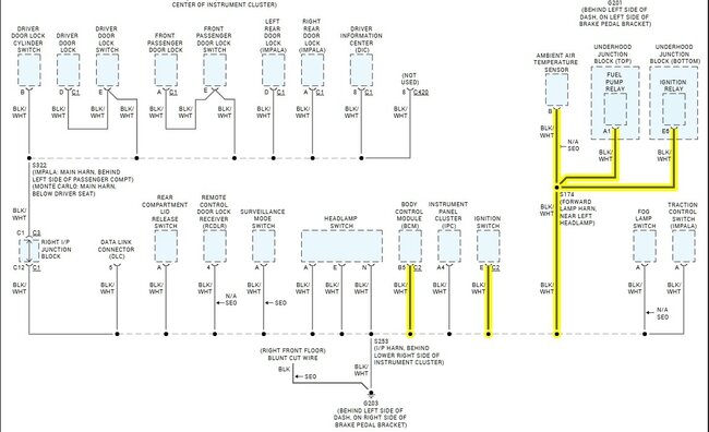

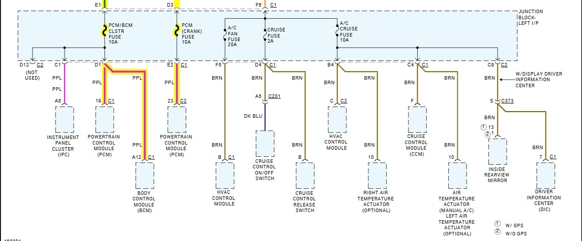

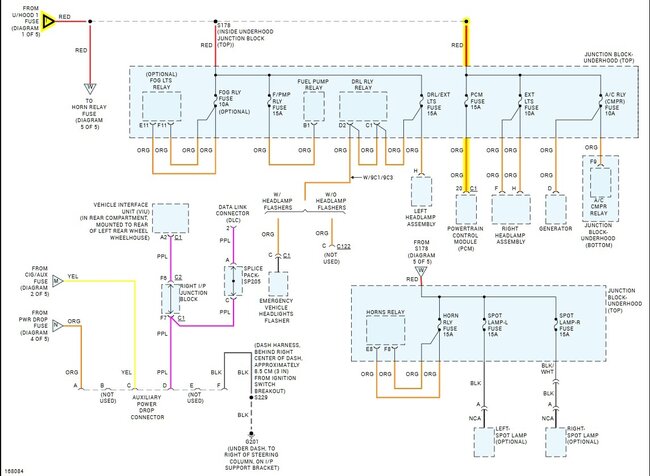

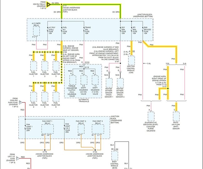

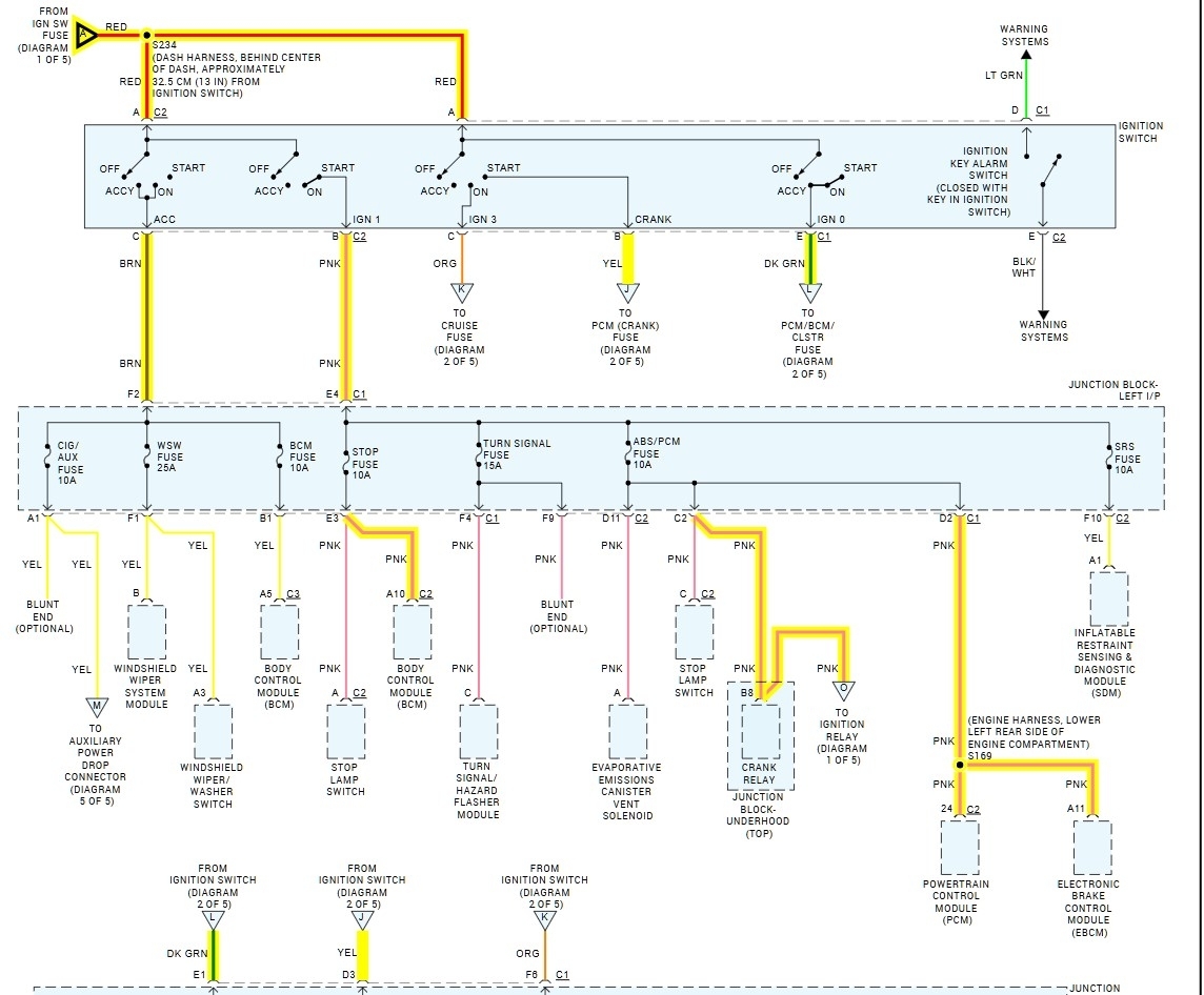

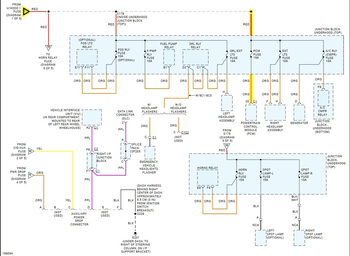

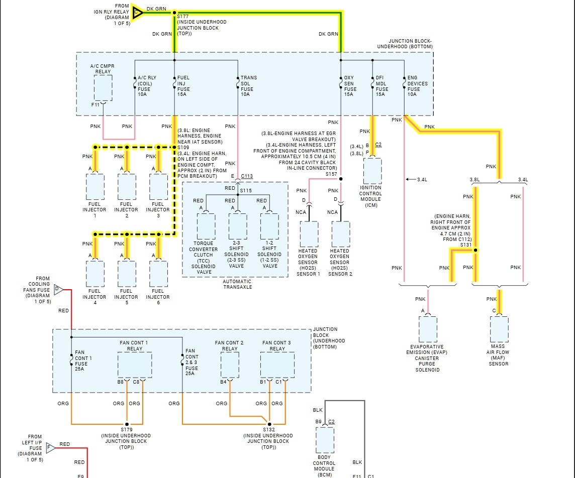

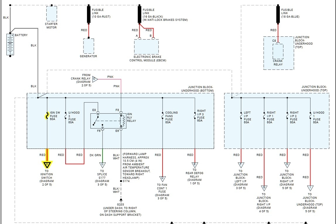

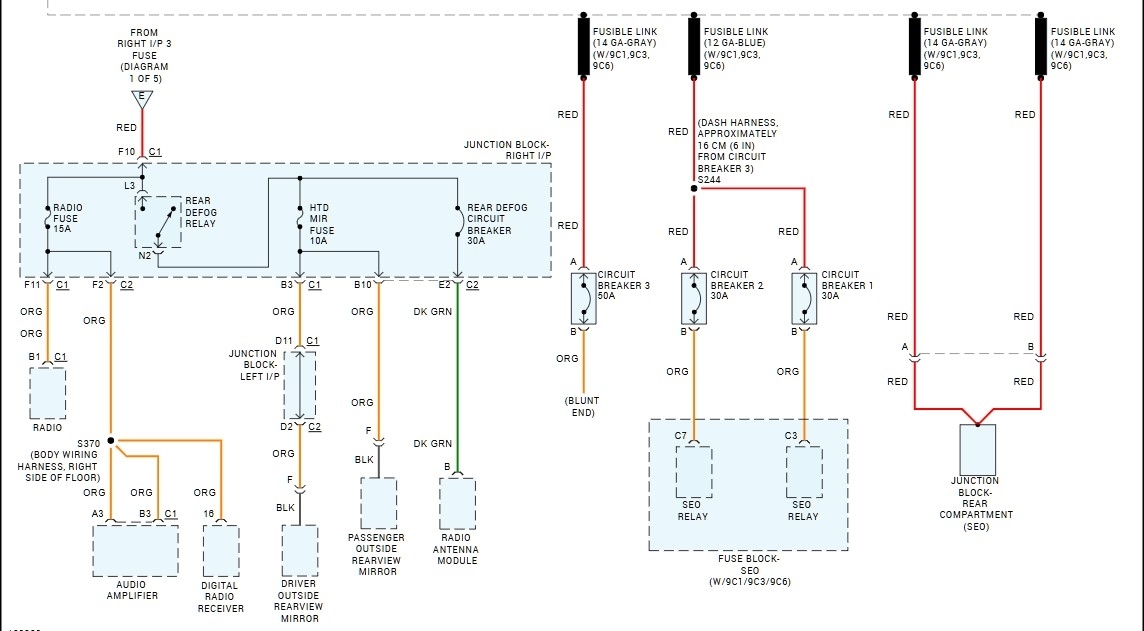

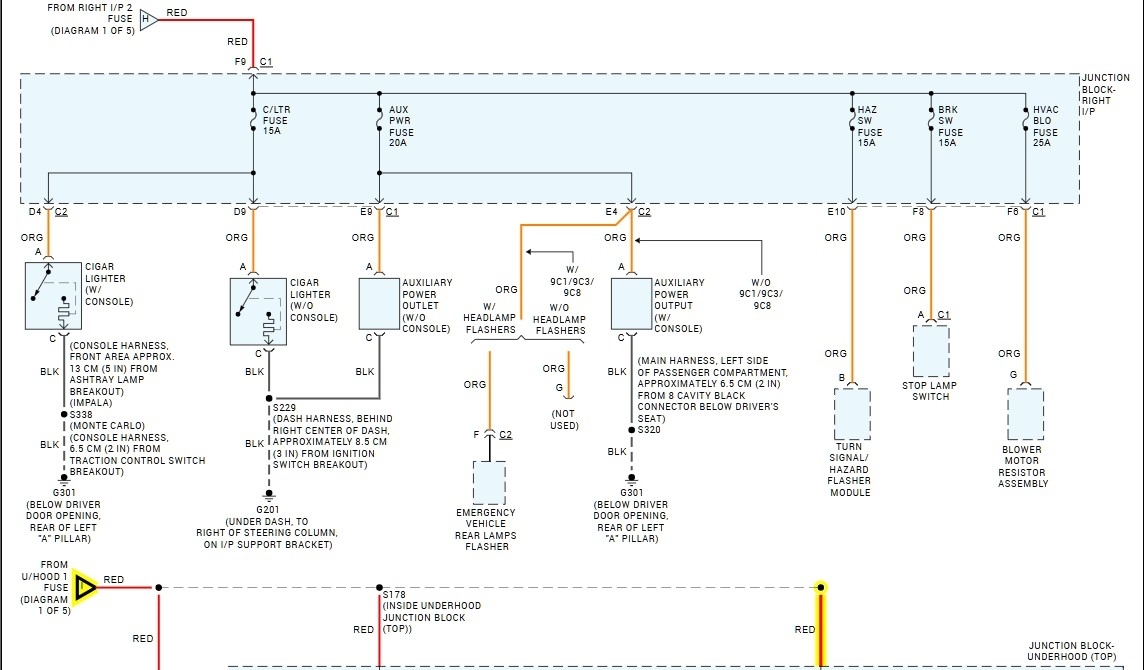

These are the Power Distribution diagrams 1, 2 top/bottom, etc. I'll post the Grounds next, but go through all the fuse panels and check for any signs of corroded fuses or pins in all the fuse panels. Along with any connectors you can get to.
Monday, June 2nd, 2025 AT 8:35 PM

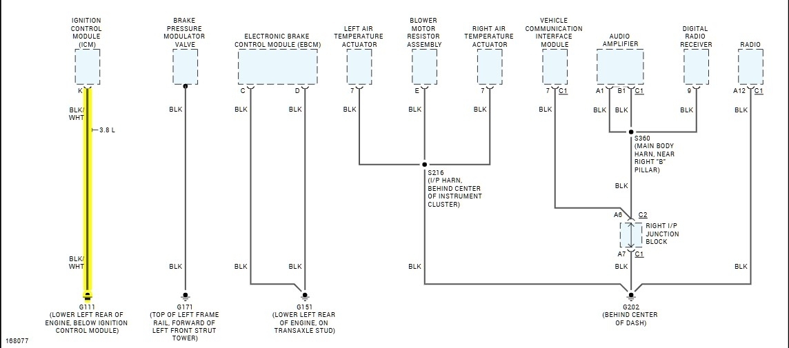

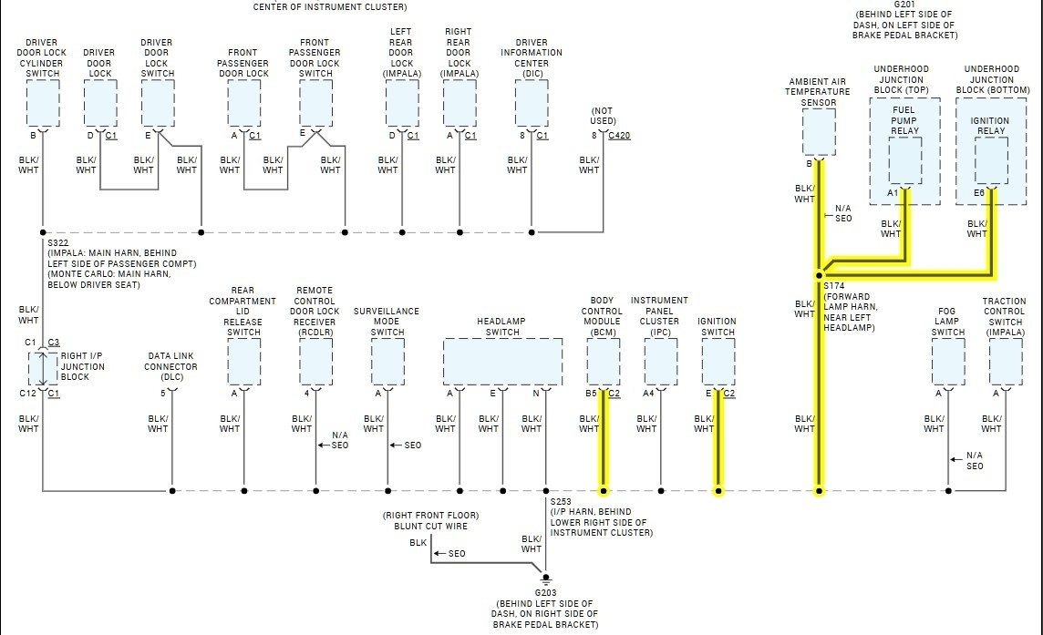

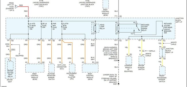

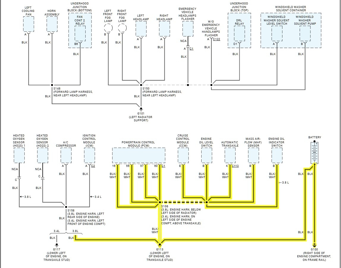

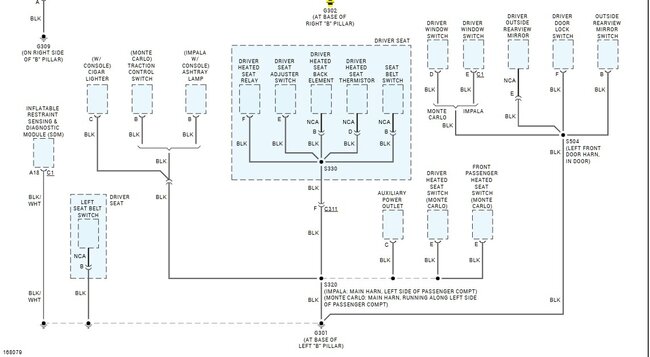

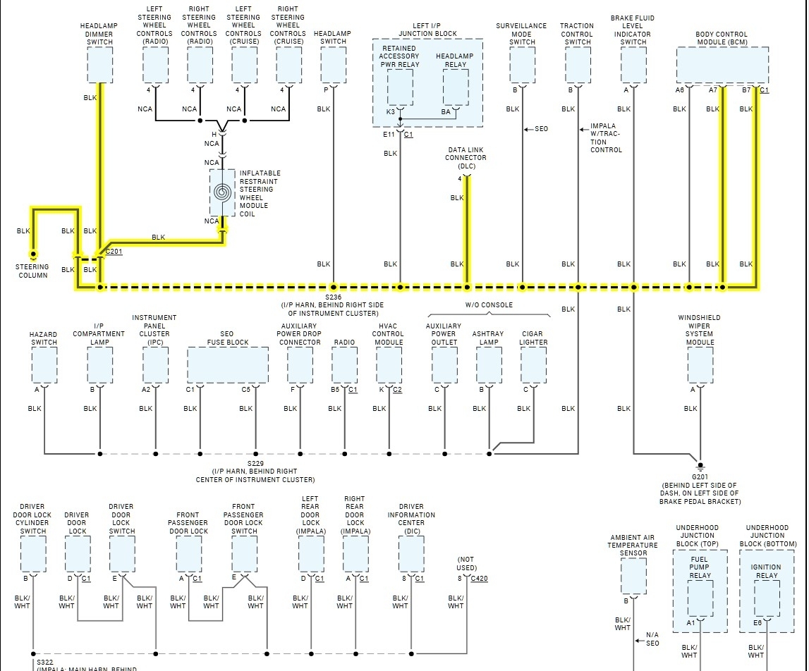

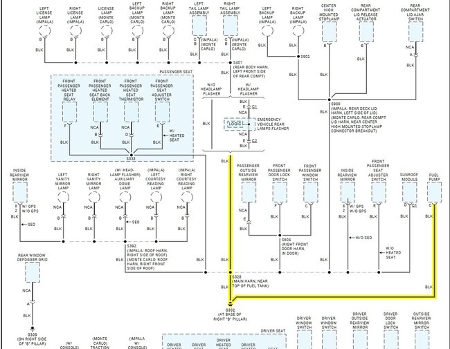

These are 3 pages of ground distribution diagrams, top and bottom.

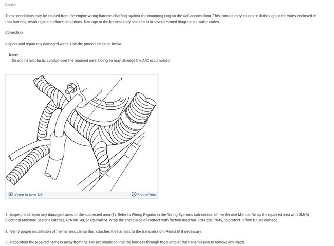

One last thing, what is all the live data from the PCM reading, can I see every data PID. And you need to check for an injector control pulse. We need to make sure there is power and injector pulse when cranking and recheck for spark on multiple wires. We need more information here.
There are TSBs on wiring rubbing threw at certain contact points, these need to be checked as well.

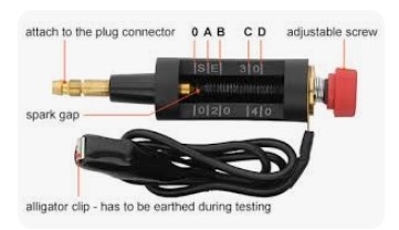

I have a question about the spark. When the car was running several months ago the coils were sparking a fat blue spark with loud clicking. I checked the coils the other day and now there is a thin white spark with quiet clicking but the car is running. Whats better a fat blue spark or a thin white spark?

Save your money, Im just glad you got it going, my guess is that after so much cranking and testing the cylinders were washed down from all the fuel. Cylinder wash will cause low compression and the spark plugs were probably fouled out with fuel as well. As for checking the quality of ignition spark, buy one of the spark testers that has an adjustable gap on it, so you can set the gap to 20k, 40k, etc. This stresses the coil to see if it can jump those higher gaps, I wouldnt go over 30-40k on it, but it will show you a nice blue spark with a loud snap sound. I was hoping we would come to more of a definitive diagnosis, but I think the ICM was bad for one, with no trouble codes setting after it running so many times, what I mentioned above was probably what was going on. These things can pile up quick when cranking with no spark. Before you know it, you have low compression and such.

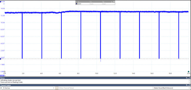

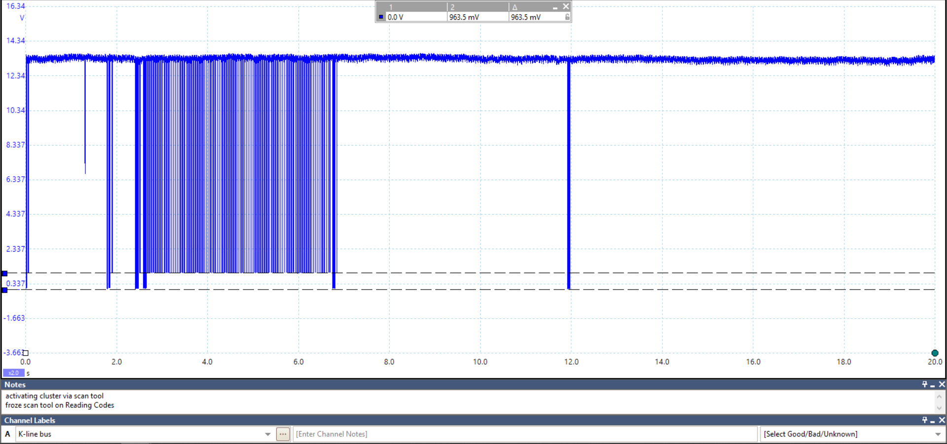

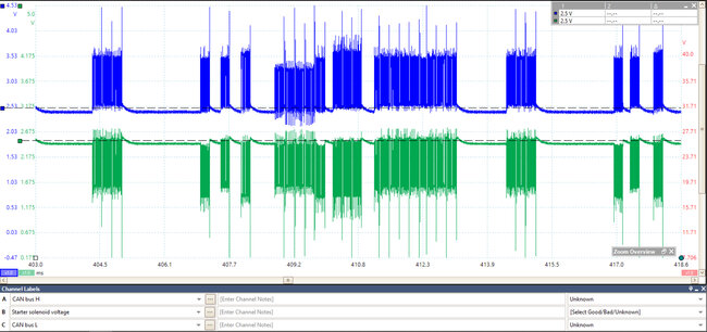

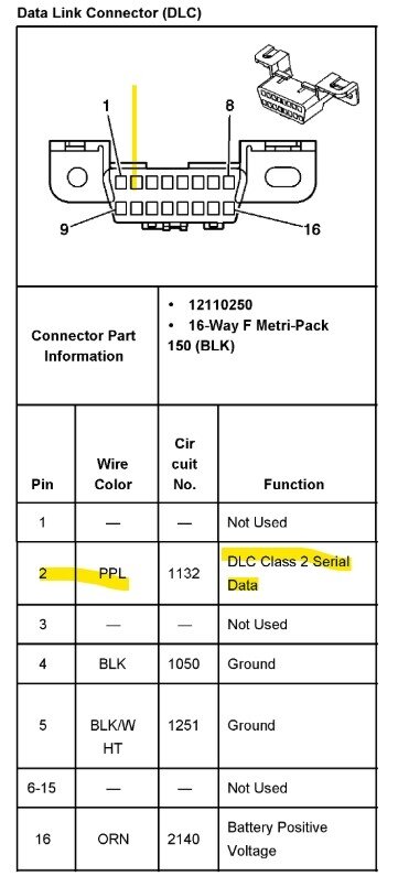

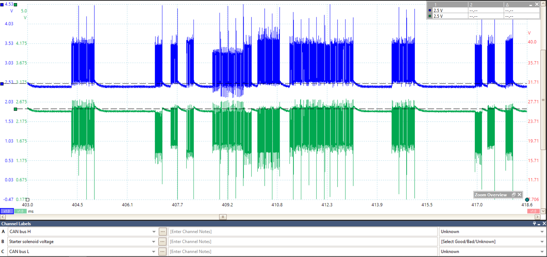

These are a couple of very simple waveforms I captured from a 2013 Hyundai Sonata, this is the K-Line network which is what is used for a scan tool to communicate with this particular vehicle. This vehicle has a fault with the instrument cluster, in the first picture the pulses are my scan tool trying to communicate with the cluster, except the cluster froze its communications when I tried to read codes from it, the 2nd picture (and you can see the difference in voltage levels here) is where the cluster finally responded. The 3rd picture is the vehicles Can Bus High speed network where you can see the voltage levels are all over the place. But there would be no way to know what was happening with the vehicle without a scope, the scan tool would just sit there with a frozen screen trying to read trouble codes and I would have had no idea what was wrong. Granted this is the technical side of things, but you could have checked your cam and crank signals in 5 minutes to see if they looked correct. Not even having to replace any parts until you know whats actually wrong, just the benefits of learning new things. I fully understand the hesitation of it all, buts its like everything else, once you learn it, you are ahead of all the guys that dont use this type of equipment and are just changing parts until they happen to fix something.
This is also the Pico 6 automotive software that has guided tests, tells you where and how to hook up the scope to the vehicle and what to expect for a waveform.
