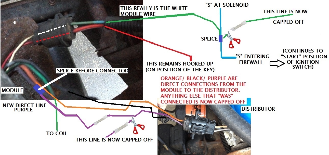

Can I just follow the wiring used in the nutter bypass, or are we wiring it differently?

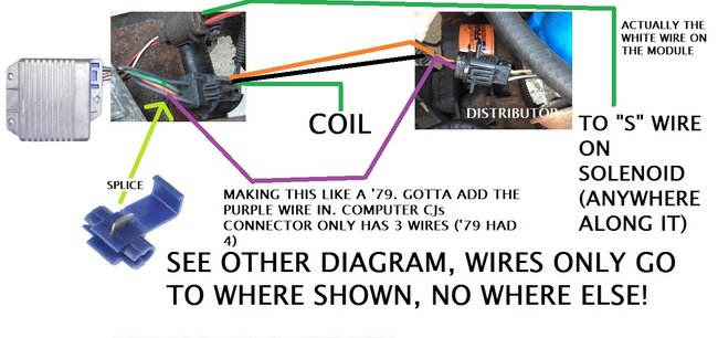

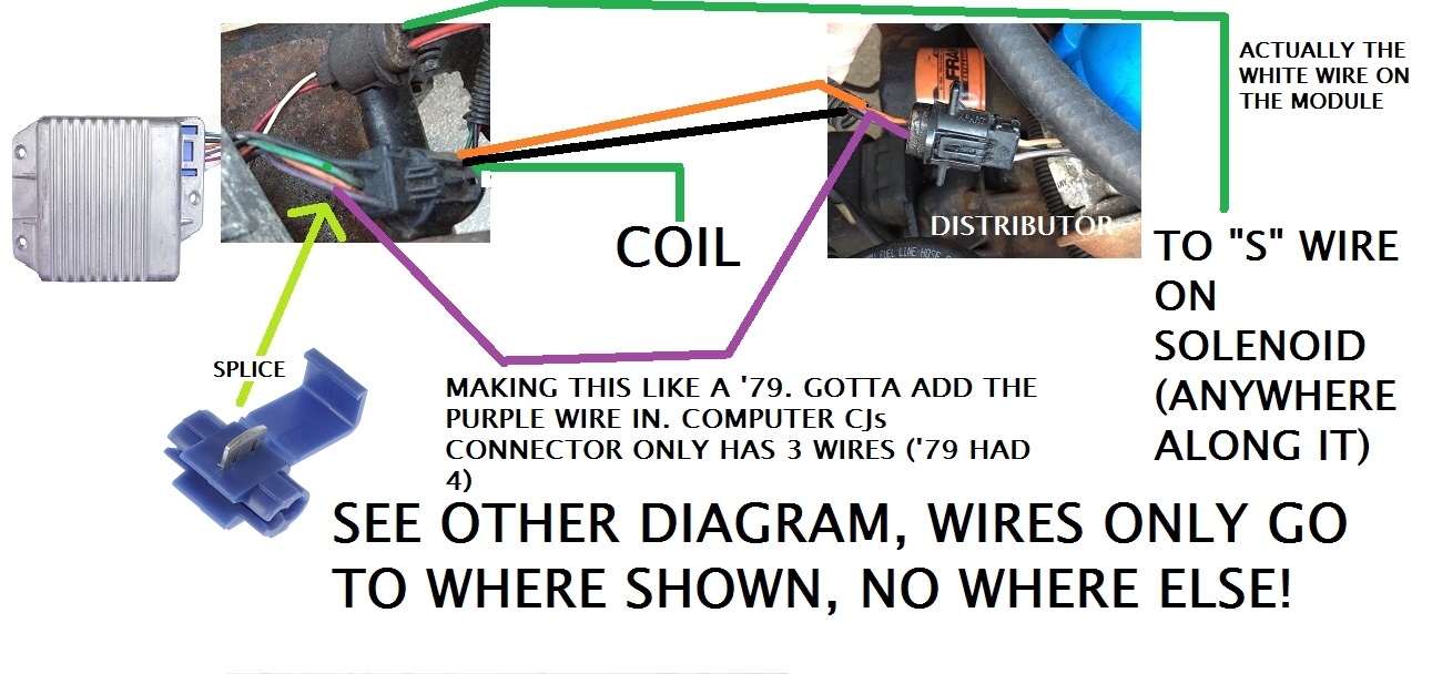

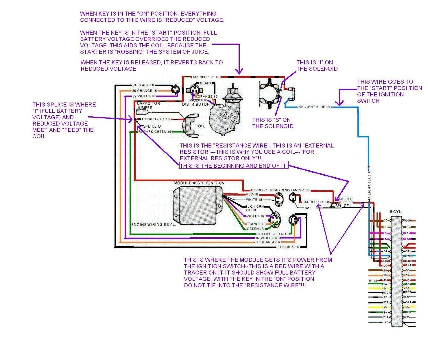

Will this get you going?
The 1st pic is the "Standard" we are trying to achieve.

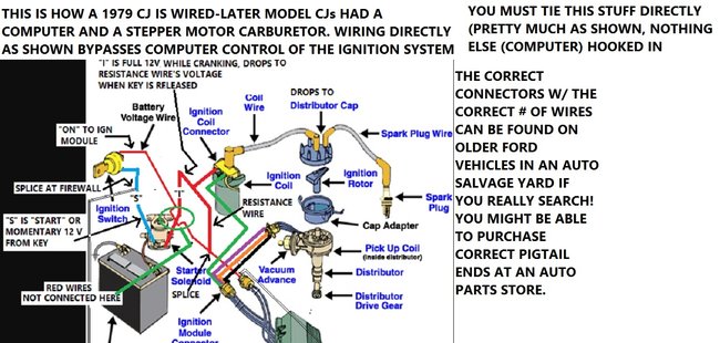

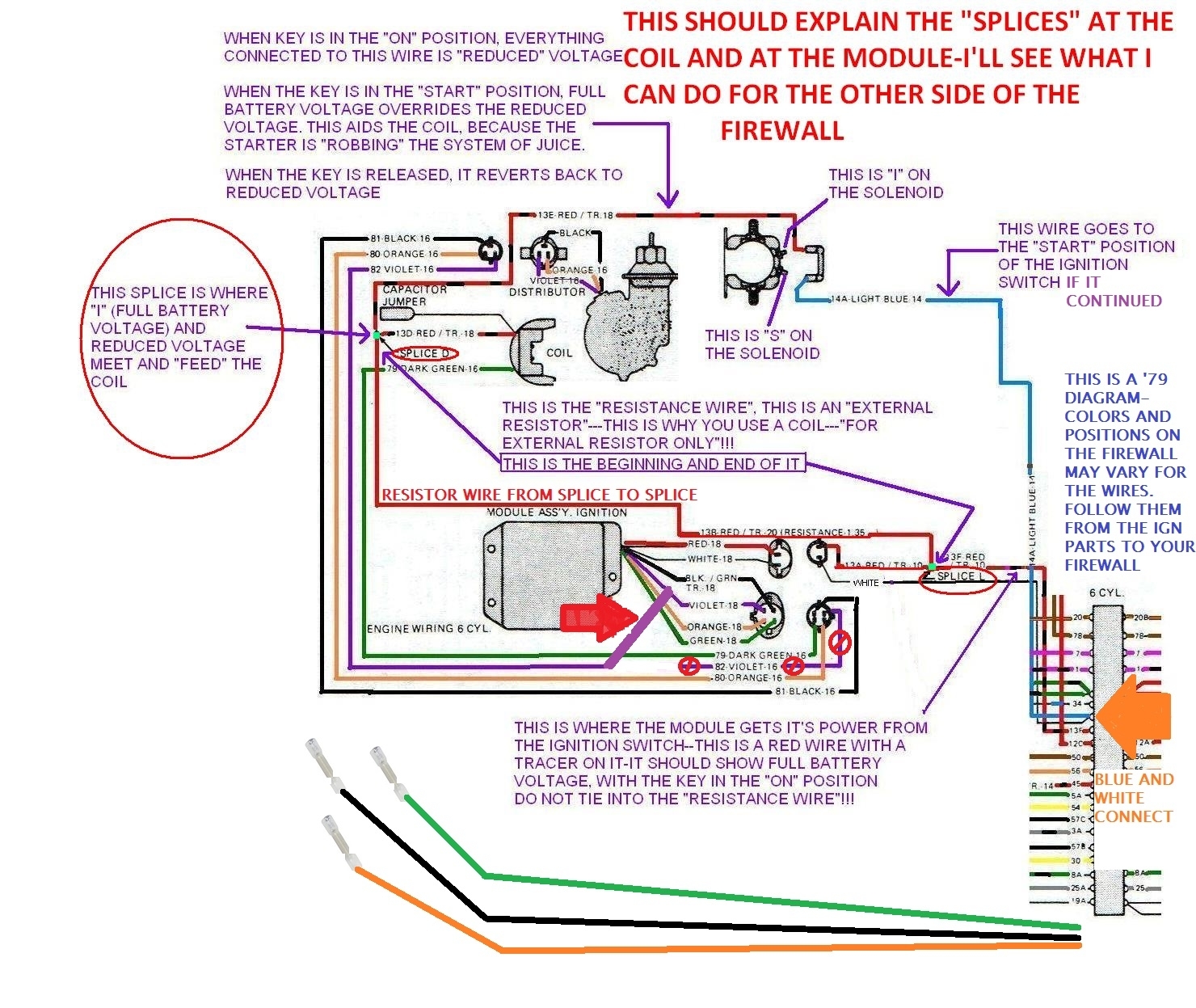

Thanks. This looks good, but I'm kind of lost between the 3 pictures. The middle one I understand, but the other two, are they showing additional wires that need to be cut and rerouted?
Thursday, May 18th, 2017 AT 6:50 PM
CJA31186
  • 89 POSTS
Think I understand now. Purple black and orange get cut at the ignition module and rerouted directly to the same color wires at the distributor. The green wire gets cut at the module and rerouted directly to the green wire on the coil. The white wire from the module gets cut and rerouted directly to the S wire on the solenoid. Then finally the red wire does not get cut, but spliced into at the module, then with that splice gets connected to the red wire at the coil, with another splice from the red wire at the coil going directly to the "I" side of the solenoid. Is that correct? Am I missing anything with the blue wire needing to get spliced?
Thursday, May 18th, 2017 AT 7:29 PM
CJ MEDEVAC
  • 11,005 POSTS
Those additional wires are probably there, just running all over the place in wire looms before they set to their destination.
They are all the same in the 3 diagrams as far as the IGN module to the distributor
and
The IGN module to going to the "S" wire (follow the white one from the module body) The white wire turns to green thru the connector on "your" Jeep (consider it still being white as it continues). In Diagram 1 "White wires" are shown as thin black ones (usually labeled as white)
Look at 1st diagram, the white wire is white the whole way, and it connects to the "S" wire (blue) at the firewall (it COULD connect to to that blue wire anywhere, as long as it connects!)
As you try to duplicate the diagram, if you have to cut a wire loose to do this (such as keeping the purple wire from the distributor) (but getting rid of the other end going to the computer) Crimp one side of a butt splice onto that unneeded wire to keep it from touching stuff.
Now you can tie the purple to the IGN module's purple. Purple is now a straight shot to the distributor. IT GOES NO WHERE ELSE!
Make sure the other wires work out as a straight shot, disregard and half butt splice anything unneeded!
In the end, you should be able to look like diagram 1's Module set up.
DISREGARD all of the other wires that I censored away at the firewall.
1st Diagram At the firewall I show a Red wire with a stripe (stripe color unknown) it runs to the IGN module 2 wire connector (this is a Regular Wire!). If you back up a hair from the module, you will see a splice.
The resistance wire starts here (it is a resistance wire, not a regular wire), it should still be part of your Jeep. Using the diagram, find it, KEEP IT! Do not tie anything else to it! Insure it runs up near the coil and splices into Regular wire!
So, basically 2 reg wires tie to the TEE near the module, along with the resistance wire
At the other end of the resistance wire, the resistance wire ties into a TEE with 2 regular wires (one to the coil, the other to "I" terminal of the Solenoid) ALL OF THAT OUGHTTA STILL BE ON YOUR JEEP, They may go around the world in wire looms to get there!
Lemme know if things on your Jeep are as in diagram 1, Straight shots to the appliances, anything else unused being 'capped off'.
YES, if you get lost, STOP and ask me!
Did any of that aid you at all, I do get carried away!
I'd rather you take pics, Draw pics, ask questions, instead of hooking something wrong and frying stuff.

WE ARE KEEPING the 3 wires!
The only mod to the IGN module is the splice onto the purple wire.
Your Black/ Green/ Orange wires will run as far as possible then get spliced onto where they go from the IGN module connector. Everybody else that deviates from the diagram gets whacked and capped!
Follow the purple from the distributor a distance, then connect it to the purple from the IGN module. Whatever you had to whack loose gets capped.
Try to keep this stuff "Loomed Up"and perty! No need in wires going every which-a-way!

So it sounds like the red wire is already set up the way it should be. Is that correct?
Thursday, May 18th, 2017 AT 8:12 PM
CJA31186
  • 89 POSTS
When you say the orange, black, and green wires get spliced into, should I cut them then connect them directly to the same wires going to the distributor? Or splice into them still keeping the connections through the firewall?

Maybe you misunderstood. I meant after the connection on the ignition module. Instead of those black green and orange wires going into the firewall, I would cut them and connect directly to the same color wires at the distributor. Is that correct?
Thursday, May 18th, 2017 AT 8:33 PM
CJ MEDEVAC
  • 11,005 POSTS
ROGER DODGER!
The green drops off at the Coil
Tie the Black and Orange into the wires before you get to the connector for the distributor. This will keep the distributor as a Removable Component by un-connecting it at the connector.
The Purple will generate from the purple wire on the Module with the splice shown in a previous diagram (Sorry, kinda the only way to get purple to be like a '79) (in order to replace the Module, it will have to be cut loose from the purple wire to the distributor harness).
Tie the purple into the 3 wire harness before the distributor connector.
The wires that did not show in the plan (diagram) the ones that you cut loose (leave a few inches), These will get one side of a butt splice squished on to them so they don't ground out (no need in even skinning them bare- they are now useless) Roll 'em up and tie them out of the way.
I played with my diagram some more.
Is this better?
Module to fender- break or drill out the holes.
You can remount it close to where it was with sheet metal screws. INSURE the module body is grounded!

Ok so just to make sure, after the connection piece is connected to the ignition module, I cut the white wire, attach a wire connector piece then put a new wire into the connection piece and connect the white wire into the wire that goes to the s on the solenoid. Is that correct? Do I leave the wire that goes to the "s" side of the solenoid uncut so that it continues with the old connection in addition to getting the white wire connected to it? Or do I also cut the wire going to the "s" side of the solenoid so that it only connects to the white wire coming from the module?
Wednesday, May 24th, 2017 AT 6:12 PM
CJ MEDEVAC
  • 11,005 POSTS
"S" basically is the "Start Position" of the key. It has to continue to do it's original job!
You will tie the white wire into it (meaning the continuation of the white wire from the module)
Made you another diagram below.
So far you follow directions well (Like don't do nuthin' you are unsure of!)
This diagram help any better?
The Medic

Ok I completed all the wire and installed new module. New carb is on too. Turned mixture screws 3 turns out from the seated position. Jeep started right up with the new wiring and vacuum routing. It's not even tuned yet and it's already running excellent! Very smooth. So, what do I do now to tune the engine correctly?
