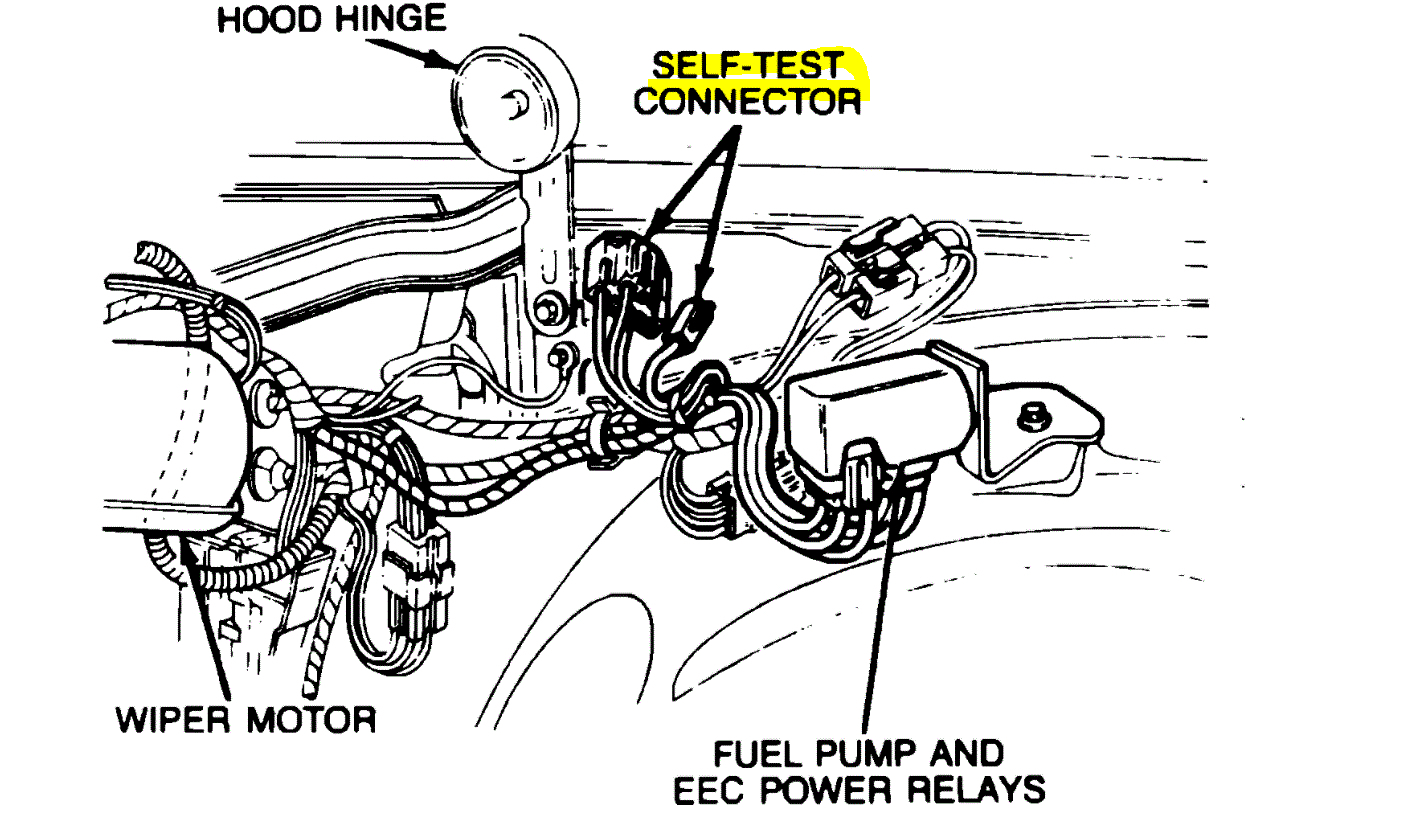

If nothing is found, then check to see if there are diagnostic trouble codes stored. This vehicle has an OBD1 computer system. It doesn't require a scan tool to retrieve codes. Follow the directions in this link and let me know if you retrieve any codes and what they are:
https://www.2carpros.com/articles/ford-lincoln-mercury-obd1-1995-and-earlier-diagnostic-trouble-code-definition-and-retrieval
If you look at the pic below, it shows the self-test connector location. It will be under the hood, driver's side toward the rear of the inner fender liner.
See pic below.

I was able ( I believe) to locate the obd1 self-test connectors- they were more toward the front end. Today I called the authorized Ford dealership near me and for a scan and diagnosing of the vehicle they are telling me $185.00 usd.

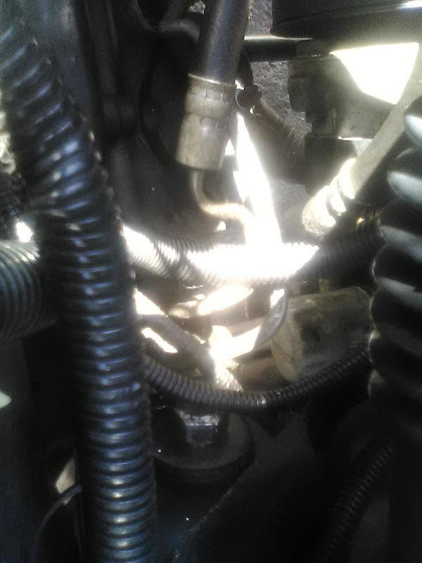

No problem. The differential can be leaking from only a couple of places, the cover on the rear of it or the front pinion seal. If possible, let me know if you are able to get pics.
As far as the radiator, it sounds like the upper radiator hose may be the cause. Let me know what he tells you. If you want to get a few pics of where it is wet, upload them for me to see.

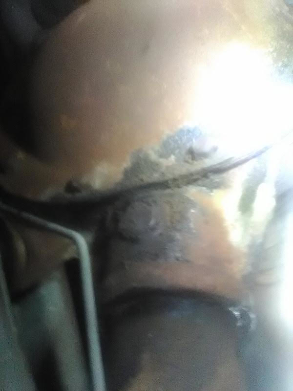

Hi Joe- I really want to thank you for this help. This mechanic I got from craigslist, who put the new radiator and bushings in, he came by last night to check out the leak. He seemed to determine that it was coming from the transmission cooling line at the radiator. He attempted a fix, first by tightening it at the radiator. He then had me drive it around the block and looked at it again and determined that it was still leaking. He tried tightening it up more a bit and was having me start the engine, each time determining that it was still leaking. He then went to his vehicle and came back with a shiny new fixture-the one that came with the radiator he told me, and he tried to connect the hose to the radiator using this new fixture that came w the radiator- he said the reason that he did not use this new one the first time was because he could not get the hose to fit into it properly, so he just used the old one. So, he had me start it up after he finally was able to connect to the new one and it was leaking even worse. So, this is what he did, he went and got some thread sealer and connected the hose to the radiator using the old fixture or nut or whatever it is called. He said it takes 72 hours to cure not to drive it. No problem- this is my question to you- so- there was the green ish coolant liquid sort of on parts of the engine around the radiator- but when I got under the vehicle I was noticing the color of the little bit of liquid that had dripped onto the cement from the radiator and from some unknown other components right around the same area, going about a foot back, this liquid was a reddish color- initially I believed it was the coolant just mixed with some of the oil that was on the surface of some of the undercarriage. But upon researching I see it could be a rusty transmission cooling hose or transmission fluid- and this, from what I read can lead to a big problem. Would the car be leaking both reddish fluid and green coolant if the leak, or, the only leak, was coming from the transmission cooling hose at the radiator? Please let me know exactly what to either photo or check into further regarding this radiator issue. (I am working on the pics of differential) Joe, thank you so very much kind sir.

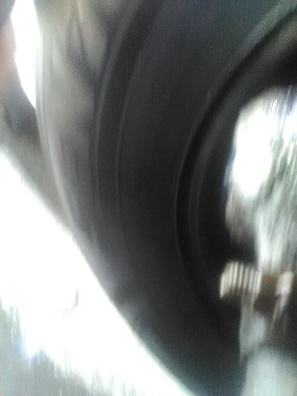

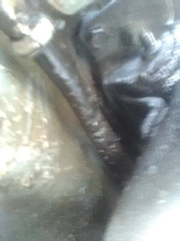

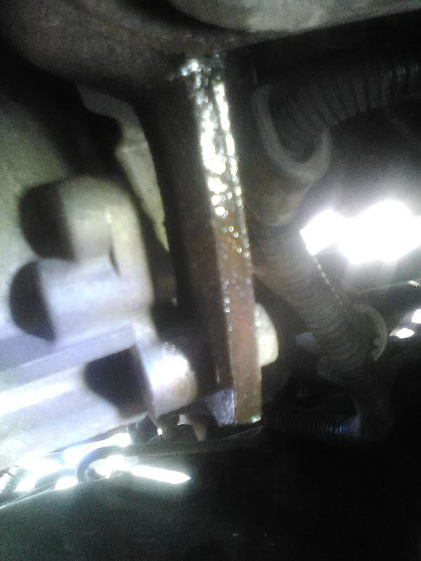

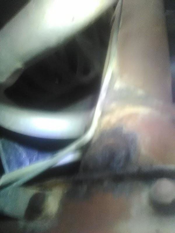

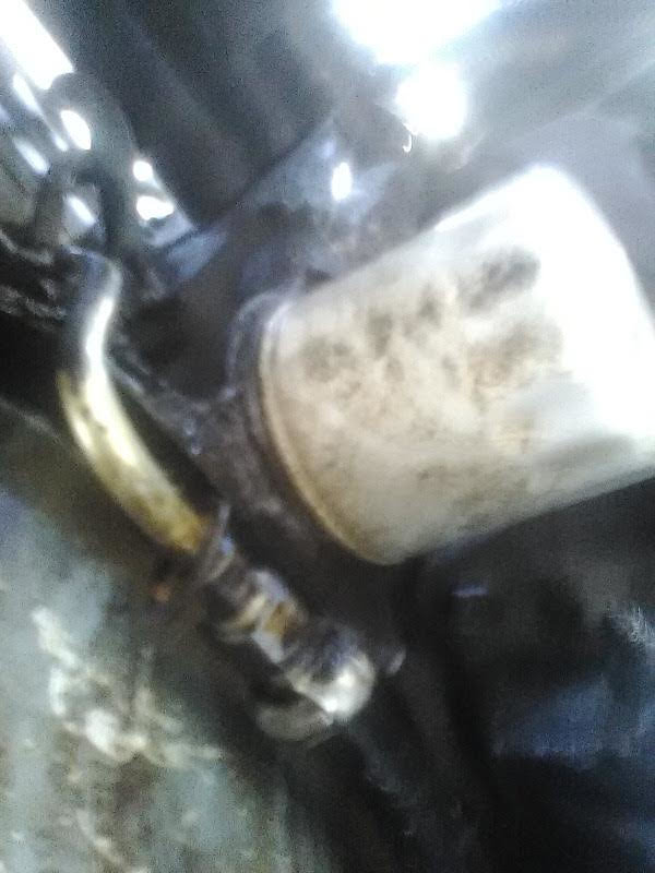

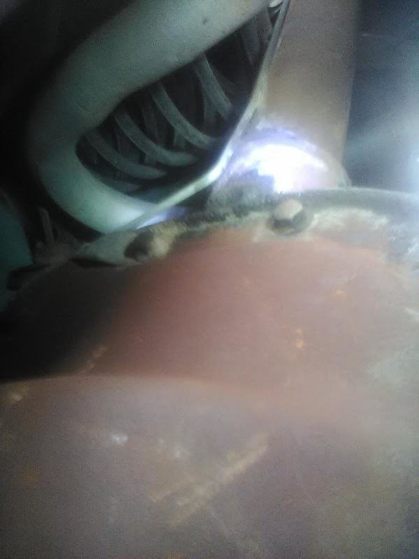

ELIPWOLF
  • 13 POSTS

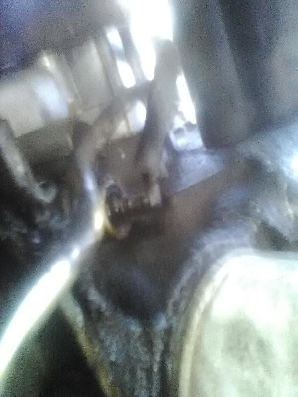

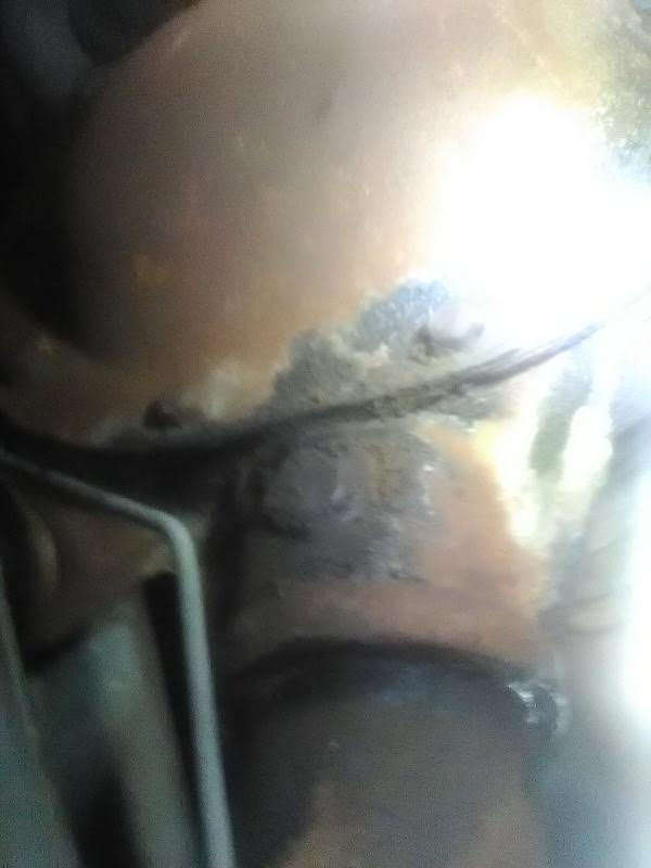

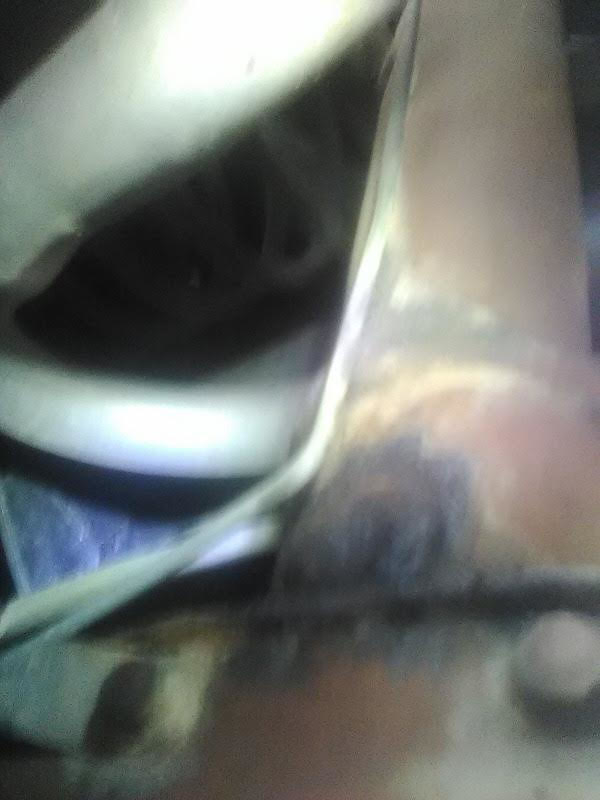

I hope some of these help. Joe, it was hard to get up under the car and take them with a decent perspective having no jack or lift. The front end has a lot of grimy oil covering different parts and so I tried to photo them for you.

The mechanic did not perform a cooling system flush either prior to changing the radiator. He has me buy the radiator off rock auto- sends the link, and this is directly from their page on the radiator:
"Completely drain and flush the system using Cooling System Flush prior to installation. Flushing the system is critical to prevent system contamination and failure."
could this be what the problem is?

Joe, sorry if I am overwhelming you here man- I am pretty sure this radiator problem is a result of the mechanics failure to flush out the cooling system first. What's done is done. Can you please tell me if this can somehow be remedied, is it going to really mess up the engine? What would you do in my shoes to redeem this issue? Is not flushing the cooling system a huge deal or probably no biggie or what? The mechanic won't respond to me so far. Please help if you can. Take care. Eli

  • 110,194 POSTS
As far as the flush, it would have been good to do, but in most cases isn't needed. Okay, is there a new problem with the radiator? Also, the transmission fluid is red in color. Since the radiator was recently replaced, that could be residual. The transmission cooling lines won't rust internally. The fluid prevents it. However, they have been known to rust from the outside and begin leaking.
Before we get overly concerned, do me a favor. Wipe off anything with coolant or transmission fluid. Start the vehicle and see if it reappears.
Let me know what you find. Also, hang in there. We'll get it figured out. One other thing, the differential has some dirt, but it is much better than most. LOL If you can, confirm the fluid is full. If it is, I feel it will be fine.

Hi Joe- thank you once again. I was relieved to hear you tell me that the cooling system flush not being performed is not too big of a deal, may I ask you- can I still somehow perform this flush with the new radiator already installed?
As far as leaking goes, yes, I got under the vehicle and dried everything off. I have to wait until Monday so the Permatex thread sealer he used to have its full 3 days to cure, then I will drive the vehicle and see if it is still leaking the 'residual' transmission red fluid or leaking coolant from the radiator
As far as the differential goes can you explain to me where I can find this plug to view the level of fluid you have instructed me to? I am not seeing anything that looks like a plug, however, it is difficult getting up under there, the trunk is very huge on this vehicle, so the differential is way back there and I got no jack

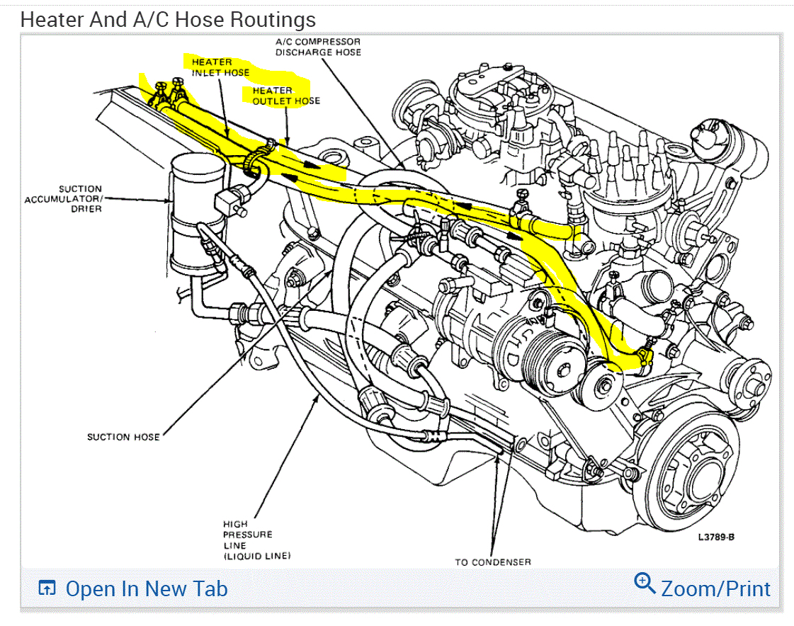

Do me a favor. Based on the location (under the vehicle), I need you to open the hood and inspect the heater core hoses. These hoses supply coolant to the heater core in the vehicle. They run between the engine and the firewall under the hood.
I attached a pic below and highlighted the two hoses. Check to see if they are leaking where they connect or at another location near the firewall.

Take care and let me know what you find.

Hello Joe, thank you again for your time and help. I took the vehicle to a mechanic recommended by the church I attend. He located where the coolant was leaking from, he pointed it out to me and I saw it seeping out from the throttle body. He sent me to get a throttle body. I went and was told at AutoZone it needed a throttle body gasket. I bought a gasket and went back to the mechanic. He said that it needs a new throttle body spacer. I have to special order it for about $100.00. I described all the symptoms I explained to you as well. The engine cutting out when parallel parking and shifting gears etc. I told him I thought it was the IAC, he said that it's the throttle body spacer. My question to you Joe is based on all the symptoms and in light of the coolant leaking out of the throttle body. Does this fix make sense to you? I just don't want to be told after I buy the spacer that I need a different component as well because there are about 8 different components just making up the throttle body.
Also, he does not have an obd1 device and came right out and said that he did not normally work on cars this old. However, when I drove up, he immediately began talking about Lincoln Grand Marquis which is the same Panther 5.0 v8 efi engine -lol.
Thanks for any insight you can add- hopefully this fix will make sense to you. Also, let me know please.

If there is a leak at the throttle body, certainly that can cause the issues. If he took the time to show you the leak, he sounds honest. That makes me feel better.
Regardless, yes it does make sense. Let me know how things turn out for you.
