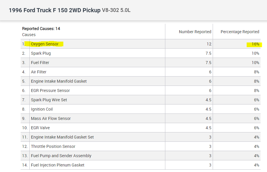

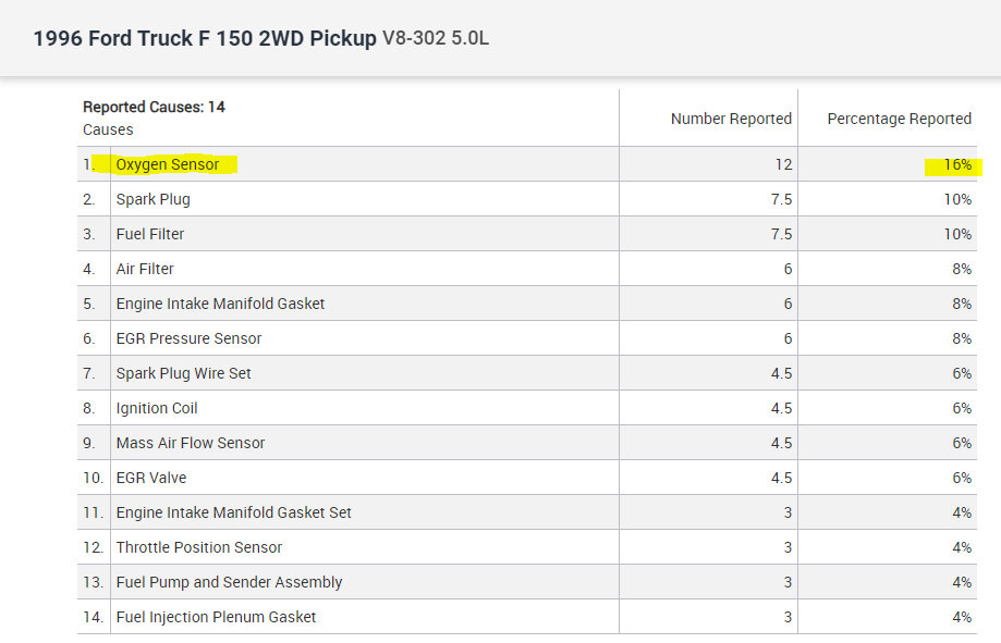

The code indicates a lean fuel mixture. If you have checked for vacuum leaks and are certain there are none, the next thing would be to check fuel pump pressure. Here is a link that explains how in general it's done:
I attached the fuel pressure specifications below (pic 1). Also, pic 2 shows the most common repairs for the code you have. It shows an O2 sensor.
Here is a link that explains how to test the sensor:
https://www.2carpros.com/articles/how-to-test-an-oxygen-sensor-02-sensor
This is where I would start. Let me know your thoughts.

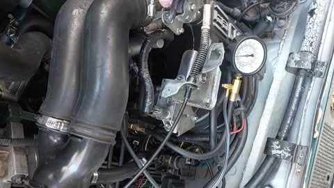

When I rev the motor the engine shakes badly I don't know what's going on.
Things I've changed/fixed.
Fuel pump : New
Fuel injectors : cleand not new
O2 Sensors : OLD
Engine mounts : New and Torqd
Vacuum Hoses : All checked no cracks or leaks that I can see
Fuel : New NOT old
Fuel Regulator : New
Fuel Pressure : 35 psi was 15 replaced fuel pump with New one
Gaskets : all new intake/lower intake/heads/exhaust so on
i did Lap the valves and check for leaks with water and a oil test No Leaks I have NOT checked compression yet after new fuel pump I could check that any help would be amazing thank you. Also here is a video to show.

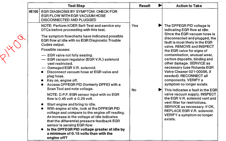

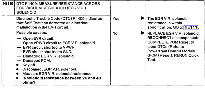

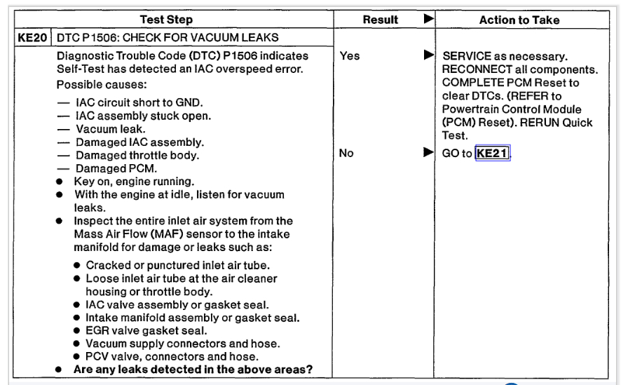

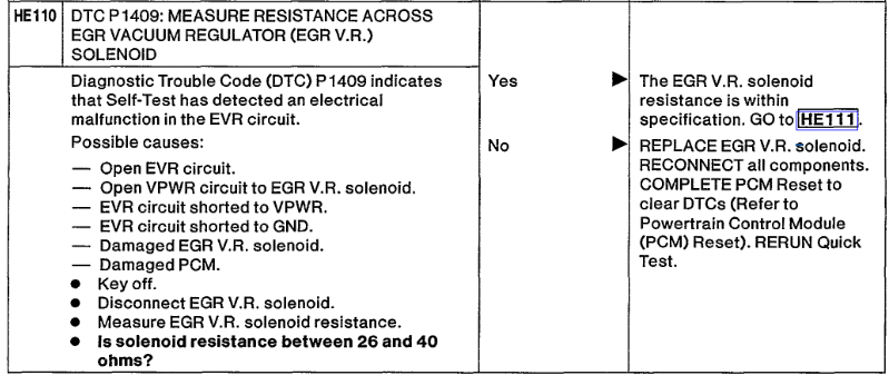

The P1506 is likely an air leak. Recheck connections and hoses around the IAC. (See pic 1 below)
The P1409 is related to the EGR. Take a look at pics 2 and 3 and let me know if these are things you have already checked. If they are, let me know so I can move on to the next set of diagnostics.

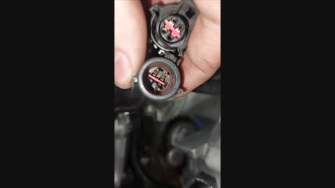

Okay, I checked all my electrical wiring except for fuel injectors but everything else ive checkd all reciving power no shorts checkd all fuses all checkd out inside and inside cab fuses all good I did find that 2 vacuum lines were backwords the TAD and TAB behind the block I switchd them so thats good now and I checkd the purge valve solenoid that is bad and also found that the TPS sensor plugs are bad there is 1 prong missing in both made video and will do check list to recap thanks again for your help.
IAC circut short to ground - good
IAC assembly stuck open - no
DAMAGED IAC assembly - no brand new
vacuum leaks - yes TAD and TAB were backwords switchd and fixd
damaged PCM - no
damaged throttle body - no
inlet air system cuts/leaks - no
any gaskets cuts damaged or leaking - no all new
PCV valve cracked or leak - no
Are any leaks detected in the above areas KE20 DTCP 1506 - TAD TAB switchd fixd everything else solid and good.
HE110 DTC 1409
all circuits checked except for fuel injector wiring.
IAC valve - solid
purge valve - solid
egr solenoid - solid
TPS sensor - damaged to my opionon video linked didnt bother checking missing prong
ac/heat blower - solid
wipers - solid
MASS AIR - checkd
mass air reader - checkd
coolant/oil sensors - checkd
ignition coil - check
solenoid resistant to purge was over 26-40 ohms so
HE100 EGR
EGR - brand new
Egr hoses - check no leaks
egr fully seated - check solid
egr gasket - new and solid
DPFE - not sure about has power to it but unsure of unit itself if its working or not
thats my check list so recap all wires are solid reciving power except for tps sensor in my opinon unsure TAD TAB vacuum switchd and fixd the purge valve solenoid is bad checkd everything else solid and havent turnd truck on after checking all this waiting for reply take care and thanks again for all your help

The connectors only have three of the four pins used. There should only be three wires on each side.
