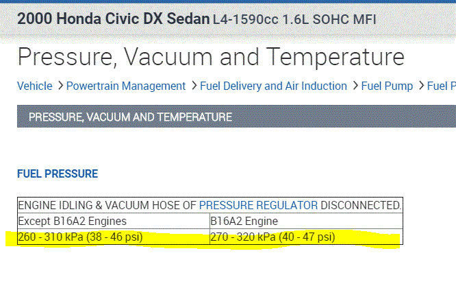

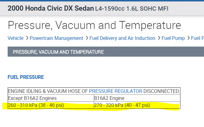

I attached the specs in the attached pic. Note there are two engine possibilities. I can help you determine which one you have. I will need to know the 8th digit from the left of the VIN number. That is the serial number of the vehicle.

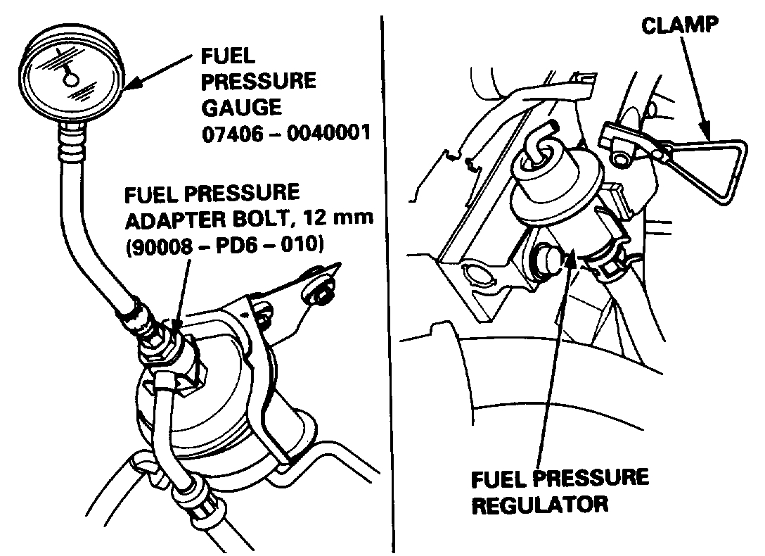

At this point, I feel it is a fuel pressure related issue. The only way to confirm I'm correct is to check fuel pressure after the vehicle sits and would normally have the issue. Here is a link that shows in general how it's done:
Here are the directions specific to your vehicle. You will need a fuel pressure gauge, but most parts stores will lend or rent one to you.

1. Relieve fuel pressure.
pic 1
2. Remove the 12 mm banjo bolt from the fuel filter while holding the fuel filter with another wrench. Attach the special tools.
3. Start the engine. Measure the fuel pressure with the engine idling and the vacuum hose of the fuel pressure regulator disconnected from the fuel pressure regulator and pinched. If the engine will not start, turn the ignition switch ON (II), wait for two seconds, turn it off, then back on again and read the fuel pressure.
Pressure should be: except B16A2 engine:
260 - 310 kPa (2.7 - 3.2 kg/Sq.cm, 38 - 46 psi)
B16A2 engine: 270 - 320 kPa (2.8 - 3.3 kg/Sq.cm, 40 - 47 psi)
4. Reconnect vacuum hose to the fuel pressure regulator.
200-250 kPa (2.0 - 2.5 kg/Sq.cm, 28 - 36 psi)
B16A2 engine: 210 - 260 kPa (2.1 - 2.6 kg/Sq.cm, 30 - 37 psi)
If the fuel pressure is not as specified, first check the fuel pump. If the fuel pump is OK, check the following:
- If the fuel pressure is higher than specified, inspect for:
- Pinched or clogged fuel return hose or line.
- Faulty fuel pressure regulator.
- If the fuel pressure is lower than specified, inspect for:
- Clogged fuel filter.
- Fuel line leakage.
