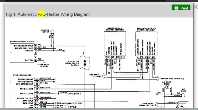

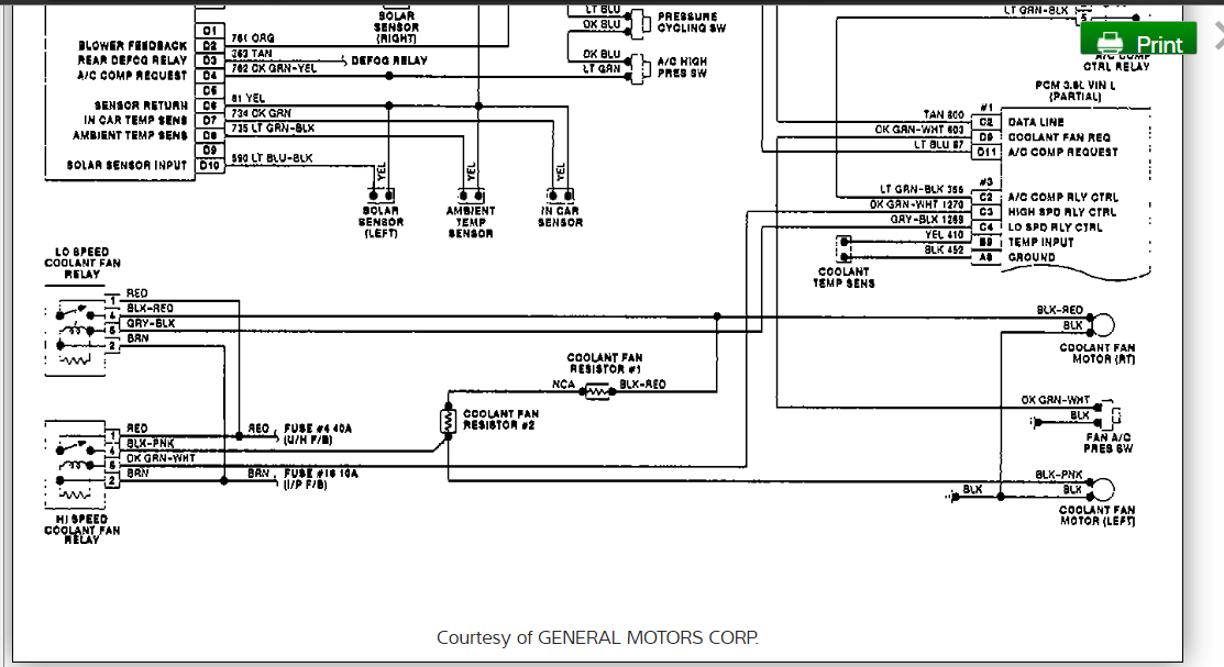

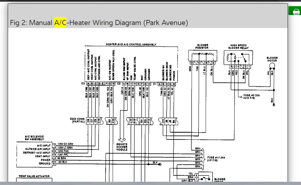

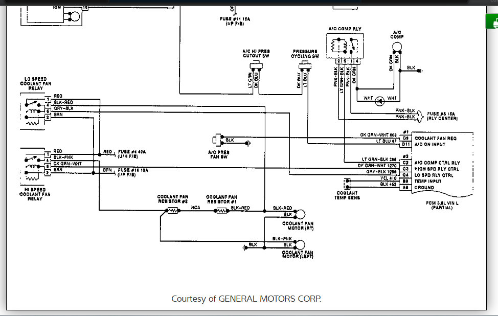

I have included the wiring diagrams for your vehicle's HVAC system in the diagrams down below. This is the only information I could pull up in my two reference sources for it. Please go over them and get back to us with what you are able to find out.
