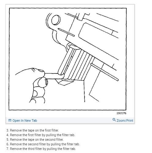

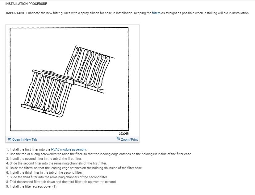

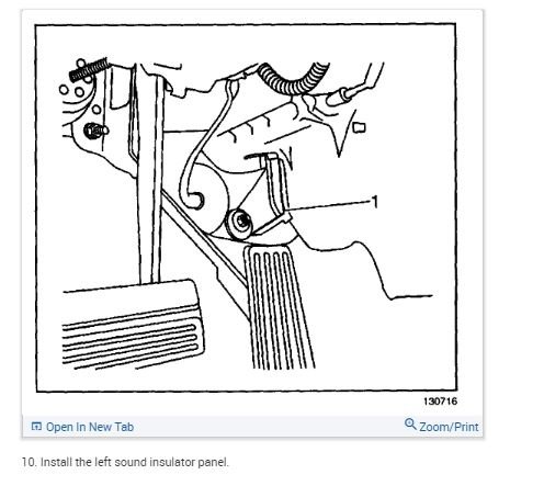

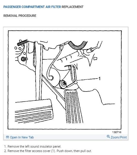

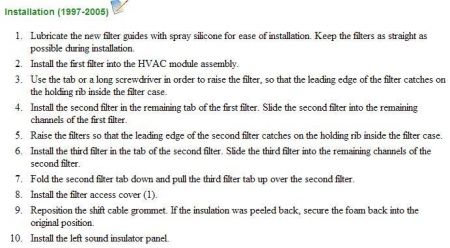

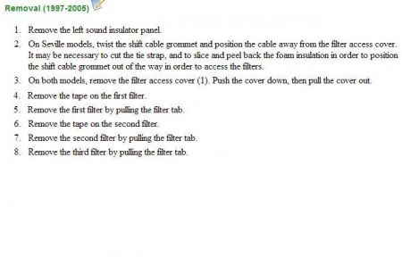

Does my car have a Cabin Air filter and if so can I change it myself?
Wednesday, May 12th, 2010 AT 1:44 PM
5 Replies
BLUELIGHTNIN6
MECHANIC
16,542 POSTS
Yes, you vehicle has a cabin filter
See the diagrams below for pictures/instructions on how to change it

How do I change the cabin air filter?

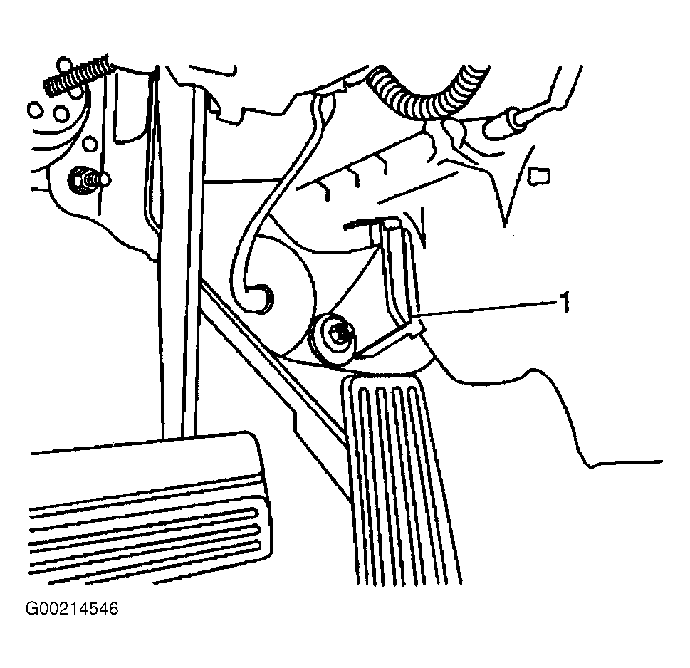

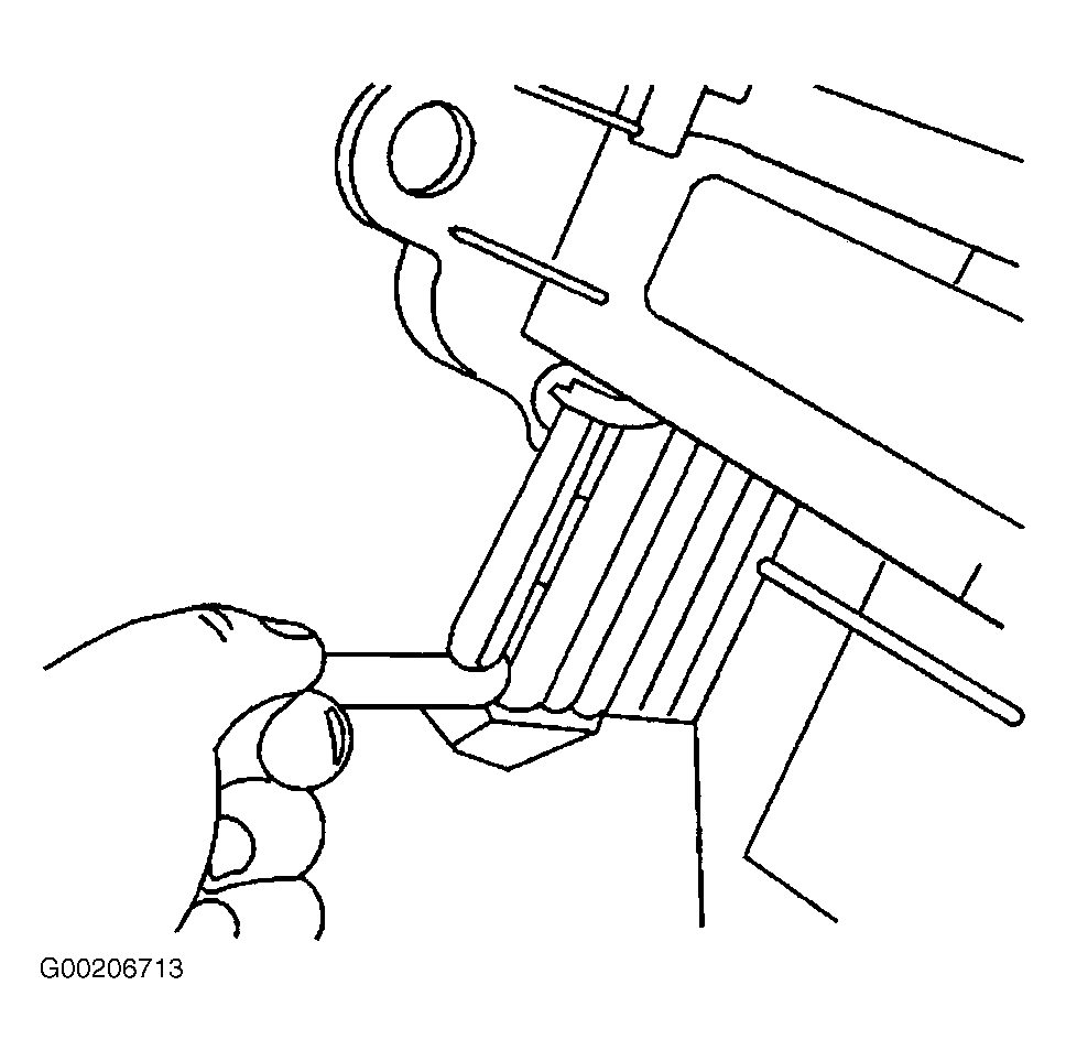

Cabin air filter replacement on a 1998 Buick park avenue Ultra?
Friday, October 26th, 2018 AT 6:42 PM (Merged)
DOCFIXIT
MECHANIC
18,828 POSTS
Removeleft spound insulator remove bolt for cover see diagrams
