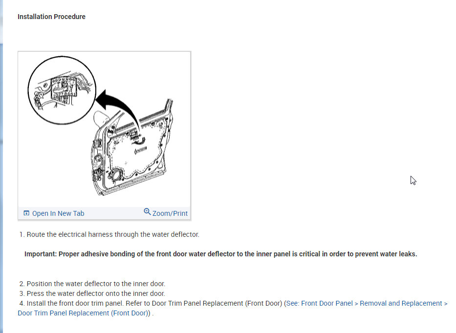

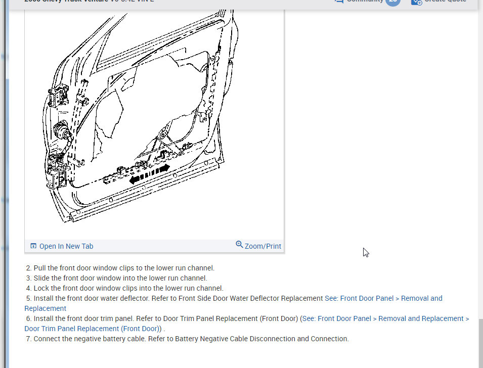

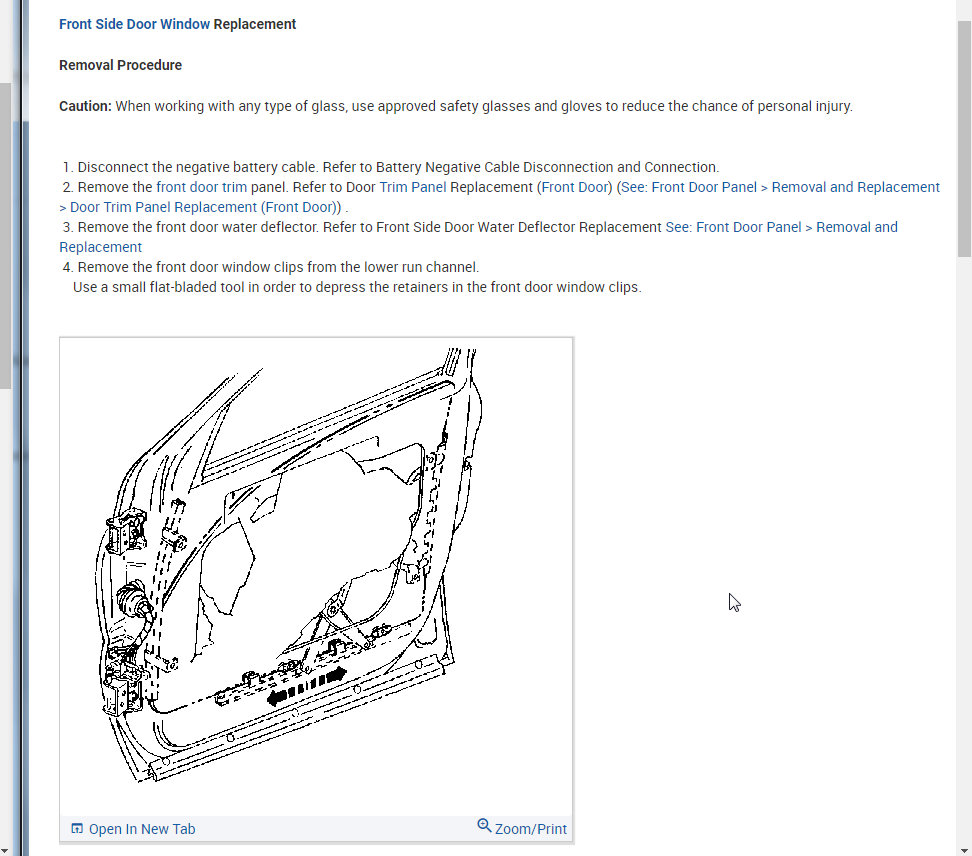

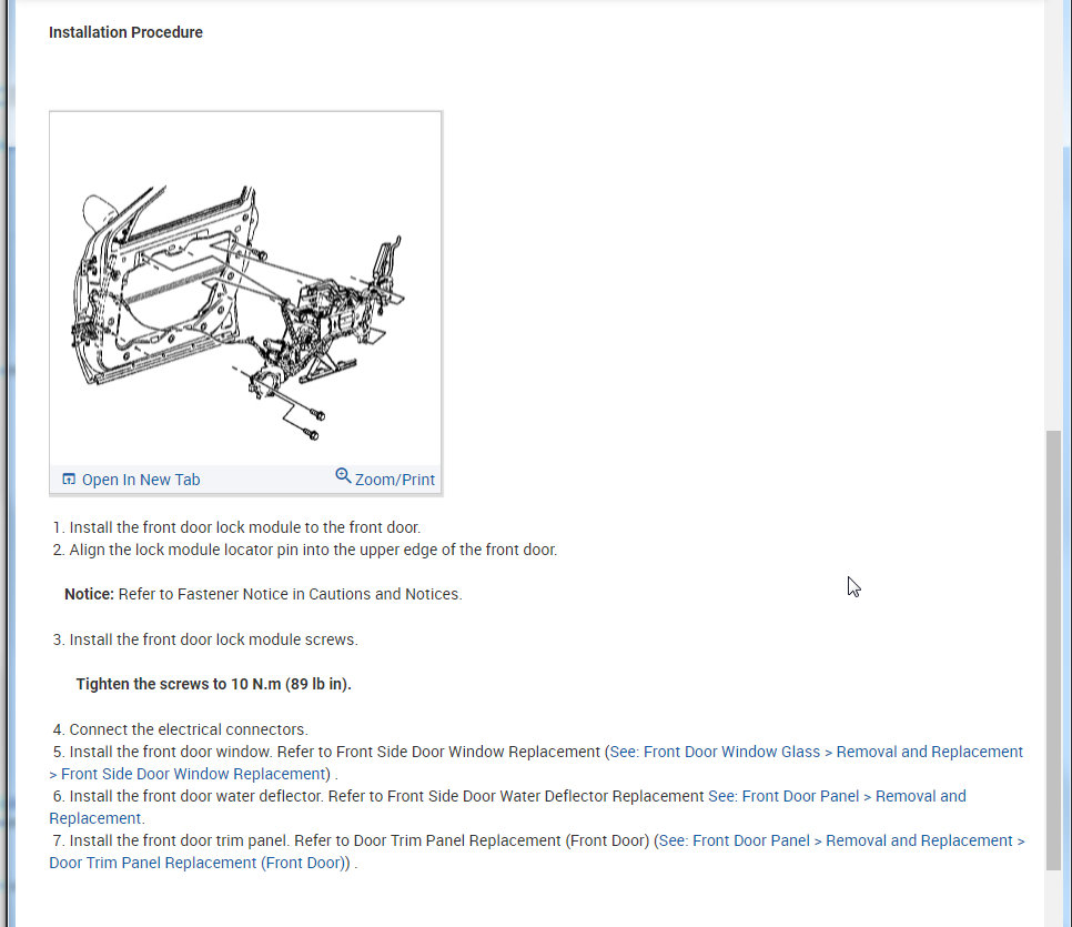

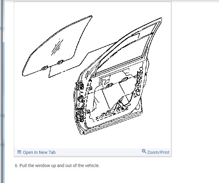

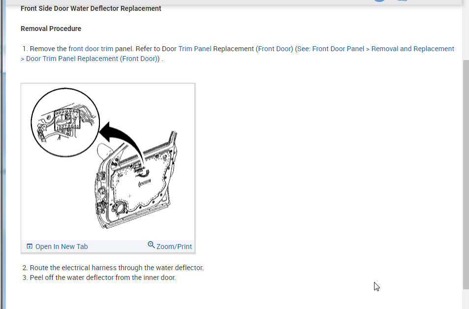

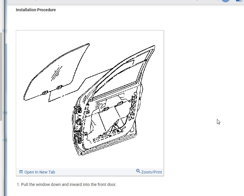

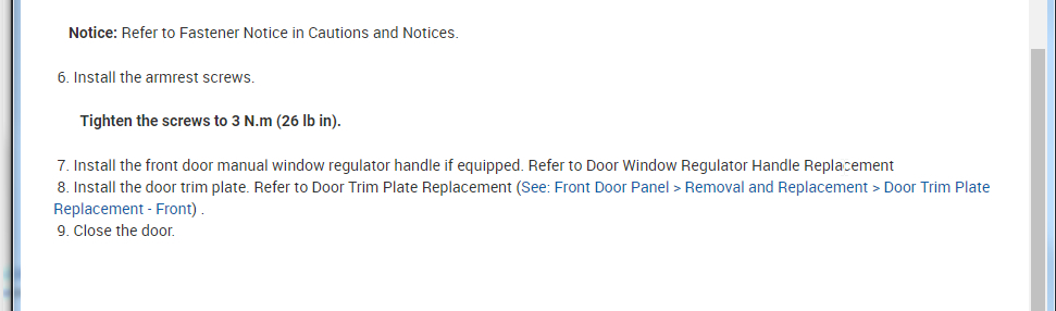

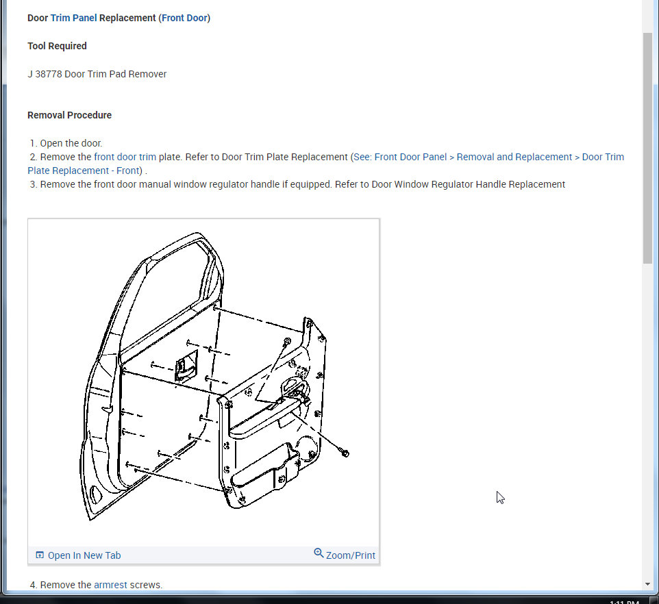

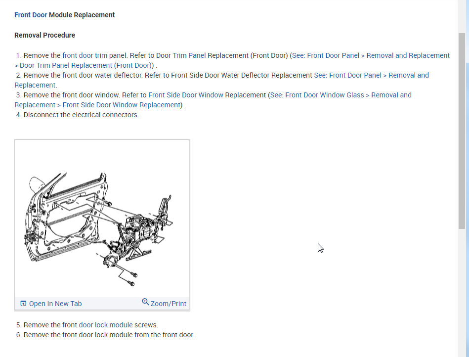

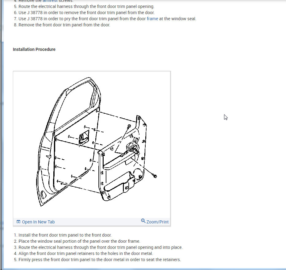

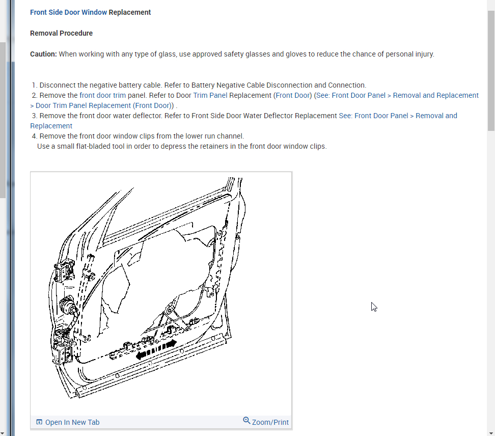

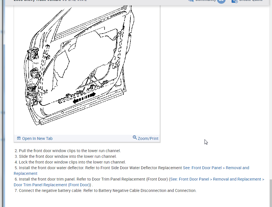

Bent regulator.
Tuesday, May 18th, 2021 AT 11:14 PM
MECHANIC
18,907 POSTS
Clearly you are going to need to remove the door panel so here is a guide that will help with this and the repair:
https://www.2carpros.com/articles/door-panel-removal
https://www.2carpros.com/articles/how-to-check-and-replace-a-electric-power-window-motor
Below is the entire process from the manual on how to replace this. Please let us know if you need other info. Thanks
