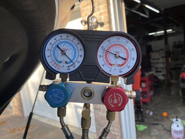

I am trying to charge it because I think it's a bit low. High side when pressing with a screwdriver shows there is Freon. It was cooling low and now not at all. I want to make sure the compressor licks in and then I want to charge it but I cannot while the compressor is not running. Where is the relay and which pins do I jump for a little bit to get it going?

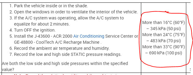

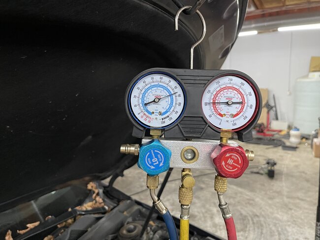

And I don't know if these numbers are accurate, this is with engine running, compressor off of course.
Thursday, September 7th, 2023 AT 3:27 PM
  • 110,194 POSTS
If the pressure readings in the pic are static pressures, that seems high. Keep in mind, that the pressures can be different based on ambient temperature when checked.
However, if the pic above shows static pressure, that is a bit high. If it is accurate, the system is overcharged. See pic 2 below for acceptable static pressures based on ambient temperatures.

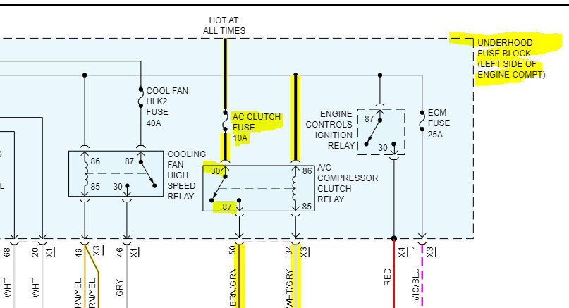

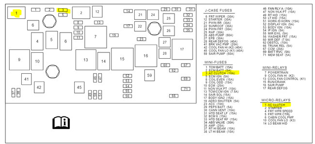

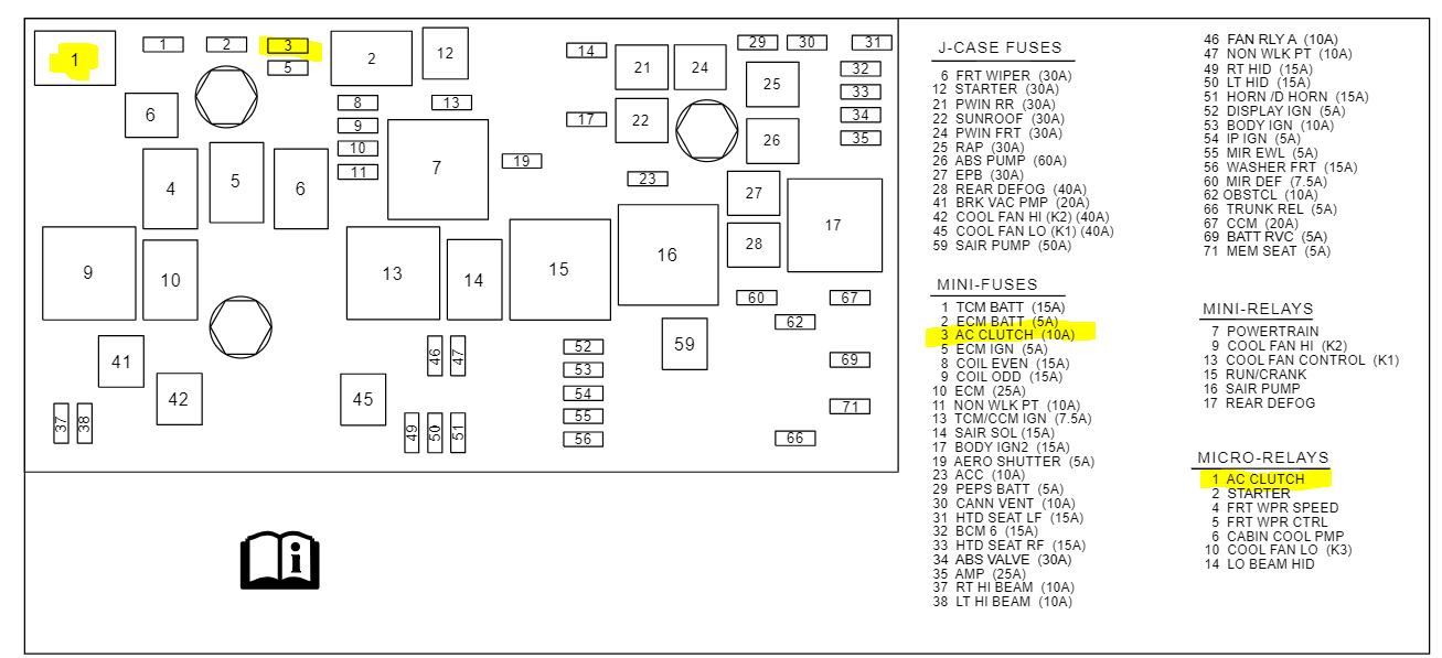

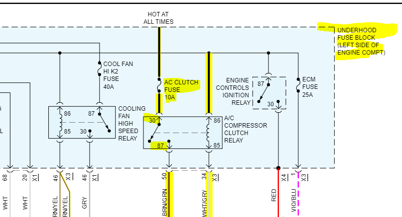

As far as the relay, it is in the under-hood fuse box. Remove the relay and inspect it. Each of the four pins will have a number. The numbers are 85, 86, 87, and 30.
You need to locate pins 87 and 30 and where they connect in the box. Those are the two pins that will send power to the compressor (if power is available).
Pin 30 receives power from the compressor clutch 10 amp fuse. So, before jumping it, check that connector to see if there is power. It should be present at all times.
Keep in mind, based on the provided readings, the system may be over-charged. Pay attention to the pressure readings. You don't want a compressor to fail or a hose. Actually, you don't want anything to fail due to high pressure.
Let me know what you find. Also, here is a link you may find helpful for testing the relay and relay circuit:

Yes, I thought about that, but the compressor is not running, so the readings is high even though the compressor isn'tt running?
Thursday, September 7th, 2023 AT 7:01 PM
  • 110,194 POSTS
That is my concern. When I say static pressure, it refers to the system at rest long enough for the pressures to equalize. You're are high. If you noticed, above 100 degrees the list indicates 100 psi as expected. You are well above that. I just don't want you getting hurt if something let's go. What I would recommend is to evacuate the system and then recharge it.

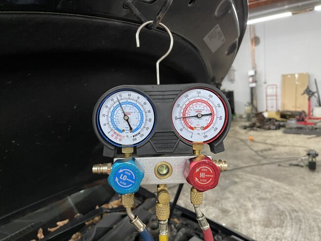

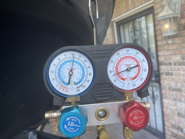

Both gauges open and then a bit after charging. The pipes are a bit cold. The vent air is not hot, it's cool, maybe 2-3/10. Fans running.
Saturday, September 9th, 2023 AT 7:23 AM
  • 110,194 POSTS
Are both pics with it off? If so, what is the pressure with the system running? Let me know. The pressures have equalized, but they are different readings. That is why I'm asking if pic 2 was with it running.

Both running.
Sunday, September 10th, 2023 AT 5:10 AM
BHAMDOC1973
  • 2,018 POSTS

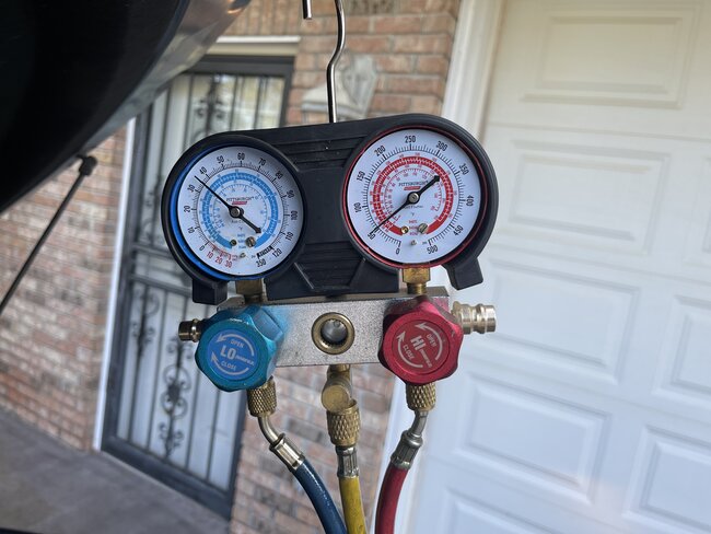

First pic before opening the gauges, car running A/C on.
Second, same situation but gauges open.
Sunday, September 10th, 2023 AT 1:11 PM
  • 110,194 POSTS
Thanks for the information. Based on the readings, I suspect the compressor itself has failed. The low side pressure should never get that high and the high side doesn't change. Other than the compressor, the expansion valve could be plugged. Something is backing up pressure on the low side.
Have you replaced the expansion valve? If so, then my first suspect is the compressor. This can happen with a faulty compressor because the compressor is not creating enough suction to draw in refrigerant effectively.

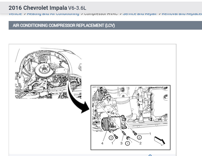

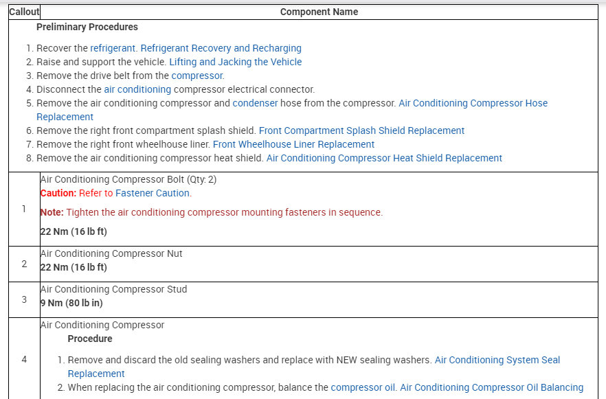

Thanks for the update. I just wish it was better news. If you plan to replace the compressor yourself, here is a link that explains in general how it's done:
https://www.2carpros.com/articles/replace-air-conditioner-compressor
If you look below, I attached the directions specific to your vehicle. Note: There are two different designs that were used. I picked the one that should be on your vehicle. If the compressor mount looks different, let me know.
