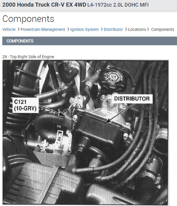

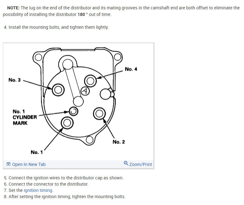

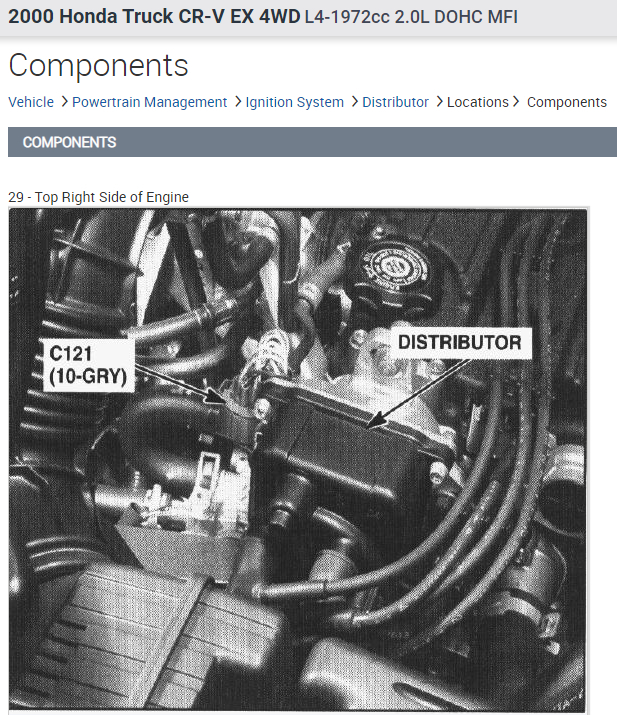

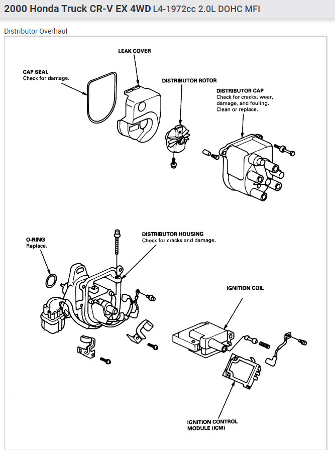

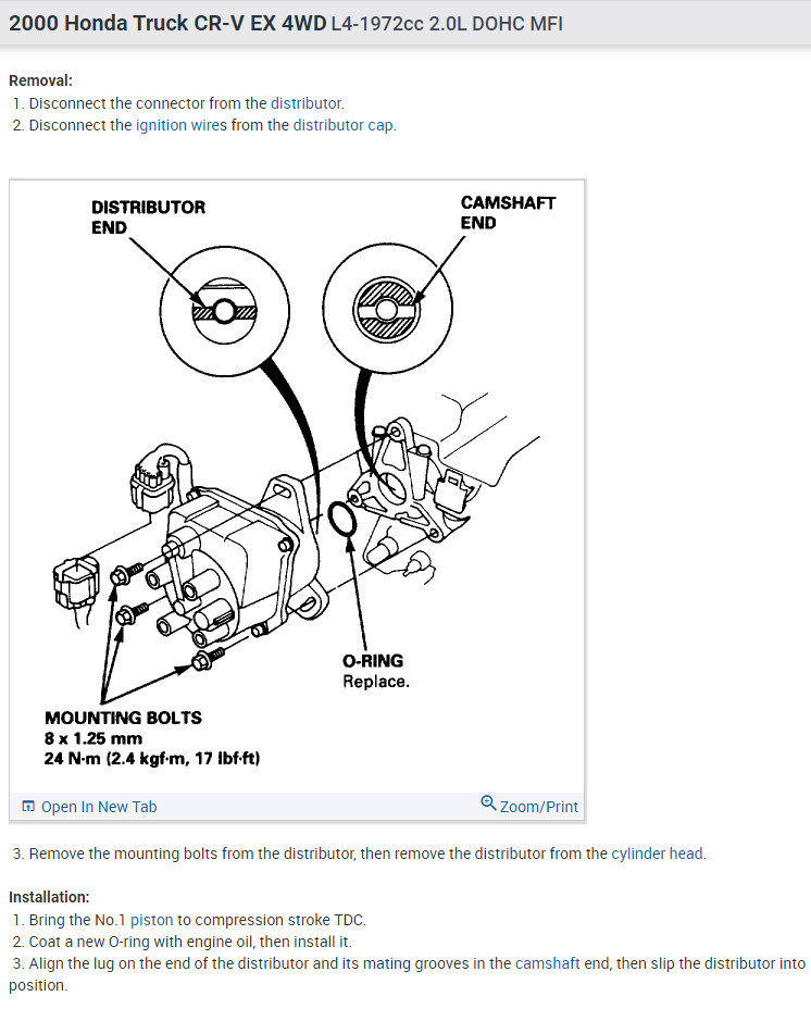

I have attached the distributor diagrams for any one else that might come across the same issue.
