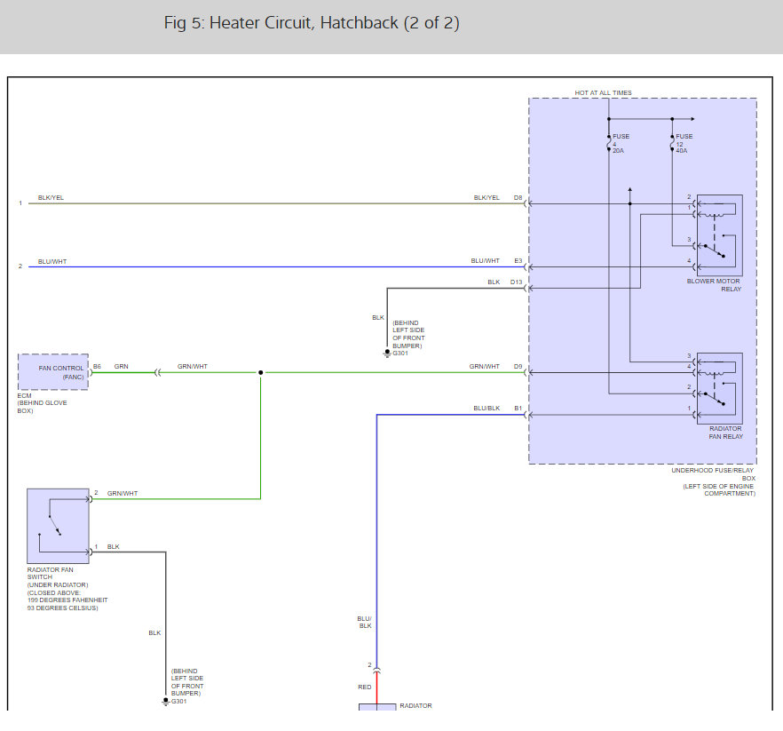

My Air conditioning system feels cool but not up to it capacity, when I open the bonnet and start the AC I can see and feel it starts and stop. This happend continuesly.
I also checked with a AC tester, when the AC is on on the Lower side goes up to 60 and higher side come up to 50and stays on
can anyone help me pls?

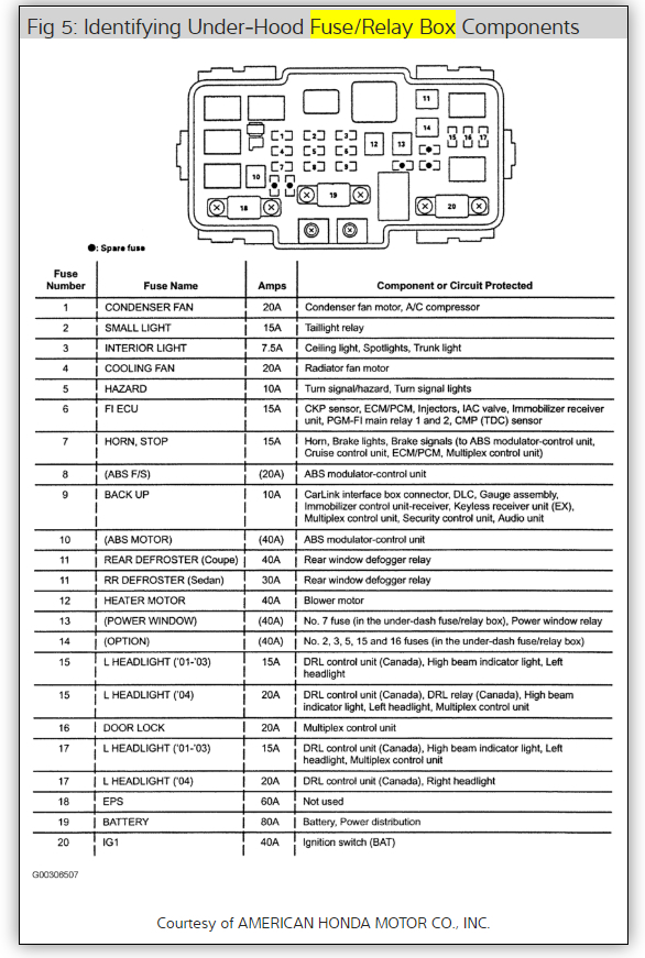

KHLOW2008
  • 41,815 POSTS

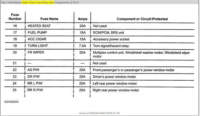

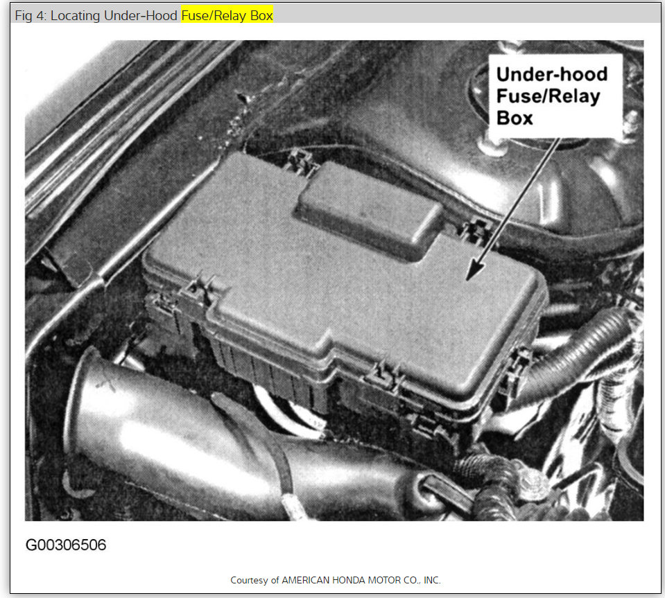

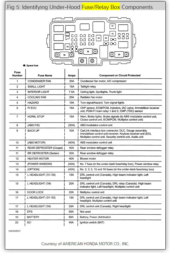

It would more likely be a fuse problem since so many items failed at the same time.
Check the underhood fuses.

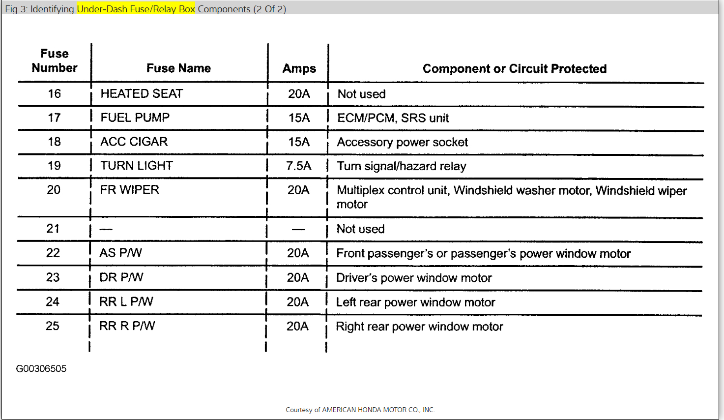

KHLOW2008
  • 41,815 POSTS

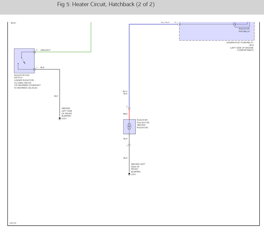

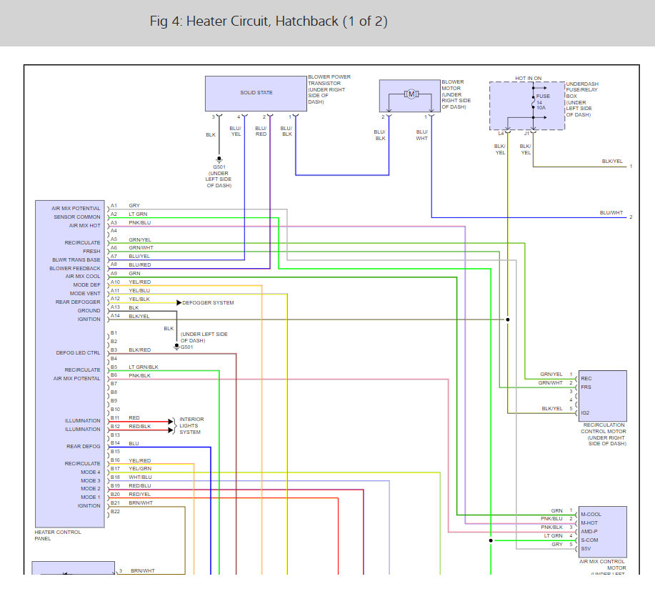

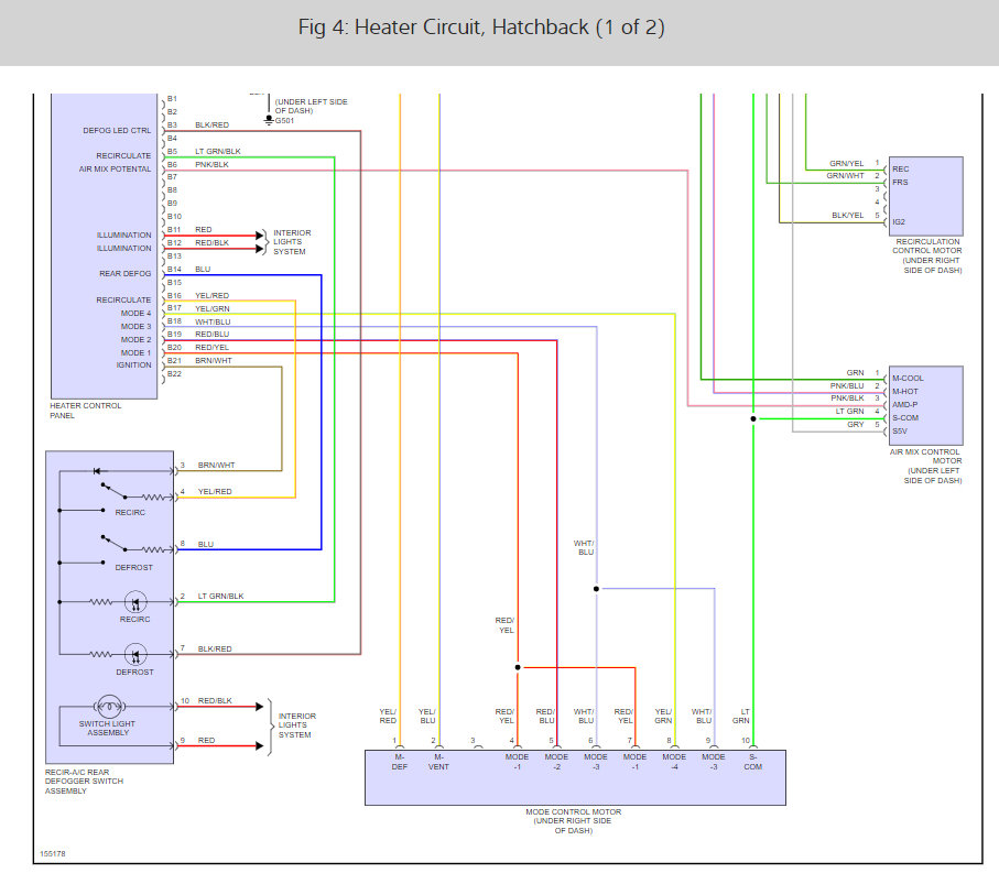

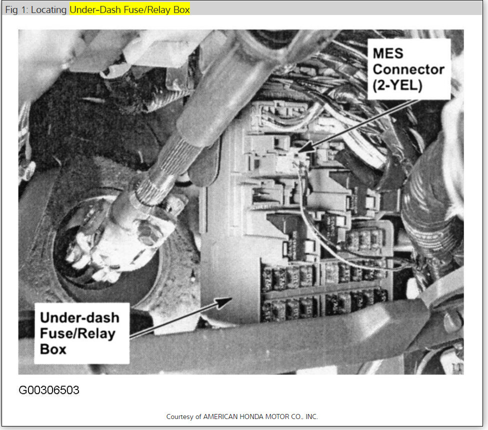

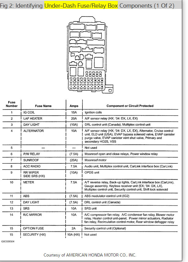

Here are the schematics for the AC. Check through them for fuses and relay. Here is a guide to help you test the relay and wiring diagrams to help you see how the system works.
Check out the diagrams (Below). Please let us know what you find.
Cheers

KHLOW2008
  • 41,815 POSTS
The high side should be operating at between 180 to 250 and I am surprised it is showing 50.
The low side should be around 30.
When compressor has been stopped for a while, both readings should read at abut 90. Please recheck the pressure reading.
