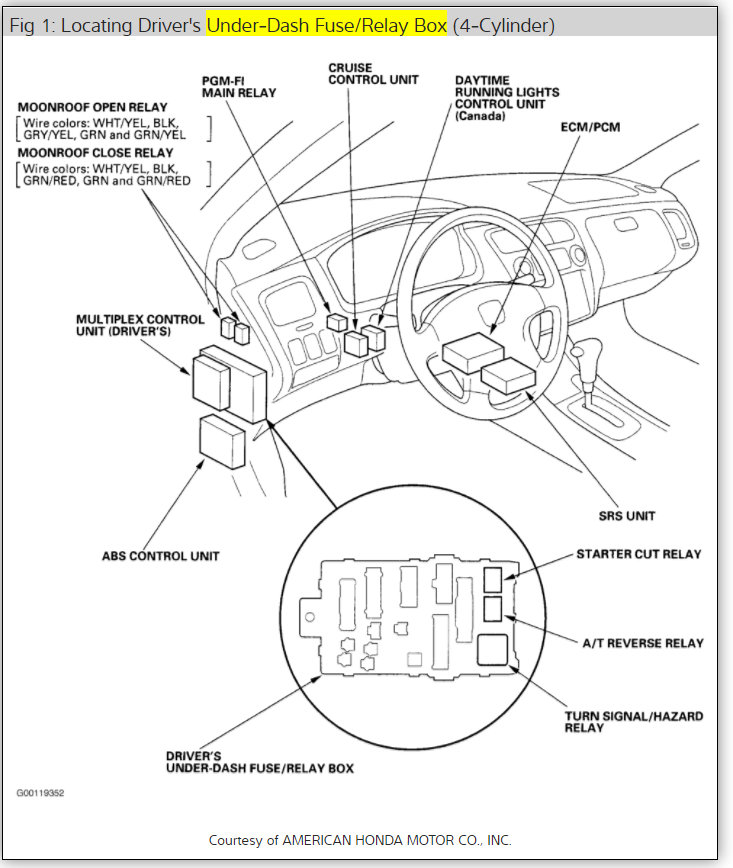

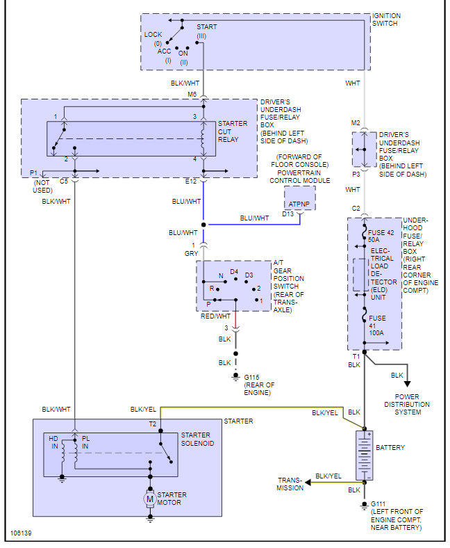

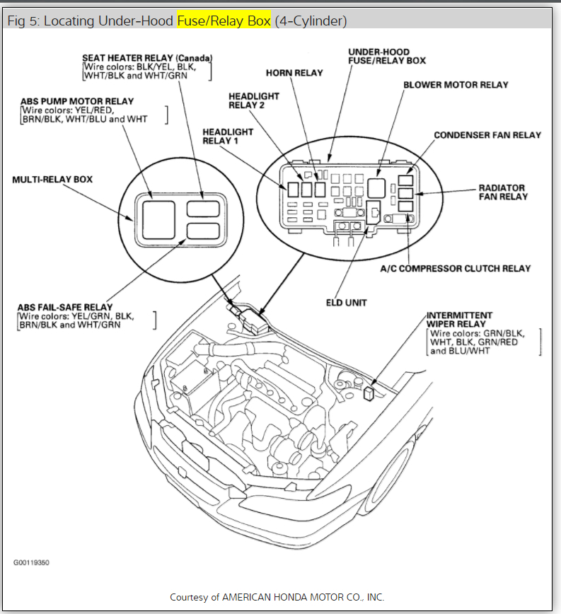

SCGRANTURISMO
  • 4,897 POSTS

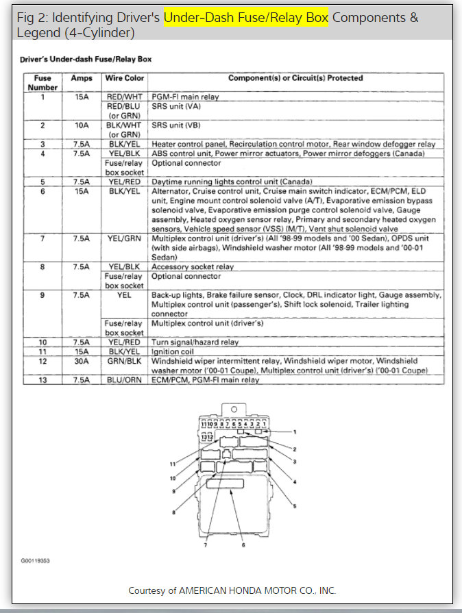

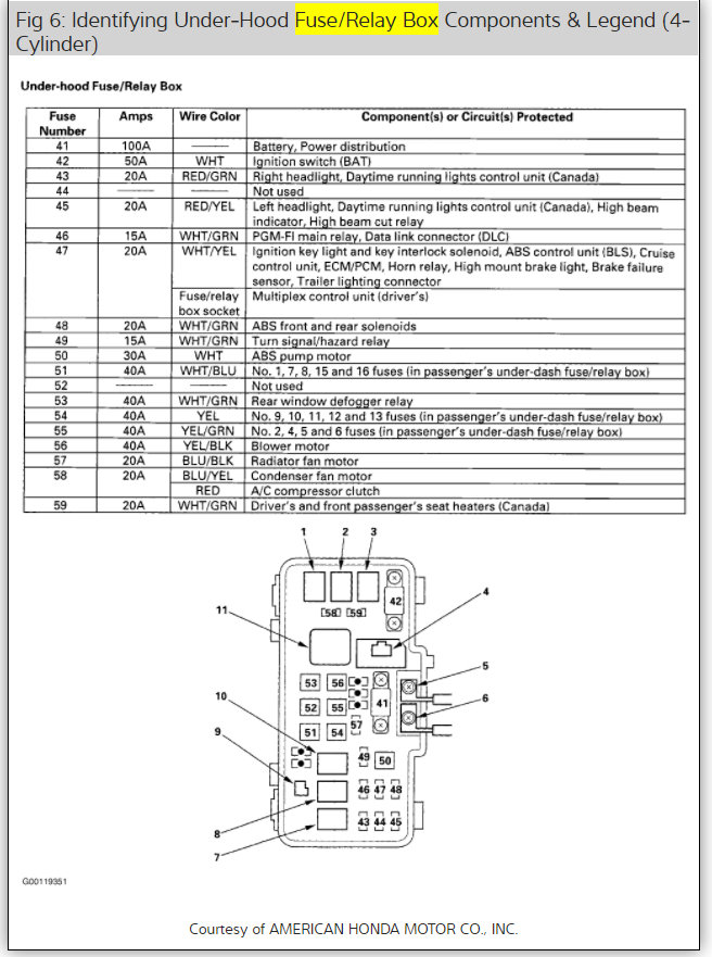

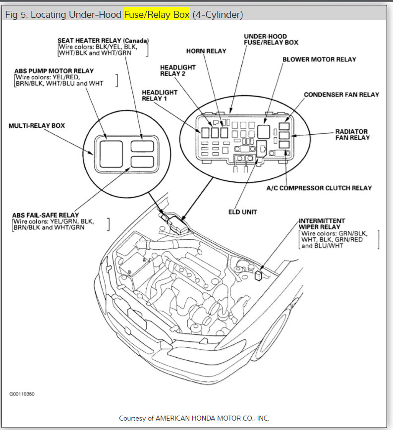

Hi my is Alex and I will be helping you today. Try looking at fuse #42 in the underhood fuse/relay box. It is located in the right rear of the engine compartment. I have included a wiring diagram, circling the fuse for you, also. Hope this helps, and feel free to get back to me with any other questions or concerns, and we will go from there. Thanks.
Saturday, October 3rd, 2020 AT 9:58 AM (Merged)
KEN L
  • MASTER CERTIFIED MECHANIC
  • 55,350 POSTS
Here is a guide to help you check the fuses and the fuse locations as well:
