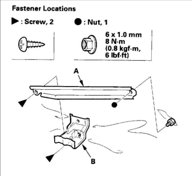

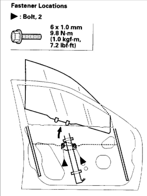

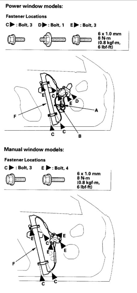

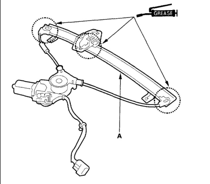

My car is the two door model. The driver's side window just started chattering at the top of its travel and will not close completely. So rain, cold air and wind noise are a problem. The window has to be manually pulled into the correct "up", and completely closed, position. Very annoying! Is there a limit switch somewhere that might be failing? If so, is this an easy fix or do a have to replace the entire power window mechanism and drive motor? Please advise and thanks!

You will have to pull the door trim off and inspect the regulator, the teeth on the driven arm may be worn away and the chattering is the drive gear skipping, if so a replacement regulator is required.

If I am add here is a guide that will give you an idea of what you are in for when doing the job.
https://www.2carpros.com/articles/how-to-check-and-replace-a-electric-power-window-motor
Here is a guide on how to remove the door panel
https://www.2carpros.com/articles/door-panel-removal
and here are some diagrams on how to do the job on your car (below)
