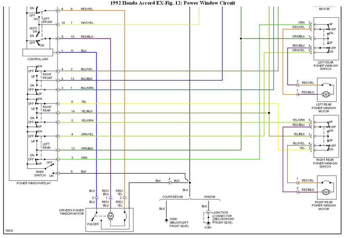

Check out the diagrams (Below). Please run this test and get back to us.

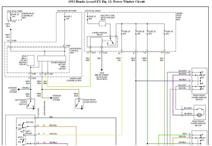

I have a 92 honda accord and all 4 windows stop working
Oct 16, 2020 at 10:59 AM (Merged)
KHLOW2008
  • CAR REPAIR CONTRIBUTOR
  • 41,814 POSTS
Have you checked the fuses underhood?
PEREZ Y
yes the fuse and relay underhood
KHLOW2008
  • 41,814 POSTS

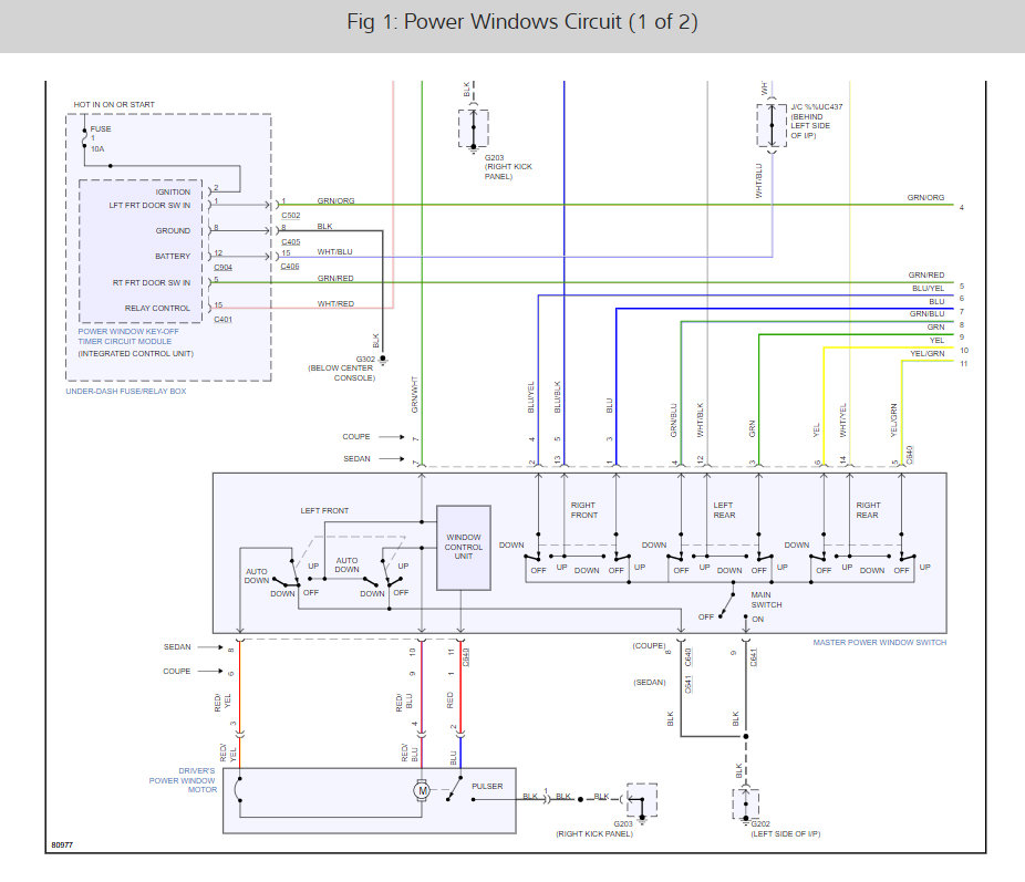

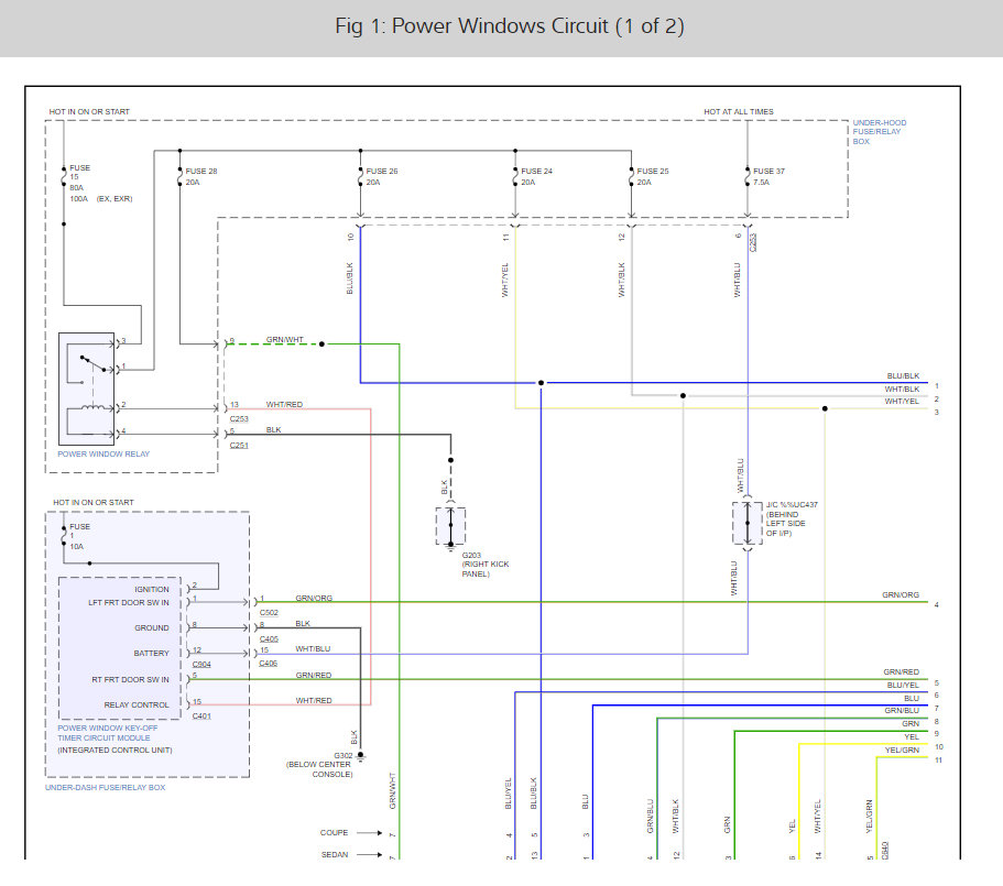

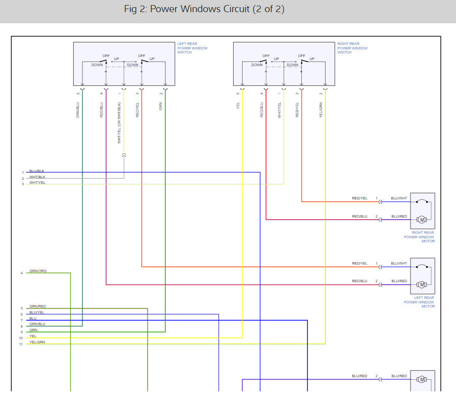

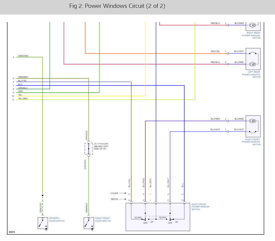

Here are the schematic of the system.
Check the power window relay. Use a test lamp to test the power window fuses for battery voltage.

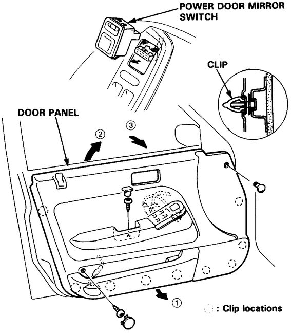

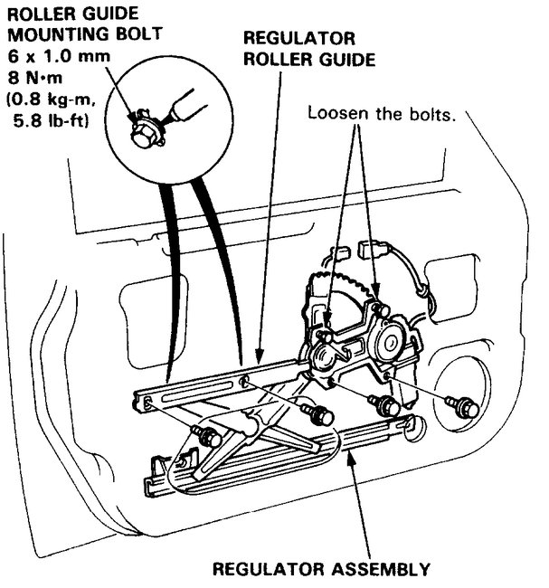

  • 110,190 POSTS
It sounds like the gears on the regulator have stripped. Take a look at picture 1. You will see a set of gears. You need to remove the door panel and inspect those to see if that is what has been damaged. Also, one the panel is removed, if you crank the window up and assist the glass upward with the other hand, at least you can close it until you repair it.

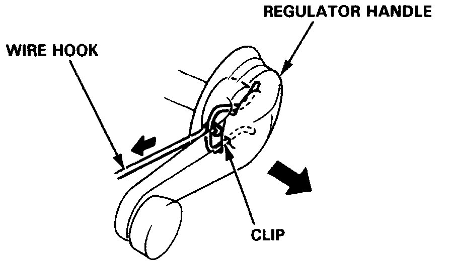

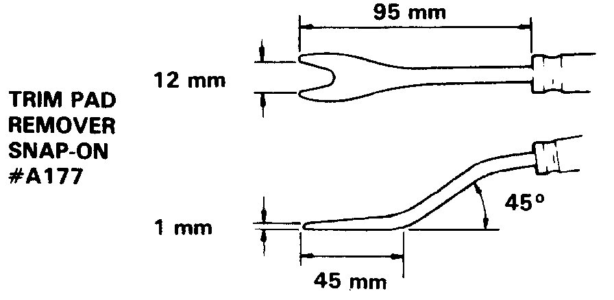

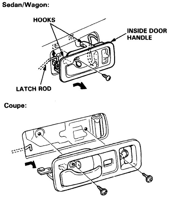

The directions I have for removing the door panel are for either manual windows or electric. If there are electrical components in the directions that you do not have, ignore them.
__________________________
Starting with picture 2, the remaining pics correlate with these directions.
Disassembly
Sedan/Wagon Front/Coupe:
1. If applicable, remove the regulator handle by pulling the clip out with a wire hook.
2. Remove the mounting screw, then pull the inside door handle out half-way and disconnect the latch rod and power door lock connector.
NOTE: Remove the panel with a little bending as possible to avoid creasing or breaking it.
3. Remove the power door mirror switch and disconnect the connector.
4. Remove the screws and clips (see trim pad remover) attaching the door panel. Remove the door panel by pulling it upward and disconnect the power window and courtesy light harnesses.
I based this diagnosis on the windows being manual and not power because you said when you roll them up. Let me know if this helps, if you have other questions, or need additional information.
