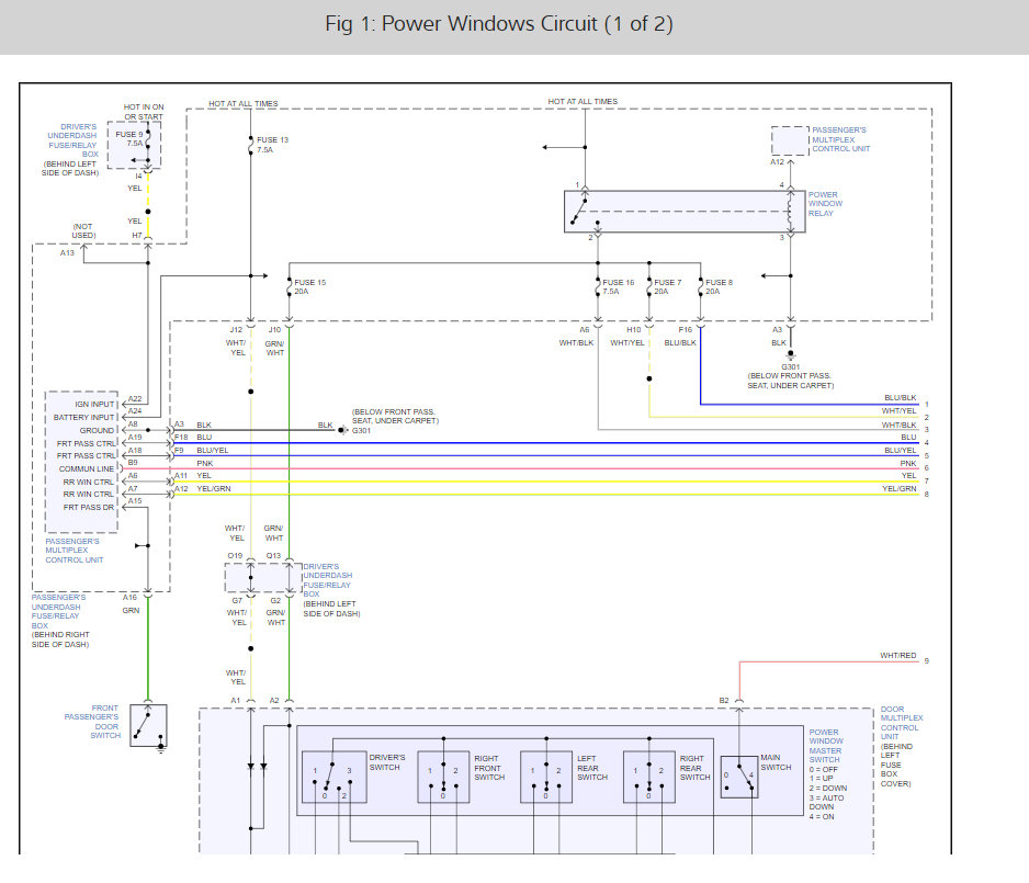

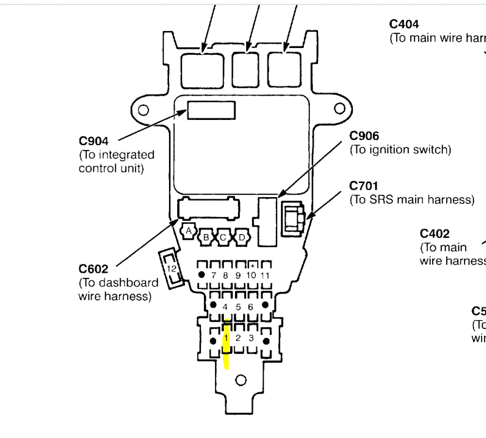

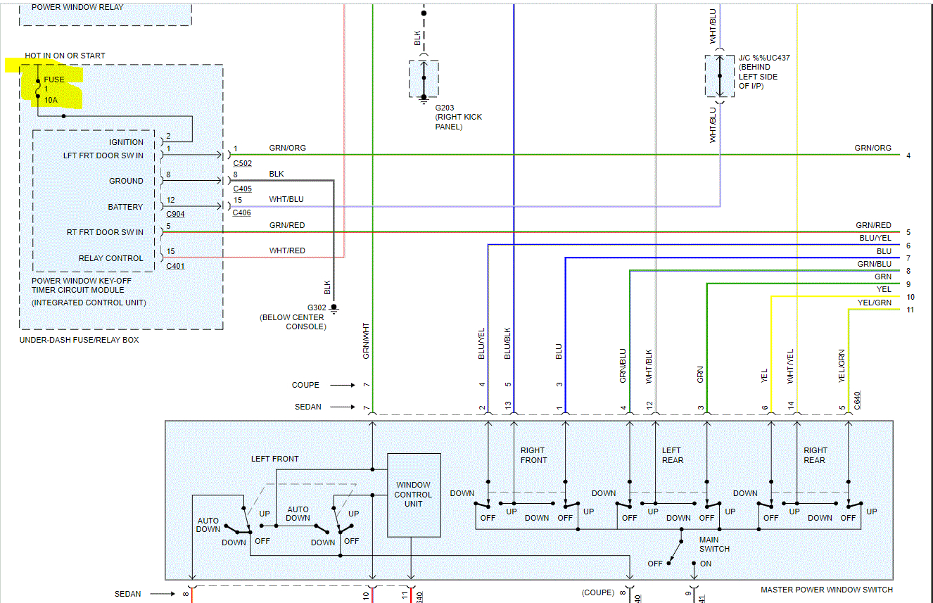

  • CAR REPAIR CONTRIBUTOR
  • 110,190 POSTS
I noticed this is quite old. However, here is a link you may find helpful. It explains how to both check a fuse and confirm there is power to the fuse:
Also, there are a few fuses that can cause an issue along with a relay. Start by checking fuse 1 in the fuse box under the dash. See pics 1 and 2 for schematic and location.
Let me know if this helps.
