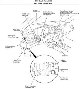

KHLOW2008
  • 41,814 POSTS
Hi mindyc,
Not the EGR valve. I would suggest checking the PGM-FI main relay.
https://www.2carpros.com/forum/automotive_pictures/192750_PGMFIRelay99Accordpix_1.jpg
