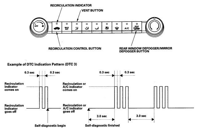

Something has come apart. If you have full air flow and control over the mode door, something isn't allowing the heat to enter. There is only one heater core. If you have heat on one and not the others, it's not a core issue. You have replaced the air temp actuator. I have one more suggestion. Try this self diagnostic test and see if any codes show up.
_______________________________
2008 Honda Accord V6-3.5L
Heating/Air Conditioning
Vehicle Heating and Air Conditioning Testing and Inspection Reading and Clearing Diagnostic Trouble Codes Heating/Air Conditioning
HEATING/AIR CONDITIONING
General Troubleshooting Information
How to Use the Self-diagnostic Function
The HVAC control unit has a self-diagnostic function for heating, ventilation, and air conditioning system. To run the self-diagnostic function, do the following:
1. Turn the ignition switch to LOCK (0) and then to ON (II).
2. Set the FAN CONTROL dial to OFF, the TEMPERATURE CONTROL dial on Max Cool, and select the VENT mode.
3. Turn the ignition switch to LOCK (0) and then to ON (II).
4. Press and hold the RECIRCULATION CONTROL button, then within 10 seconds press and release the REAR WINDOW DEFOGGER/MIRROR DEFOGGER button five times. Release the RECIRCULATION CONTROL button; the recirculation indicator blinks two times, then the self-diagnostic begins.
NOTE:
- The blower motor will run at various speeds when in the self-diagnostic mode.

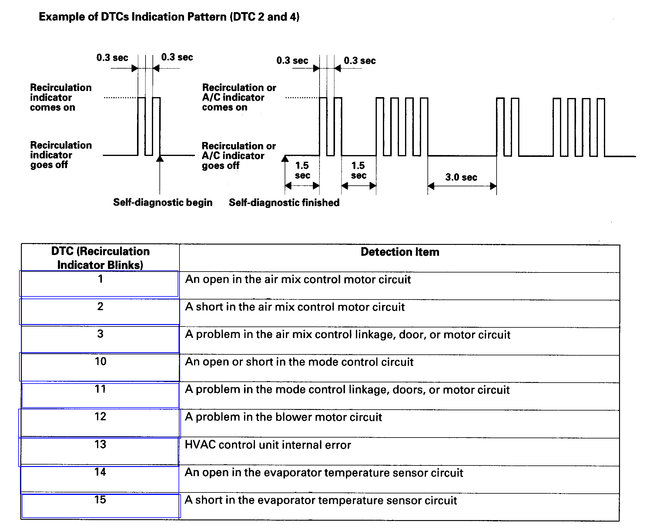

- If there is any problem in the system after the self-diagnostic function is finished, the recirculation indicator blinks Diagnostic Trouble Code (DTC) 1 through 15. In the case of multiple problems, the recirculation indicator blinks in order with the lowest number DTC repeatedly.
- If no DTCs are found, the indicator does not blink.
Pic 1
1 - 15
pic 2
Clear the DTCs
When the problem is repaired, DTCs will automatically clear.

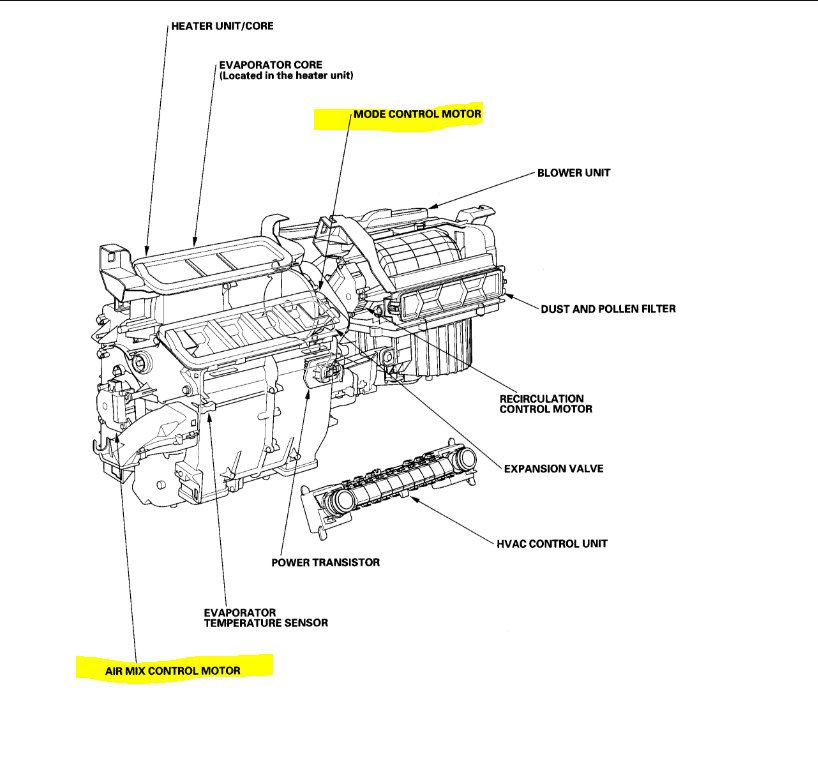

If you had 92 degrees at one point, something is going on in the HVAC box. I want to say mode actuator, but at this point, I would have to remove the assembly and check to see if something is broken, disconnected, not getting power and so on.
Take a look at the pic I attached. It shows both actuators that have been in question. One is the mode door actuator which directs air flow direction. The other is the air temp actuator. At this point, I hate to ask again, but is the manual HVAC or automatic?
If you had 93 degrees at one point, the heater core isn't plugged. You wouldn't be getting heat if it was. Interestingly, if you had them replace the heater core, they would have to remove the HVAC box.
Let me know if you have confirmed both of these actuators are working.

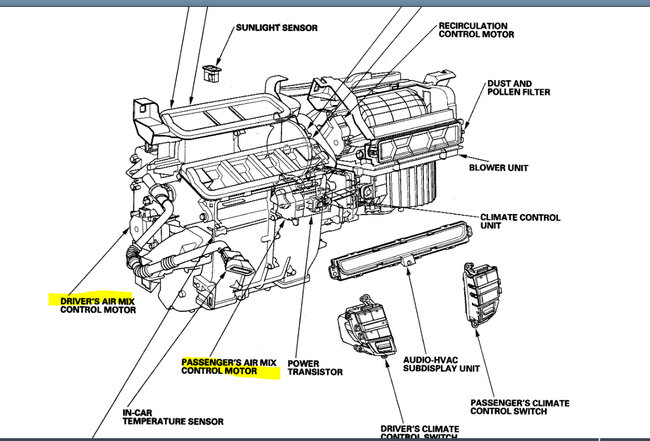

Yes, the vent that is blowing 93 degrees has always been hot, that is the small passengers side vent near the door, but it is the only vent that blows hot. I only checked the actuator under the steering wheel as I changed the temperature from hot to cold, it was moving and functioning properly. I have not checked the actuator on the passenger side because I do not know how to get to it from under the glovebox. I believe it is an automatic HVAC, what is the difference between manual and automatic?
Tuesday, December 1st, 2020 AT 10:46 AM
  • 110,192 POSTS
Automatic VS Manual is simple. With an automatic system, you pick a temp and the system maintains that temp. With a manual, the air temp coming into the vehicle is controlled by the driver via the blend air door.
I attached a pic showing both actuators.

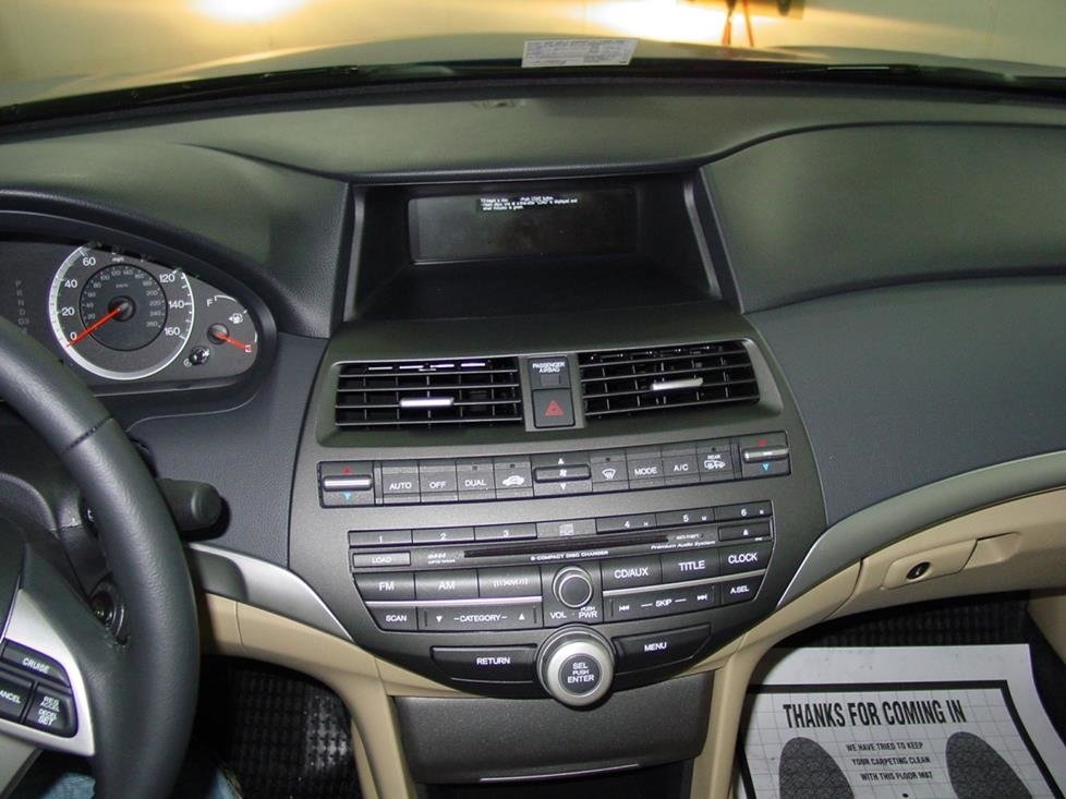

I have this setup:
  • 110,192 POSTS
If I can tell, it looks like the one button indicates auto, which would be the automatic climate control.
