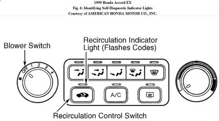

Hi natew51, Try entering the self diagnostic to see if you can come up with anything. ENTERING SELF-DIAGNOSTICS 1 . Turn ignition on. Turn blower switch OFF. Place recirculation control knob in recirculated air position (indicator light will come on). Press and hold recirculation control switch to fresh air position (indicator light goes off). 2. Continue to hold recirculation control switch until indicator light comes on for 2 seconds. At this point it will blink the Diagnostic Trouble Codes (DTCs) to indicate the faulty component. One blink indicates air mix control motor, 2 blinks indicates mode control motor, and 3 blinks indicates evaporator temperature sensor. If indicator lights come on, test appropriate component.
https://images.2carpros.com/forum/automotive_pictures/192750_HVACDiagnostic99AccordFig06_1.jpg
NOTE: Fault information is not retained in memory. In case of multiple problems, the light will indicate the DTC with the least number of blinks.

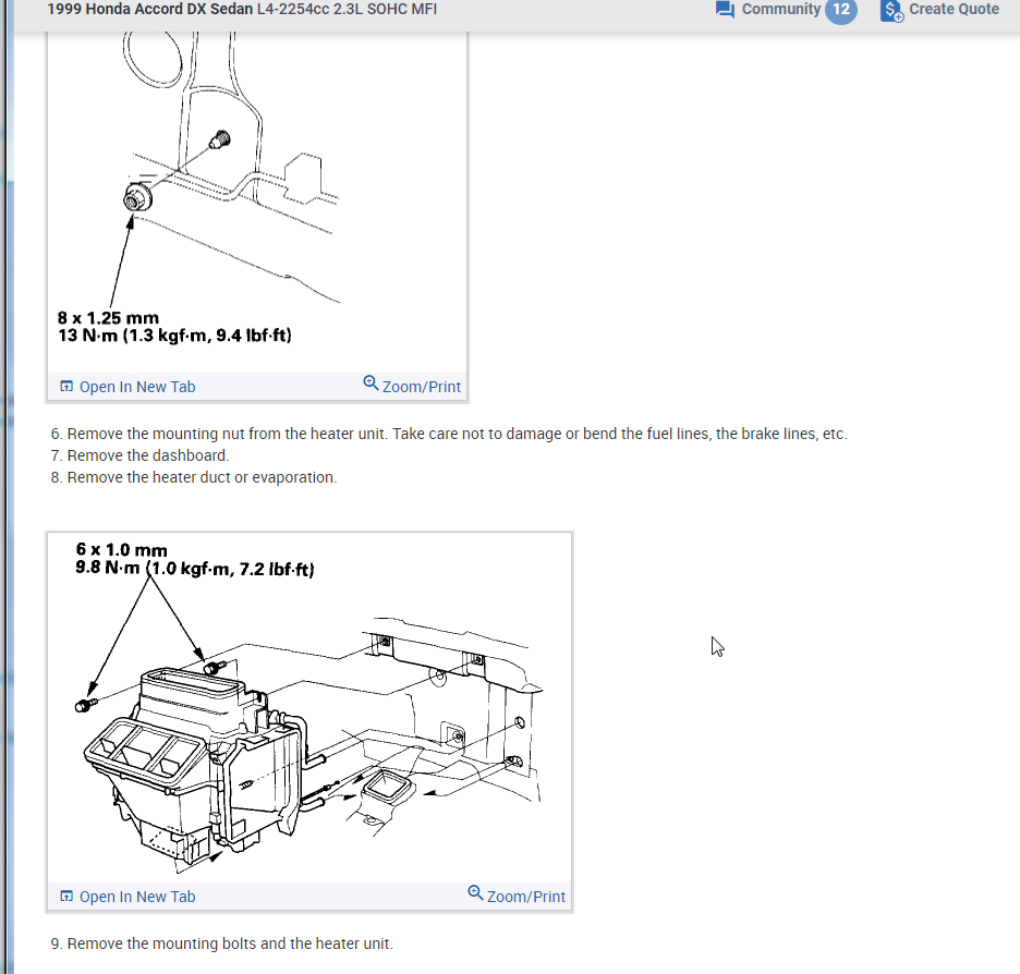

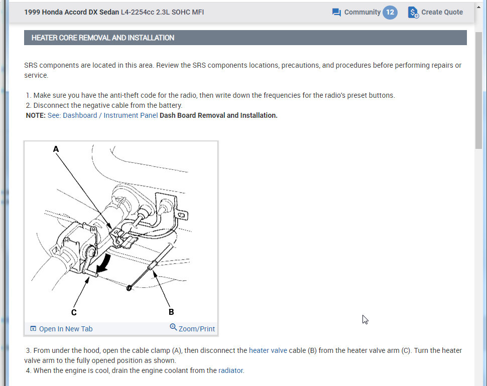

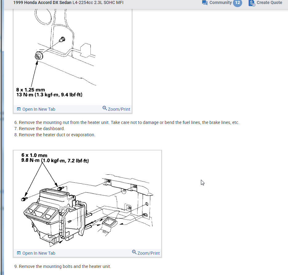

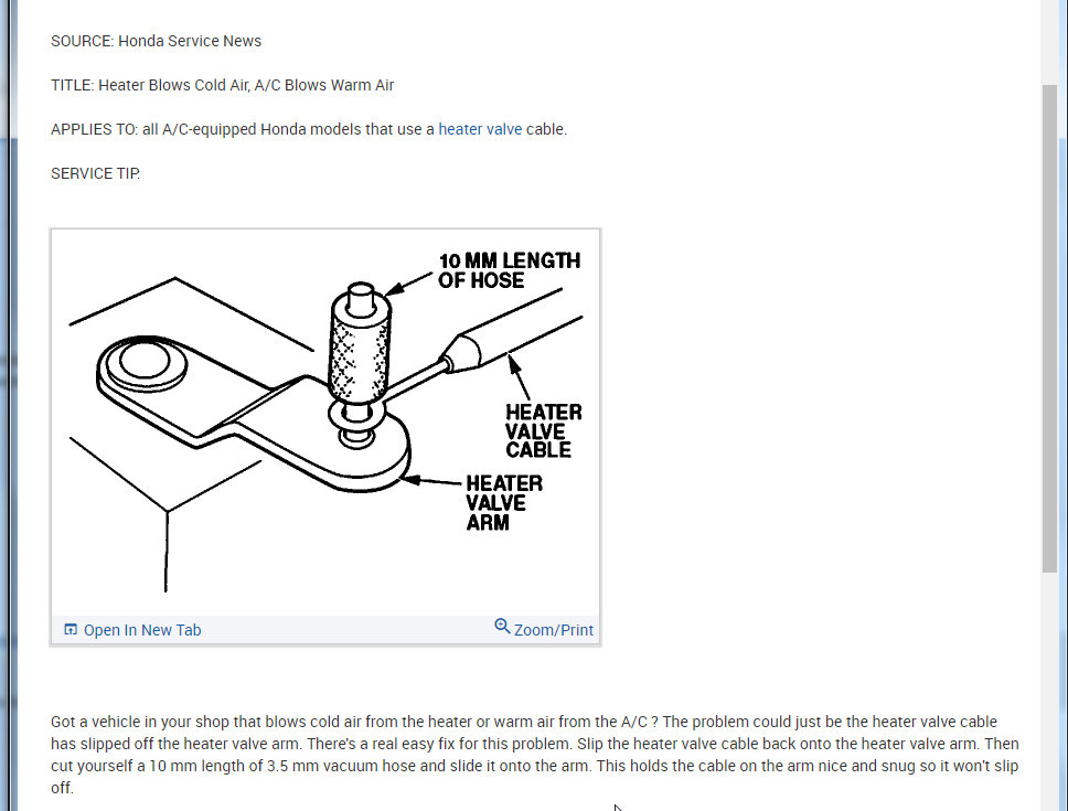

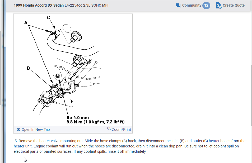

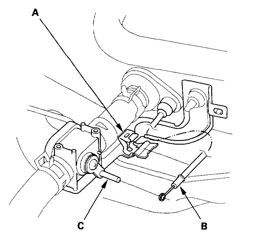

This is one of two issues which one is the control cable. I attached the info for an adjustment and a common cause of this issue. Inspect the cable as shown and see if it has slipped off.
If not, you most likely have a restriction in the heater core or an air pocket. We want to check the level of the coolant and top it off if it low. Then you will want to pressure test it. Here is a guide that will help with that.
https://www.2carpros.com/articles/radiator-pressure-test
and

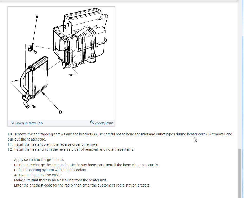

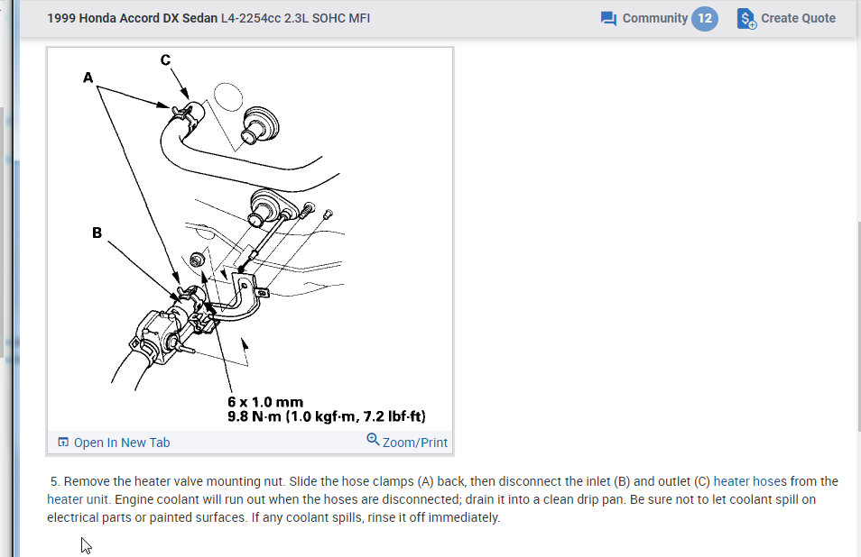

Then I attached the process for the heater core. We want to check the temp on the hoses coming from and going to the heater core. When the engine is hot, and the heater is on full hot, they should be too hot to touch. If they are not then you have an issue with the heater core.
Let us know what questions you have. Thanks

There are only a few things that can cause this, low coolant, plugged heater core, or a bad blend air door actuator. Take a look through this link:
Now, if the coolant level is full, start the engine and turn the heater on high. Wait until the engine reaches operating temperature and turn the engine off. Next, there are two heater core hoses that you will see attached at the firewall under the hood. Feel both. They both should be hot. If they are, suspect a problem with the blend air door. If only one is hot, suspect that heater core is plugged or the heater control valve isn't working. I attached a picture of the control valve to help identify it.
The valve is located under the hood at the fire wall and will be attached to one of the heater hoses. Have a helper change the temperature controller in the vehicle while you watch to see if the control valve is moving. If it isn't, then either there is a cable problem or the valve is corroded or rusted shut.
