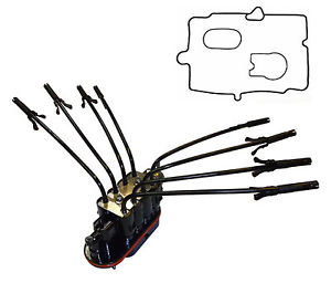

Does this have eight injectors or just two on the throttle body?
Tuesday, September 11th, 2018 AT 3:41 PM
KEITH LOTHROP
  • 46 POSTS
8 poppet valves in a CSFI.
Tuesday, September 11th, 2018 AT 11:41 PM
Okay, that system you cannot check with a noid.

Back when the no starts began I poured a bottle of Lucas fuel system cleaner into the tank (about half full, fifteen gallons) with all the cranking over and allowing her to sit afterward, maybe it loosened something up. From what I have read, black smoke, some uneven idle, a few backfires, and no start are all signs of a bad fuel pressure regulator. What is your opinion?
Monday, September 17th, 2018 AT 12:36 AM
Good morning.
First of all never, never ignore inactive codes. They could be a clue. Erasing them was a big mistake because they contained vital freeze frame information.
What O2 code? O2 codes do not mean the sensor is bad at all.
What was the fuel pressure?
Yes, it could be the regulator but it is part of the spider.

Well Roy, she is starting right up just like always, but she is showing all of the tell-tale signs of a bad fuel pressure regulator.
I am going to start driving it into work again today, praying it gets me home again.
NAPA wants $65.00 for a new fuel pressure regulator. I have found some online for as low as $15.00, but it is going to be a pain in the backside to replace. I am going to stick with the ACDelco when I do it I will let you know what happens, so you may help others later on.
