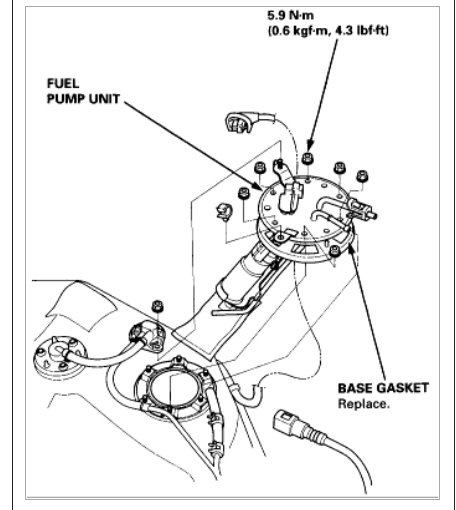

Yes, this sounds like a weak fuel pump, but to be sure here is a guide to help you test the pressure:
With vacuum hose disconnected 265 - 314 kPa (38 - 46 psi)
With vacuum hose connected 206 - 255 kPa (30 - 37 psi)

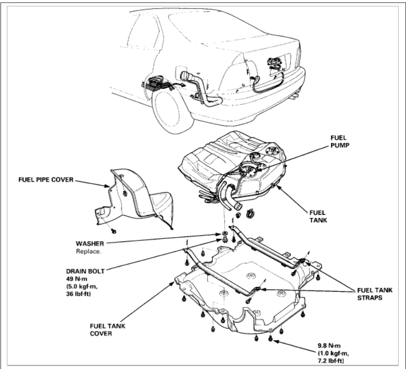

Here is a guide to help you see what you are in for when changing the pump out. With diagrams below on how it will be for your car:
https://www.2carpros.com/articles/how-to-replace-an-electric-fuel-pump
Please run down these guides and diagrams and report back.

Thank you. I just changed the fuel pump with one that is specified for that motor. Once it starts it runs great and does not sputter or anything at an idle.

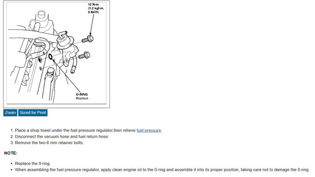

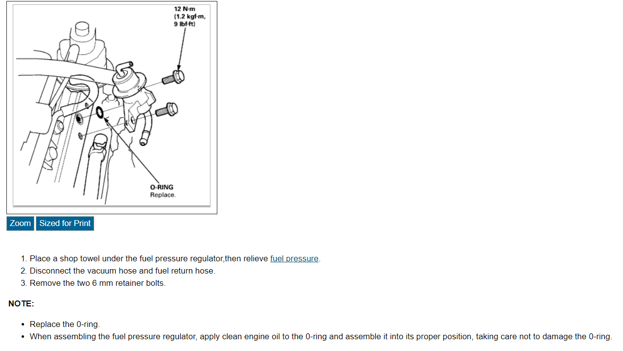

It sounds like the fuel pressure regulator is stuck. I would try removing it to see if it holds pressure. Here is a diagrams so you can see what I am talking about:

Okay, I will try that. Thank you
