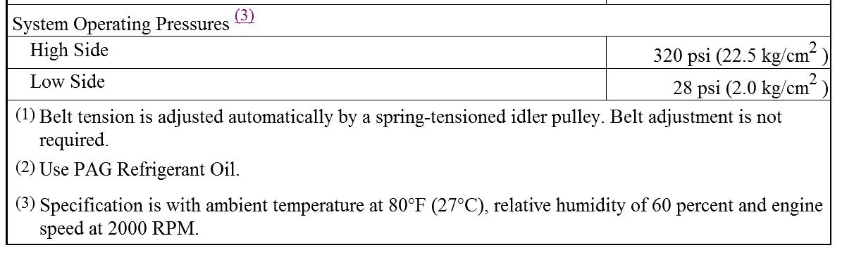

Yes the system was vacd for 45 minutes and pulled to 29hg v. From what I understand 55 psi on the low side is fine for 100 degree ambient

Here are the specifications.
Referigerant is 36 ozs without rear unit and 64 if with rear unit.

At 2000 rpm thats right where im sitting on the low side. High side shoots sky high and kicks out

KHLOW2008
  • 41,815 POSTS
If you are sure the expansion valve, condenser and referigerant is correct, the other thing that can cause this would be the condenser is not being cooled sufficiently. Try spraying a fine shower of water onto the condenser and repeat the test. I don't think it is the compressor that is faulty because a bad compressor would not be able to push very high pressure, unless the relieve valve internally is stuck and supplying excessive pressure.

CAROLINACARCONNECTION
  • 66 POSTS
Its a new orrific tube. No expansion valve on my truck no rear air. Condensor is new
Thursday, July 16th, 2020 AT 12:17 PM (Merged)
KHLOW2008
  • 41,815 POSTS
Condenser is new but is it of the correct size? Is the cooling fans working correctly and drawing sufficient air through it to cool it well?
  • 66 POSTS
Yup its the extreme duty condensor larger than stock. Clutch fan is removed and twin 16 inch e fans are in place
KHLOW2008
  • 41,815 POSTS
Check the fan blades to see they are moving in the right direction. Did you try my sugestion of splashing water on the condenser to test?
  • 66 POSTS
The fans are running correct. Havent got back to the shop to get my manifold yet
