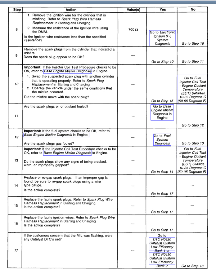

The engine is misfiring I changed spark plugs
2004 CHEVROLET SILVERADO
I just got it back from the shop. Had original pickup coil and ignition module, apparently Chevy had a problem with these in the 90s. Mechanic said they were crappy and replaced them. He said he checked fuel system and O2 sensor. don't know about the crank sensor. I assume he would have known, he plugged into the ALDL. It runs way better now, no misfiring while accelerating or cruising. However, there is still an occasional stumble or skip while idling, less than before, but still obviously present to me. I wonder about the actual ignition coil? I will check the wires for signs of arcing in the mean time. what do you suggest I use to keep them off of the metal since most of the stock clips broke? Thanks!
I usually will use zip ties to keep things in place. Just for the heck of it, at night, start the engine, open the hood, and mist water on to the plug wires, coil... all ignition components. Do it in the dark so you can see even the slighest arc. Also, the crank sensor is mounted low near the crank shaft pulley. See if you see any arcing there too. Please keep you hands away from the fan and belts. As far as the ignition module, yes, they have always caused problems. Usually, a person would shut the engine and it just wouldn't restart (no spark).

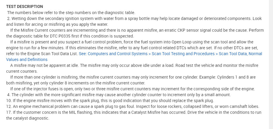

Engine misfiring can be caused by worn or fouled spark plugs, a weak spark (weak coil, bad spark plug wire), loss of compression, vacuum leaks, anything that causes an unusually lean fuel mixture (lean misfire), an EGR valve that is stuck open, dirty fuel injectors, low fuel pressure, or even bad fuel.
This guide will help us fix it

Good morning,
I would start with a set of spark plugs. You have replaced most of the possibilities for the misfires.
https://www.2carpros.com/articles/how-to-change-spark-plugs
I would also verify the fuel pressure just to be sure the pressure is correct.
FUEL PRESSURE SPECIFICATION
Ignition ON Engine OFF .................... 62-90 kPa (9-13 psi)

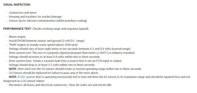

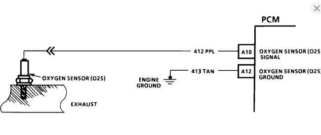

Found out my truck is running rich. Had a new O2 sensor put in two months ago so i don't think that's it. i don't have an mass air flow sensor, so that's not it. Any suggestions?
May 5, 2021 at 1:47 PM
(Merged)
How did you determine it is running rich? Was there a code set for it?
Do not discount the O2 sensor at all. It can be days old and fail. I attached the test below for the sensor and the description for both the single wire or heated sensor.
https://www.2carpros.com/articles/how-to-test-an-oxygen-sensor-02-sensor
Did you check the fuel pressure?

OPERATION:
A rich exhaust (excessive fuel) has almost no oxygen. When there is a large difference in the amount of oxygen touching the inside and outside surfaces, there is more conduction, and the sensor puts out a voltage signal above 0.6 volts (600 mV). With lean exhaust (excessive oxygen) there is about two percent oxygen in the exhaust. This is a smaller difference in oxygen from the outside surfaces which results in less conduction and a voltage signal below 0.3 volts (300 mV). The voltages are monitored and used by the control module to "fine tune" the air/fuel ratio to achieve the ideal mixture desired.
The control module puts out a reference signal of 0.45 volts (450 mV). The reference signal serves two purposes. The first is to run the engine when it is in open loop mode of operation. When the air/fuel ratio is correct the control module senses 450 mV. When the engine is operating with a rich air/fuel ratio there is a reduction of free oxygen in the exhaust stream and the O2 sensor voltage rises above the reference voltage.
When the engine is running lean the voltage drops below the reference voltage due to the excess oxygen in the exhaust stream. The O2 sensor provides the feedback information for the closed loop operating mode of the fuel delivery system. The O2 sensor indicates to the control module what is happening in the exhaust. It does not cause things to happen. It is a type of gauge: Low voltage output = lean mixture = high oxygen content in the exhaust; high voltage output = rich mixture = low oxygen content in the exhaust.
CONDITIONS THAT CAN SET CODES:
An open O2 sensor, should set a Diagnostic Trouble Code (DTC) 13. A constant low voltage in the O2 sensor circuit should set a DTC 44. A constant high voltage in the circuit should set a DTC 45. DTC 44 and DTC 45 could be set as a result of fuel system problems.

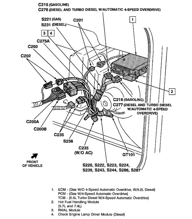

Chevrolet had a lot of problems with the ECM's that year. something you can try
locate the ECM and with the truck running give it a little tap with a screwdriver handle
If it stumbles or stalls replace the ECM. I'm attaching a schematic to help you fine the ECM, Let me know if this was helpful.
Thank you
Joe T

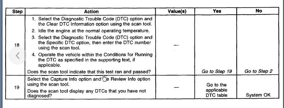

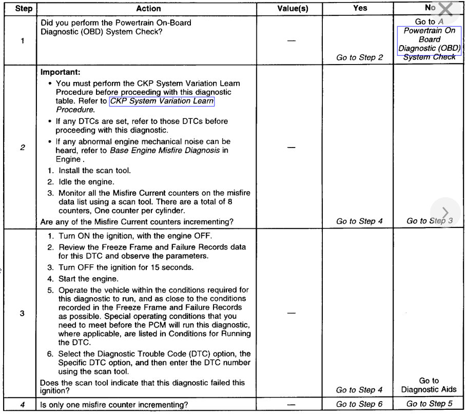

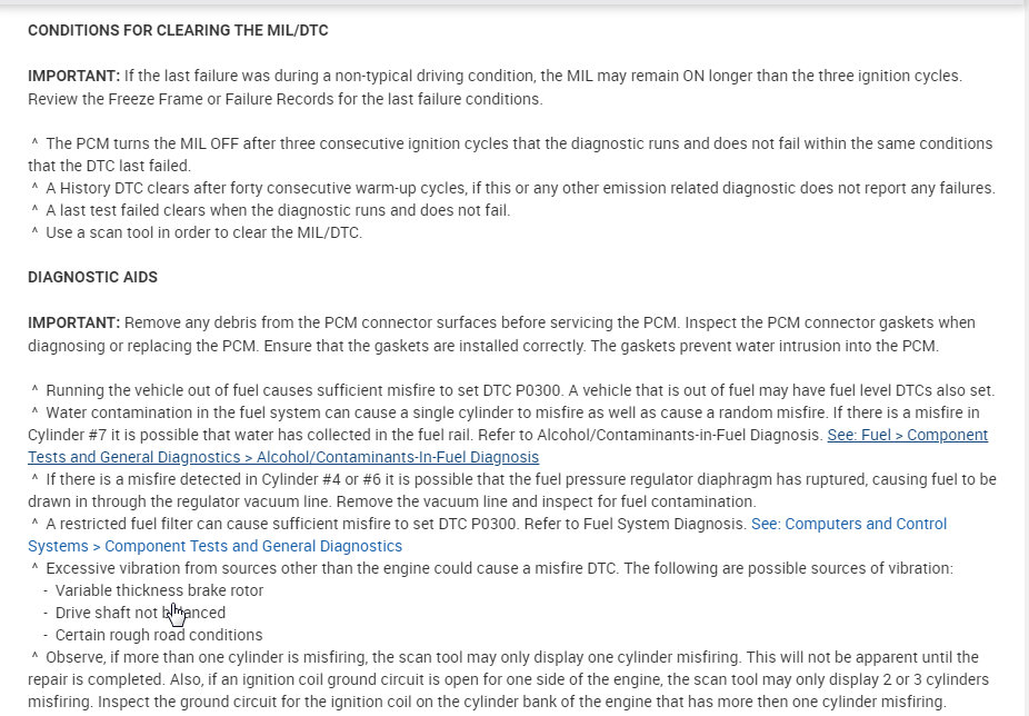

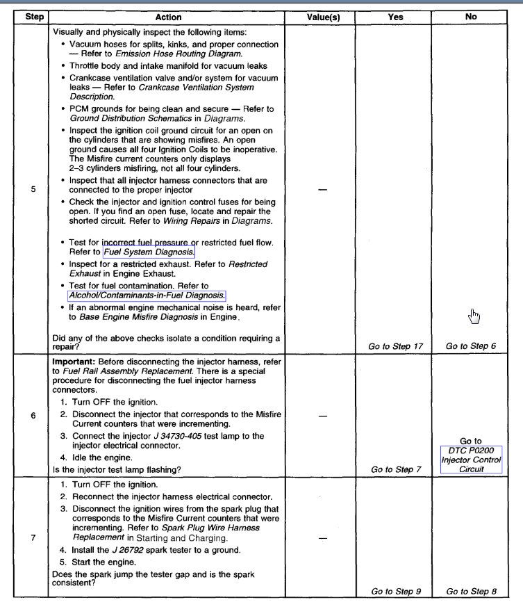

Hi, I have the truck listed above crew cab dually with the 454 7.4L. And i start it up it runs really rough, and then just shuts off. I touched the left side exhaust manifold and muffler and they were both cold as ice as of that side of the motor is not firing. I have recently ran it out of gas maybe it sucked some stuff into the carburetor? I have replaced distributor cap, rotor, spark plugs and wires, and coil,. New fuel filter last year. I have no clue why it is doing this i wanted to surprise my grandpa with the truck because it was the first truck he ever had! So it is a pretty special truck. Anyways would really appreciate some help don't know what it is doing. Ran excellent parked it. Went to go drive it the next morning and just had no power at all and stalled out on me a couple times.
May 5, 2021 at 1:48 PM
(Merged)

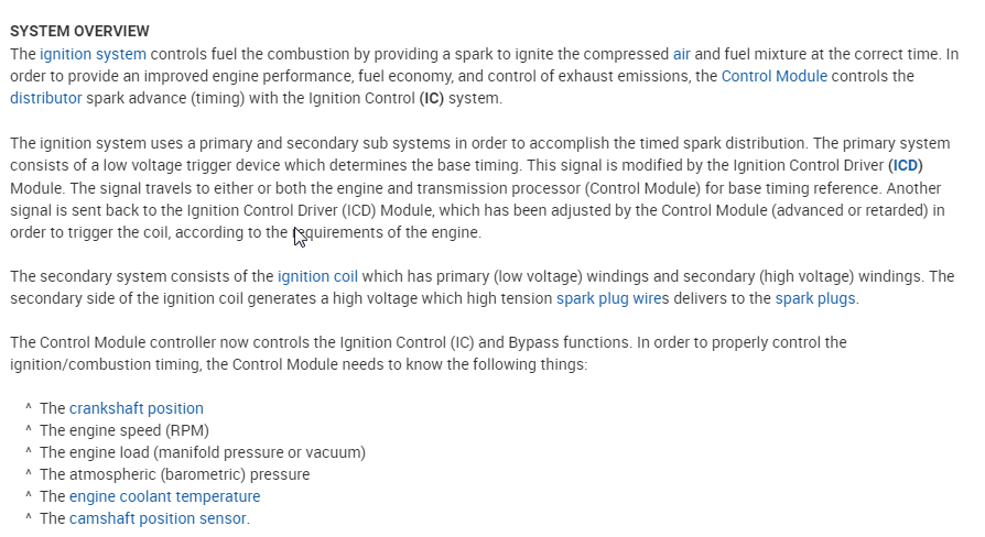

Hi Weston welcome back to 2CarPros! Lets see what we can figure out here.
I just have a couple questions, if that is okay.
Does this truck have an HEI distributor? The great big cap with the coil in the top of it?
Have you checked each cylinder for spark?
Here is a guide to get you started troubleshooting this:
Get back to me on my questions and look this guide over and we can go from there.
Rich
Rich
