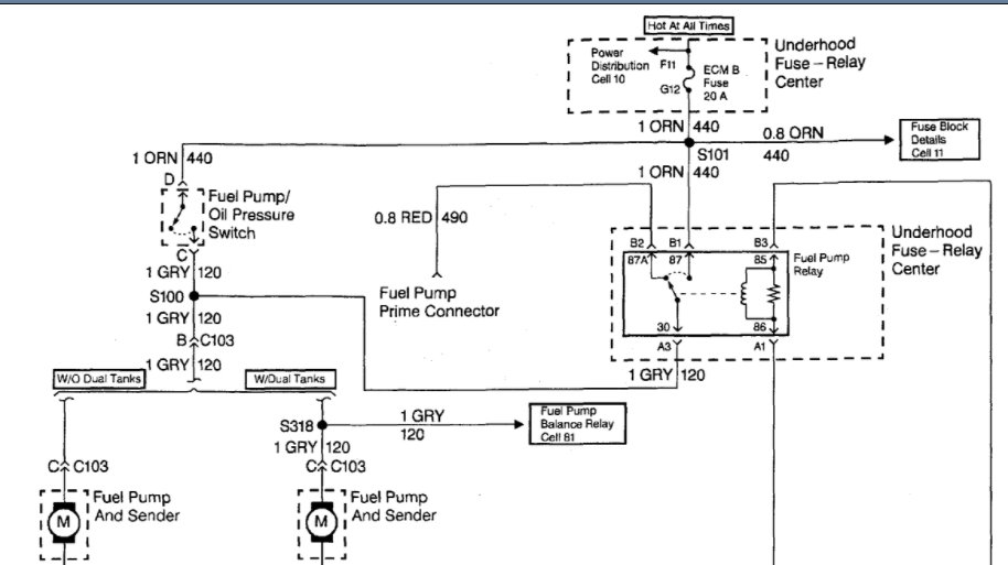

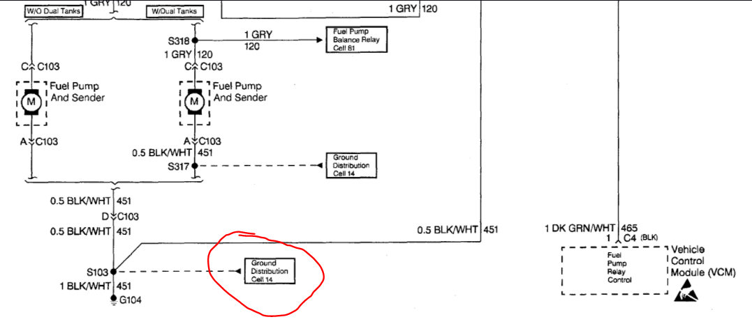

DANNY L
  • 5,648 POSTS
Hello, I'm Danny.
The 1988-1998 Chevrolet obs had a problem causing weird gas gauge related problems. You should first check the fuel pump- sender ground wire that attaches to the frame. There is also a ground strap that goes from the fuel tank to the frame. Sometimes road debris or road conditions can deteriorate are dislodge-destroy the ground strap and create havoc with the fuel gauge. Here is a wire testing tutorial for you as well:
I've attached a fuel pump wiring diagram below for your truck. The ground is cell 14 and I circled it in red. Let us know what you find after you clean, check and inspect the ground wire and ground strap. Hope this helps and thanks for using 2CarPros.
Wednesday, June 2nd, 2021 AT 12:35 PM (Merged)

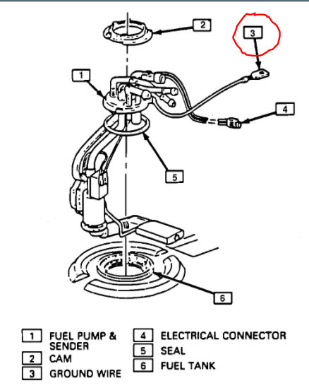

DANNY L
  • 5,648 POSTS
Hello, I'm Danny.
There has always been issues with fuel gauge problems on the 1988-1998 Silverado's. The most common being the fuel pump ground. I would get under the truck and clean the ground connection first. Here is a tutorial show how to test wiring:
I've attached a picture below and circled it in red. Also, Since the fuel sending unit is part of the fuel pump assembly has it ever been replaced? Hope this helps and get back to us after checking the ground and we'll go from there. Thanks for using 2CarPros.

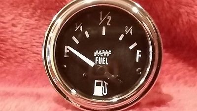

Hi I want to install a Fuel Level Gauge. My cluster fuel Level gauge does not work. How would I install a Fuel Level Gauge? Where would I run power from to make it work. This is what I am looking to install. Thanks.
Wednesday, June 2nd, 2021 AT 12:36 PM (Merged)
SEAN SILBERHOLZ
  • 44 POSTS
This is what I am looking at.

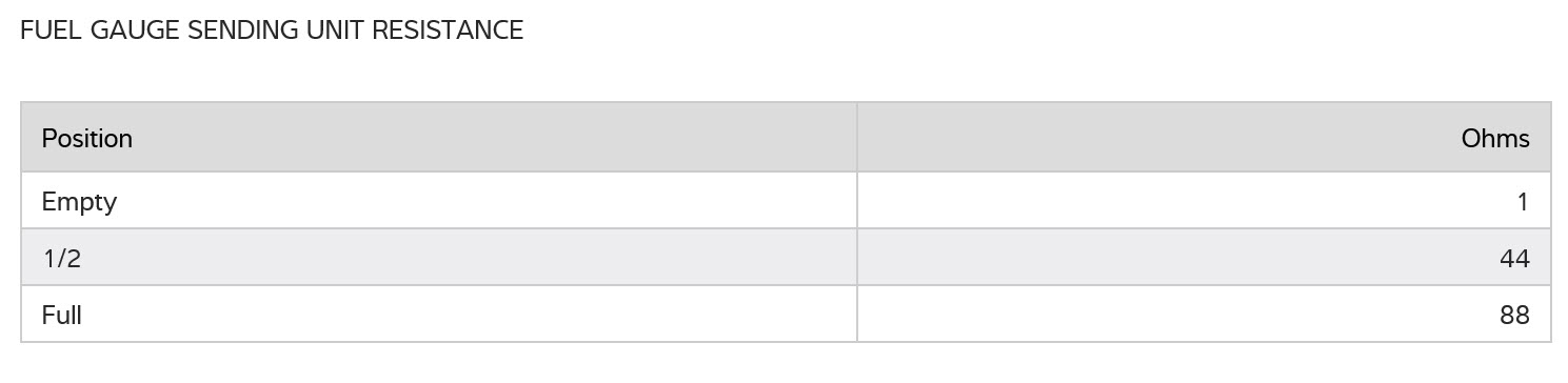

HMAC300
  • 48,601 POSTS
First does the current gauge read full or empty. Have you tested to see if sender is working. Are there instructions with the new gauge you want to put in? One wire will need low voltage to operate it like 6-7 volts other to sending unit and other to ground if a 3 way connection. See pics how to check current problem.
