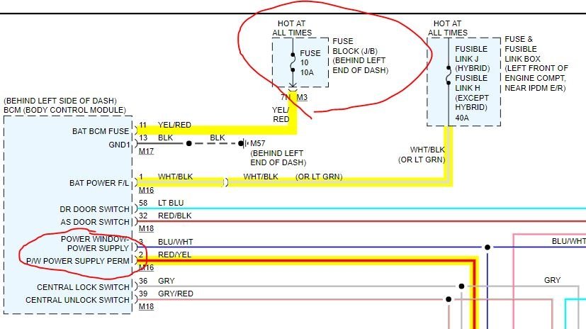

I think it might be a fuse but they are not labeled.Can you send me the fuse box diagram please?
Jun 7, 2019 at 3:49 PM
  • CAR REPAIR CONTRIBUTOR
  • 110,193 POSTS
Welcome to 2CarPros.

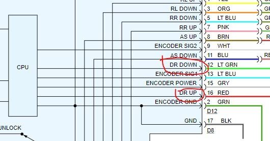

I hate to say it, but one fuse covers all the window operations. If others are working, chances are it isn't a fuse. I tried to look up a pic of the fuse box, but it wasn't shown. So, I checked wiring schematics to see where power was supplied from. You are going to need to find fuse number 10 in the fuse box under the dash. I have attached two pics from the wiring schematic for you. The first shows the fuse I am referring to, and the second shows that power is supplied via a CPU to all windows. The power comes from the fuse I mentioned.
Check the fuse and let me know what you find. We may have to check the switch in the door to see if it is the problem.

Thank you for responding. It took some digging and but I found this link (below) Its listed as fuse 10 under the dash and fuse H under the hood.
