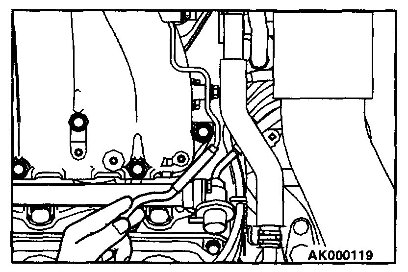

It has a full tank of gas. Go to start the car when my low fuel light comes on and my gas gauge goes to empty. Car would not start. So I replaced the fuel pump got it all back together started it up, it was running rough but stayed running without my help. I decided to take it for a drive. The car was missing the whole time. Had enough power to get up to sixty mph, eight miles into the car ride, car was glowing. Pulled over looked under the car to see that every part of the exhaust was red hot. Towed it home. Now it will not start at all. I can smell fuel up by the engine after trying to start it and I have spark. What do you suggest?

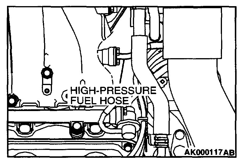

If everything was red hot, it was running extremely rich or the catalytic converter is plugged. The first thing I would do is recheck the fuel pump pressure. Make sure the fuel pressure regulator is working and not allowing too much pressure to build.
Here are a couple links that show how to check both:
Now, since the vehicle is an 2003, it has OBD2 diagnostics. If there was a misfire, you need to scan the computer to determine which cylinder or cylinders were the problem. If one of the injectors is stuck open, it will dump fuel causing the issue. If you can narrow it down to which cylinder, then we can check that injector. Here are some general directions for testing the fuel injectors. If you find the specific cylinder, make sure it is getting spark and the injector isn't sticking open.
https://www.2carpros.com/articles/how-to-test-a-fuel-injector
Here are fuel pressure testing specific to your vehicle. It will require a scanner to complete:
All attached pictures correlate with these directions.

1. Release residual pressure from the fuel line to prevent fuel spray.
WARNING: To prevent a fire, cover the hose connection with shop towels to prevent splashing of fuel that could be caused by some residual pressure in the fuel pipe line.

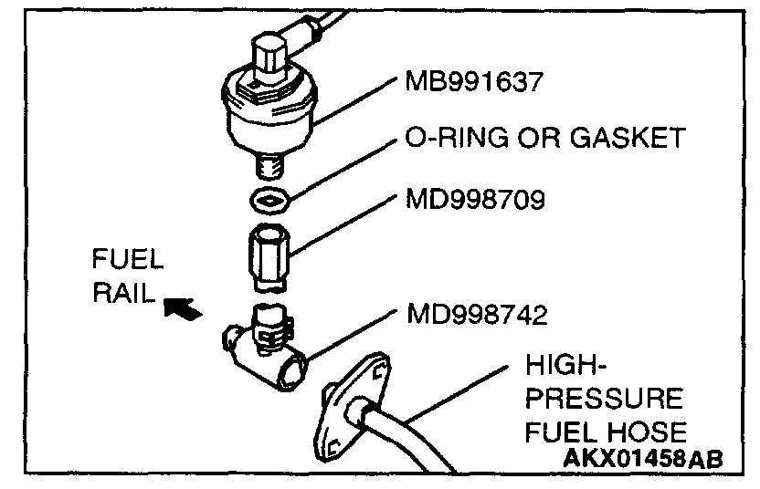

2. Disconnect the high-pressure fuel hose at the fuel rail side.

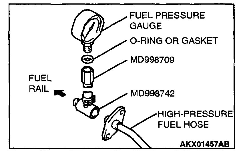

3. Assemble the fuel pressure measurement tools as follows.
1. Remove the union joint and bolt from special tool MD998709 (adaptor hose) and instead attach special tool MD998742 (hose adaptor) to the adaptor hose.
2. Place a suitable O-ring or gasket on the assembled special tools MD998709 and MD998742 and install the fuel pressure gauge.
3. Install the assembled fuel pressure measurement tools between the fuel rail and high-pressure fuel hose.
2. Install special tool MB991637 (fuel pressure gauge set) into assembled special tools MD998709 and MD998742 via a gasket.
3. Install the assembled fuel pressure measurement tools between the fuel rail and the high-pressure fuel hose.

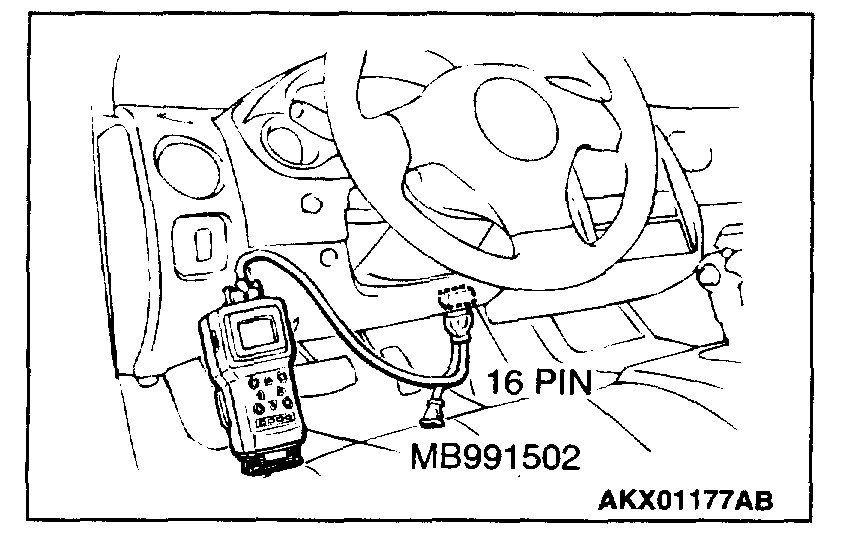

CAUTION: To prevent damage to scan tool MB991502, always turn the ignition switch to the "LOCK" (OFF) position before connecting or disconnecting scan tool MB991502.
4. Connect scan tool MB991502 to the data link connector.
5. Use Actuator test 07 to drive the fuel pump. Check that there is no fuel leaking from any section when the fuel pump is operating.

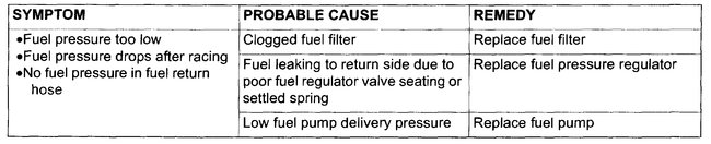

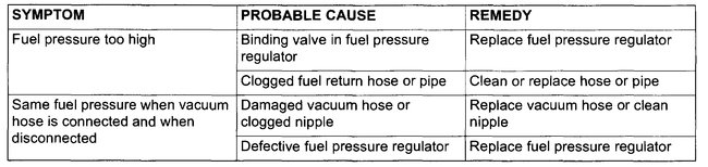

12. If any of fuel pressure measured in steps 8 to 11 is out of specification, troubleshoot and repair according to the table.

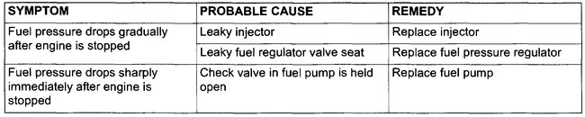

13. Stop the engine and observe fuel pressure gauge reading. It is normal if the reading does not drop within two minutes. If it does, observe the rate of drop and troubleshoot and repair according to the table. Start, then stop the engine.
1. Squeeze the fuel return line closed to confirm leak-down occurs from defective fuel pressure regulator.
2. Squeeze the fuel supply line closed to confirm leak-down occurs from defective fuel pump check valve.
3. If pressure continues to drop with both fuel lines squeezed closed, injector(s) are leaking.
