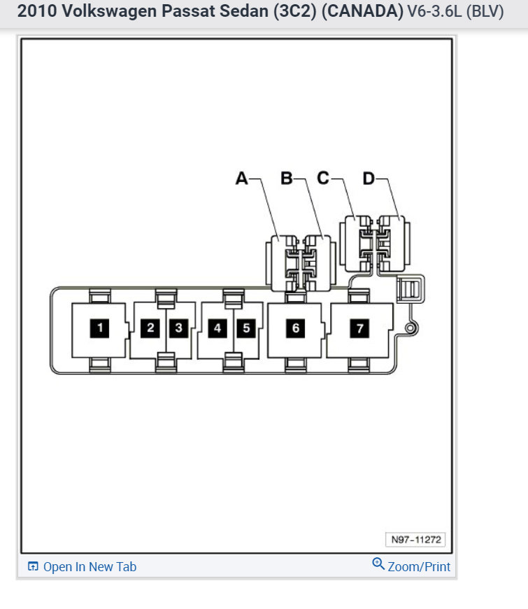

I have tracked a non starting issue to the fuel pump or fuel pump relay. I cannot however locate the relay in question.
Wednesday, April 19th, 2017 AT 6:51 PM
12 Replies
STEVE W.
  • 15,702 POSTS
It uses a fuel pump control module tucked up by the fuel tank. It does not turn the pump on/off like a relay. Instead it controls fuel pressure by rapidly pulsing the power to the pump in response to the ECMs commands. The ECM uses the sensors and fuel pressure sensor to determine the pressure needed. To test them you need a good scan tool to command the pump to certain pressures as you run the tests. You will also need to program the replacement module (if it tests faulty) so it matches the engine/vehicle.
Here is a guide to help you test the relay with diagrams below to show you the location

I cannot locate the fuel pump relay.

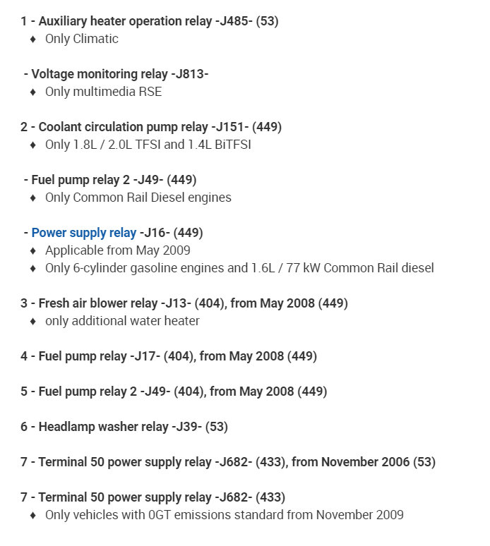

On "upper relay carrier on vehicle electrical system control module".
This is listed as "attached to the instrument panel central tube, and can not be removed without removing the instrument panel. The individual relay sockets can be removed without having to remove the relay panel".
Sorry that I cannot find a picture, and that the engineers found such an effective way to make troubleshooting a miserable experience. I knew there was a reason I do not work on VW's.

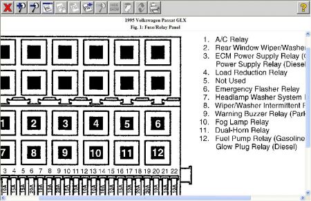

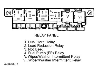

my passat wasnt getting fuel, so I replaced the fuel pump. It did fix it, the pump wont pump at all. I was wondering if maybe there is a relay switch or somthing. If not what could the problem be.
Thursday, August 27th, 2020 AT 12:28 PM (Merged)
  • 75,992 POSTS
Inspect and test the fuel pump relay and fuse no. 18 20amp
https://www.2carpros.com/forum/automotive_pictures/12900_fuel_pump_relay_16.jpg
