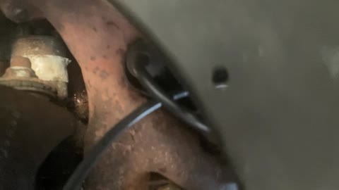

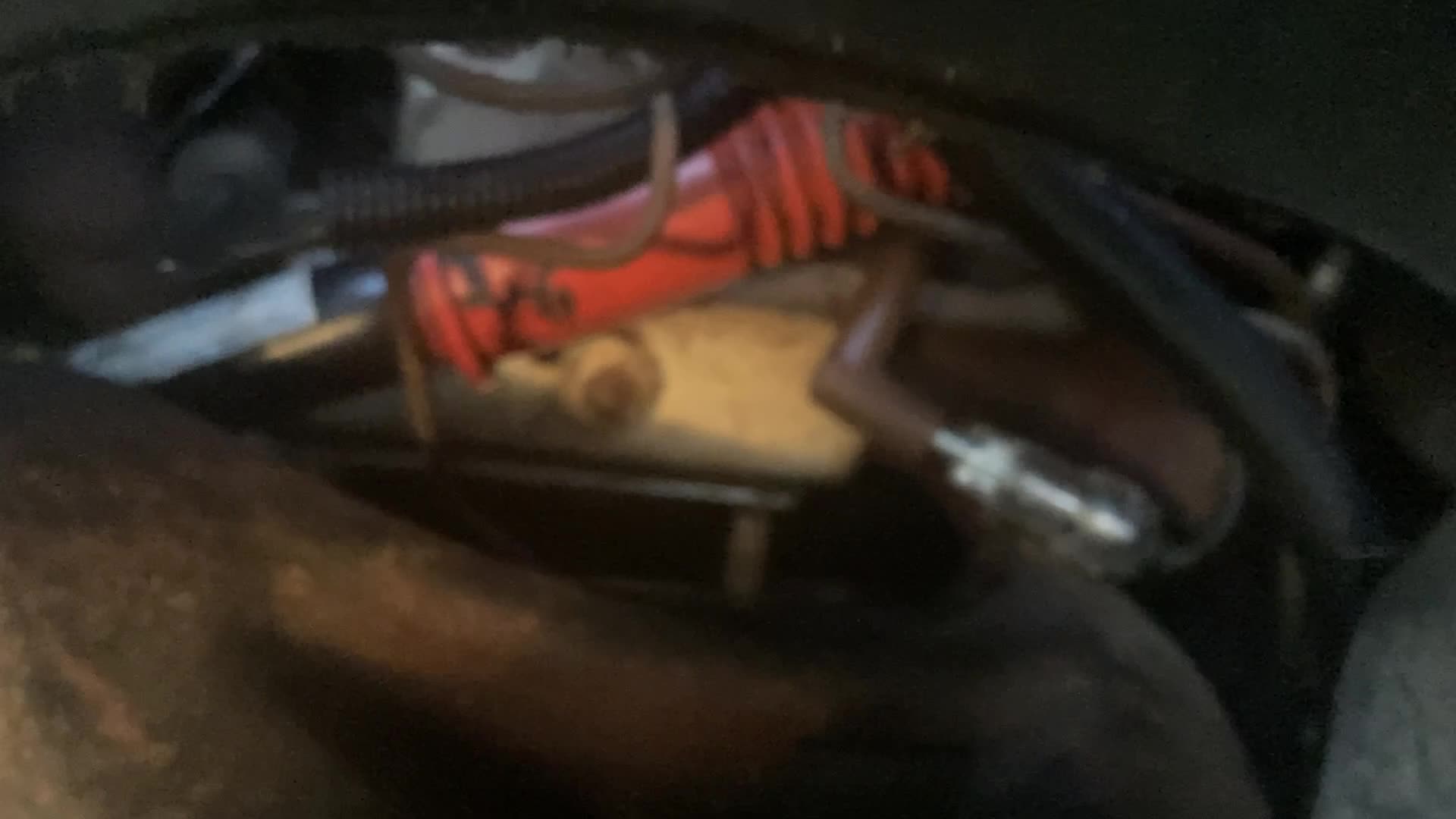

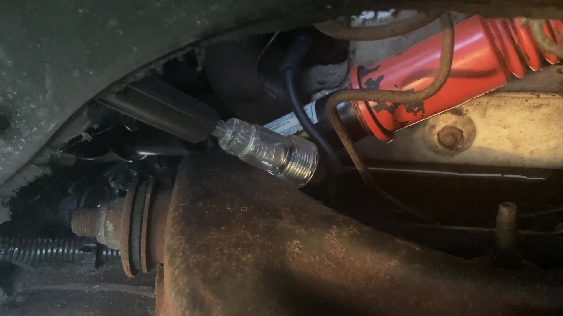

This is where you can see the arching in #6 with that Autolite plug in.
Friday, June 9th, 2023 AT 8:23 AM
BRIAN333
  • 99 POSTS

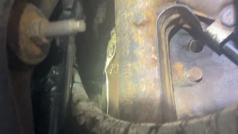

This you can see the little bit of gas coming out plug hole, I think that’s 4 cylinder.
Friday, June 9th, 2023 AT 8:24 AM
BRIAN333
  • 99 POSTS
I think that’s all of the decent videos I got, let me know what you think and I’ll try and send some rain y’all’s way !

Still waiting for the rain. LOL If you have that much fuel in the cylinder, either we have a leaking injector, a faulty regulator, or no spark. I watched the videos and am I correct in assuming the cylinder with the fuel leaking out had no spark? Was that the only cylinder like that?

The cylinder with no spark had the same amount of fuel as all the others. I guess I’m just realizing that I don’t know how much fuel would normally be in there because I’ve never pulled a plug and had fuel come out of them. If I shorted the videos to much or they didn’t have enough info just let me know and I’ll adjust, there is sound in all of those if you wanted to hear it cranking, one has the battery weakening but the others aren’t like that. They all have just about enough fuel to pour out of the plug after you take it out, or maybe it’s just that’s all it will hold, lol, sorry for the most part I usually am figuring some things out as I am saying or typing them, however no fuel pours out after removing a plug, that cylinder that didn’t spark(#4) did have the cracked ceramic on the plug and I'm hoping that’s why it didn’t show signs of firing. I didn’t retest the other side for the video. However, previous test showed all cylinders having what appears to be the same amount of fuel being injected. I'm guessing that would be more of a regulator problem, also wondering if said regulator would be cause for it to shut down while driving? In reality it could have been a combination of things because I did have some ground wires that were concerning once I looked at them. I’ve never done the fuel regulator or injectors; any advice is surely appreciated. With that fuel being in the cylinders, do I need to do anything to clear it or will it evaporate with the plugs removed being good enough?
Oh yea, what do you think about the arcing in that one cylinder (#6)?

Okay, if the cylinder isn't firing and doesn't have spark but the others do, that takes me to the distributor. Is the cap in good condition? If you place your spark tester right at the cap, do you get spark for that cylinder?

So cap and rotor are new, hadn’t put the tester right on the cap but I had spark on the one that didn’t fire when I tested it a week or so ago, just not the other day when I videoed it, as far as I know, I do most of this by myself and sometimes those a little hard to check, I can rig a separate starter switch but didn’t think I’d be going down this road. I’ll definitely try it right from the distributor cap, I can set the plug or test light so I can see it through the open hood.

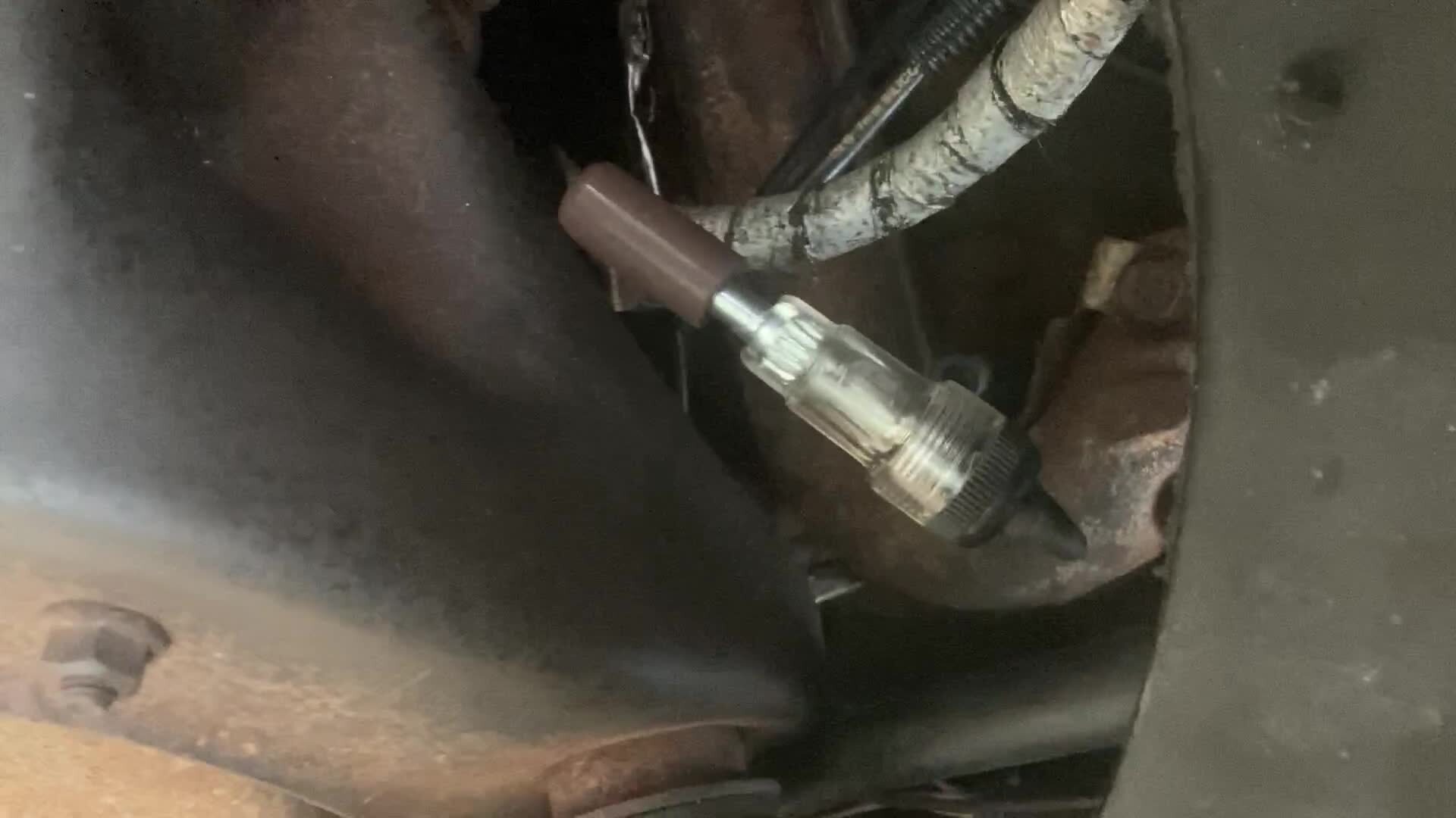

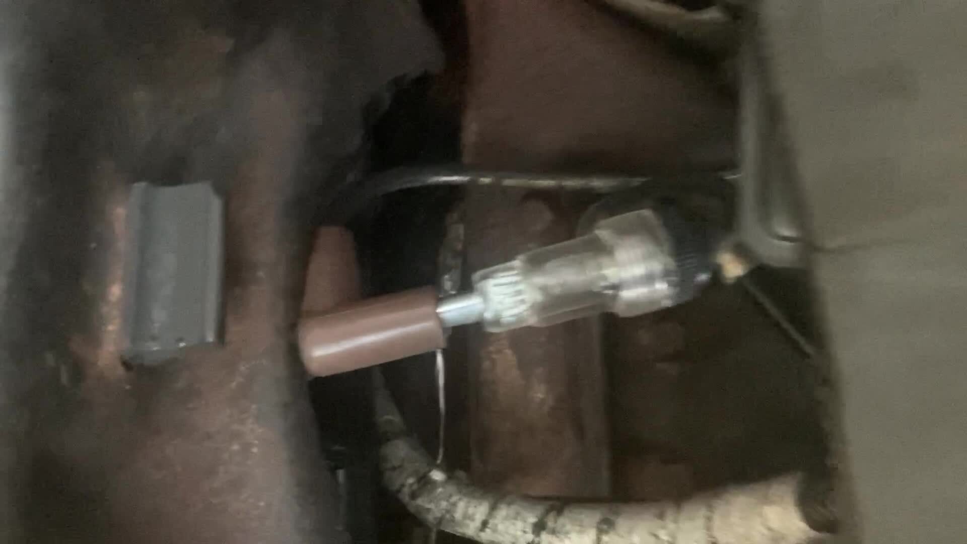

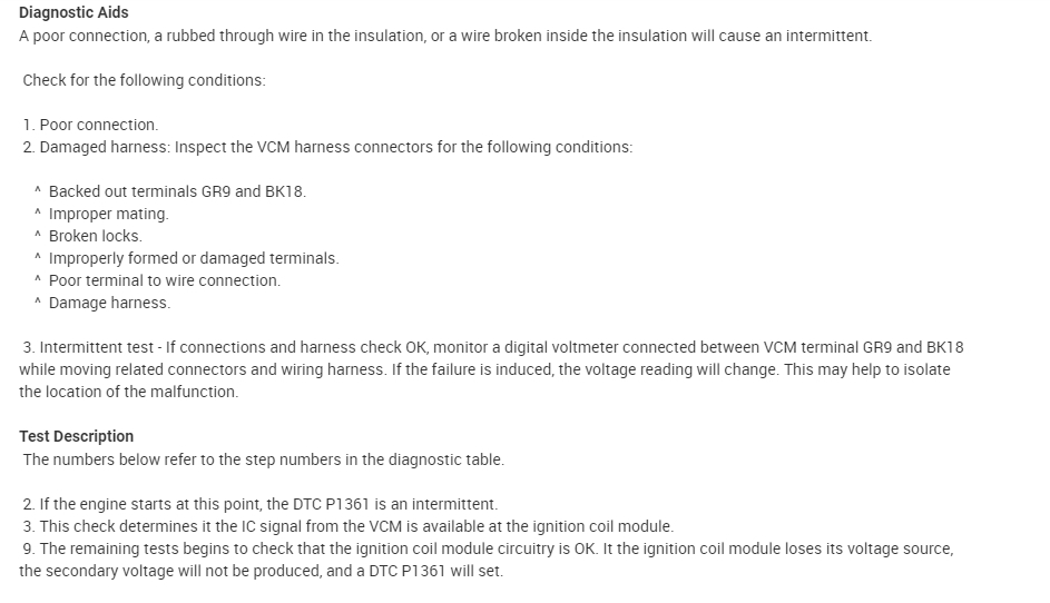

Finally got to test them and all 6 plugs have good spark, via testing with an inline spark tester. Also, I pulled one plug from each side, and they didn’t seem to be getting as much fuel in them, after pulling, I got a little bit out of each plug when I turned it over into my hand, just a little came out. It seems like a more appropriate amount. She cranks fine but doesn’t act like it wants to fire at all, like I’m missing something from the equation. Where should I look next?
Friday, June 16th, 2023 AT 5:43 PM
  • 110,192 POSTS
If you have spark and fuel, it should run unless there is a compression issue or timing issue. Do me a favor. Remove the fuse for the fuel pump and see if it starts for a second or two.
