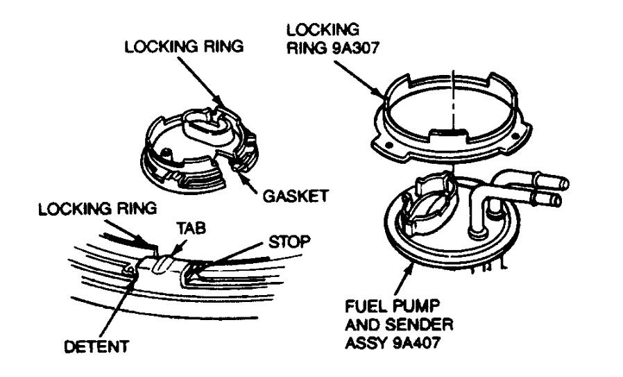

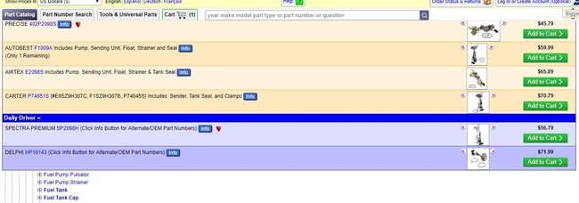

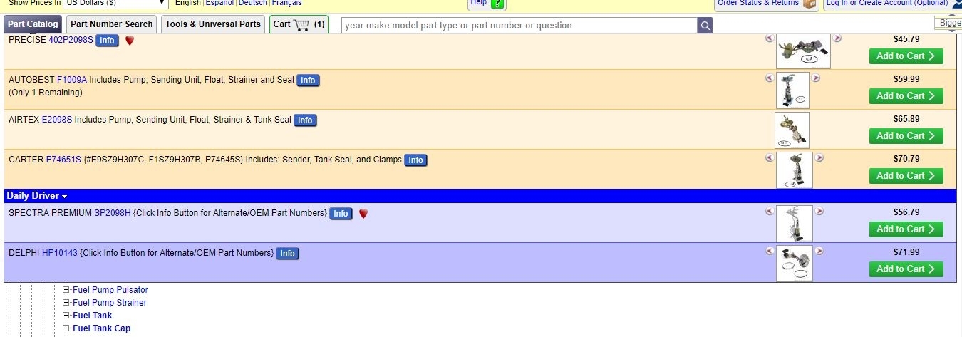

How do you replace the fuel pump and what kind do you get?

The fuel tank must be removed to gain access to the pump.

Rock auto has the pump for the best price. I attached a picture below for you.

9. Remove any dirt that has accumulated around the fuel pump retaining flange so that it will not enter the tank during removal and installation.
10. Turn the fuel pump locking ring counterclockwise using Fuel Tank Sender Wrench D84P-9275-A or equivalent, and remove locking ring.
11. Remove fuel pump and sender assembly.
12. Remove seal ring and discard.
Installation
1. Clean the fuel pump mounting flange and the fuel tank mounting surface and seal ring groove.
2. Apply a light coating of Long Life Lubricant Cl AZ-i 9590-BA (ESA-M1C75-B) or equivalent on a new seal ring to hold it in place during assembly and install in fuel ring groove.
3. Install fuel pump and sender assembly carefully to ensure that filter is not damaged. Ensure locating keys are in keyways and seal ring remains in groove.
4. Hold pump assembly in place and install locking ring finger- tight. Ensure that all locking tabs are under tank lock ring tabs.
5. Secure the fuel pump unit with the locking ring by rotating clockwise using Fuel Tank Sender Wrench D84P-9275-A or equivalent, until ring stops against stops.
