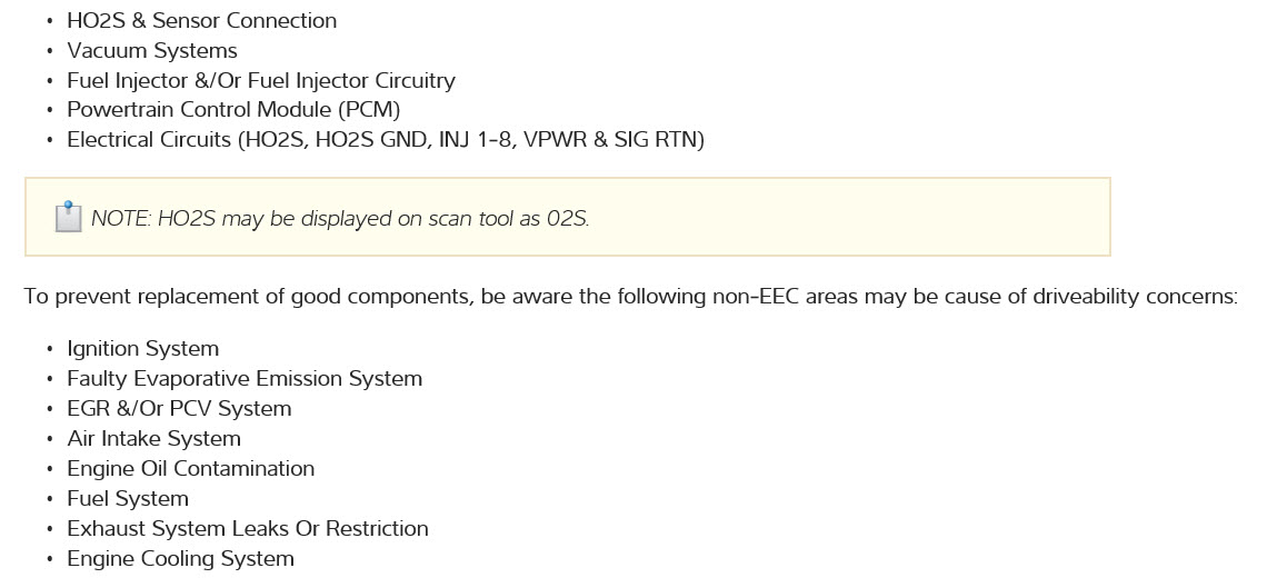

I was pulling out of store like normal and kinda jamming on it then it through two codes and is like its in limp mode. I only get like half throttle response. Seems to run fine at low rpms. I reset them but, they were p0500 and p1131. It's still running the same but, I haven't driven it enough for the codes to come back. I recently changed the fuel pump and speed sensor. The used motor was just put in when I bought it.
Sunday, September 4th, 2016 AT 8:47 AM
13 Replies
HMAC300
  • 48,601 POSTS
0500 is speed sensor in trans which could be bad or it's a wiring issue/pcm problem. for 1131 see pic for problems associated with it also check fuel pressure with a gauge auto parts rent it.

I already changed vss cause the speedo doesn't work and the old wires were twisted. Never through that code till now. I've changed fuel pump three times. Maybe its a faulty pcm and shorting things out? Only driven like 20 miles since used motor put it.
Monday, September 5th, 2016 AT 6:06 AM
HMAC300
  • 48,601 POSTS
The speedo not working may be a bad dash causing that. Check the items that are in pic like partially clogged egr system etc. Or vacuum leak. Also the people that changed the motor may have done just that and not changed oil etc.

Turns out it wasn't in limp. A plastic linkage between throttle cable and throttle body broke. Some sort of limiter or something. Im told that definitely would throw those codes because it controls fuel and air. I made a new one out of aluminum and it runs perfect. Now I just need get my e-brake handle to stay engaged. Thanks for all the help. I'm sure I will be asking more advice.
