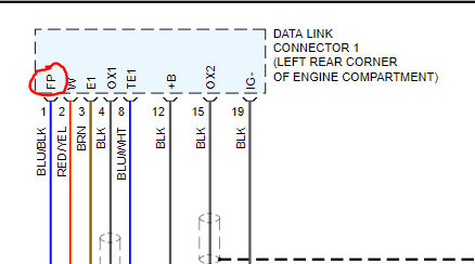

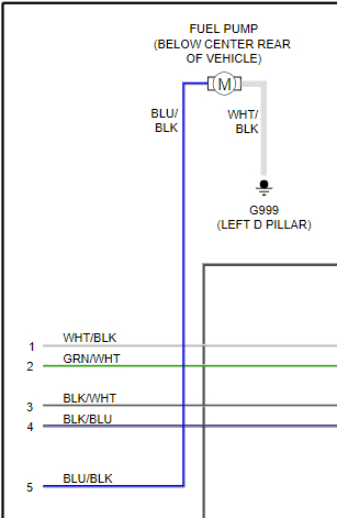

Just here to add my 2 cents. The sending unit is built into the in-tank fuel pump. Here is the wire colors for the fuel pump circuit. I've attached 2 pictures below. Hope this helps and thanks for using 2CarPros.
