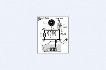

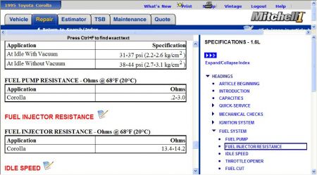

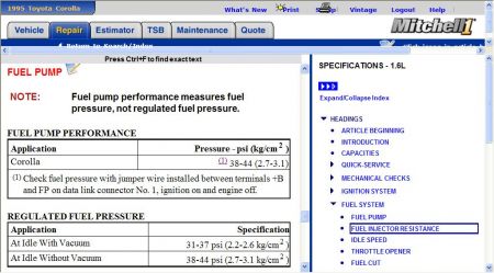

What is the amount of pressure coming from the fuel pump and how to check the pressure? How many ohms is it for the fuel injector?

Dunno what's the problem here but I'll give the info you need.
https://www.2carpros.com/forum/automotive_pictures/12900_fp1_9.jpg
https://www.2carpros.com/forum/automotive_pictures/12900_fp2_6.jpg
You hook up the fuel pressure gauge to the fuel test port on the fuel rail
https://www.2carpros.com/forum/automotive_pictures/12900_fuel_pressure_system_circuit_6.jpg
