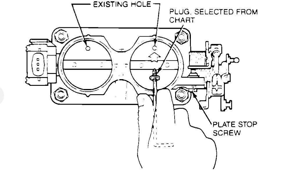

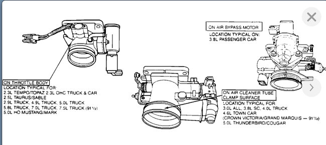

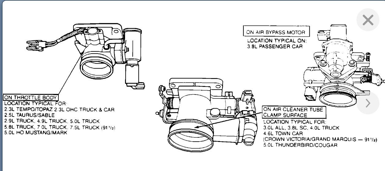

Reset IAC and how to adjust AutoZone IAC it's adjustable an the factory Ford is not. I need to figure out how to reset the IAC on my truck the sequences and find out how to adjust AutoZone adjustable IAC for my 2.3. It is the $70.00 IAC.
Friday, October 9th, 2020 AT 9:50 AM (Merged)
SCGRANTURISMO
  • 4,897 POSTS
There is no reset for your vehicle's IAC Valve. It is controlled by the electrical connector which goes to the Power-train Control Module[PCM] or "computer". If the IAC Valve goes bad, it is simply replaced. Here is a link below for you to go to:

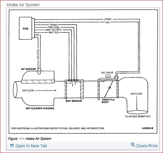

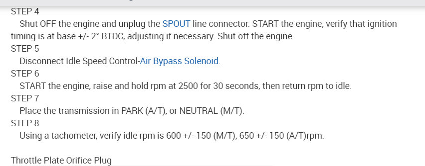

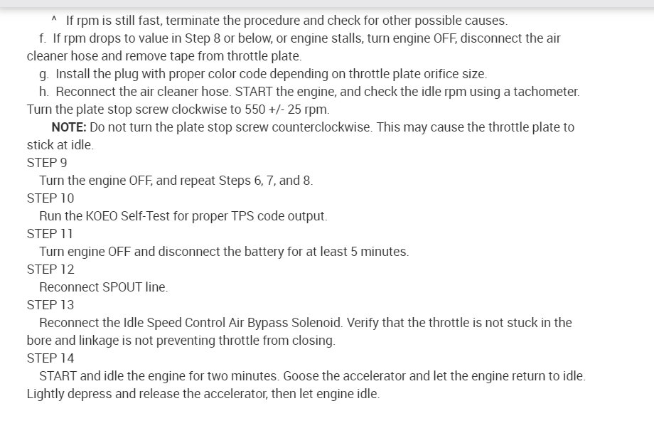

AARONWELLS1919
  • 1992 FORD RANGER
  • 2.3L
  • 6 CYL
  • 2WD
  • MANUAL
  • 180,000 MILES

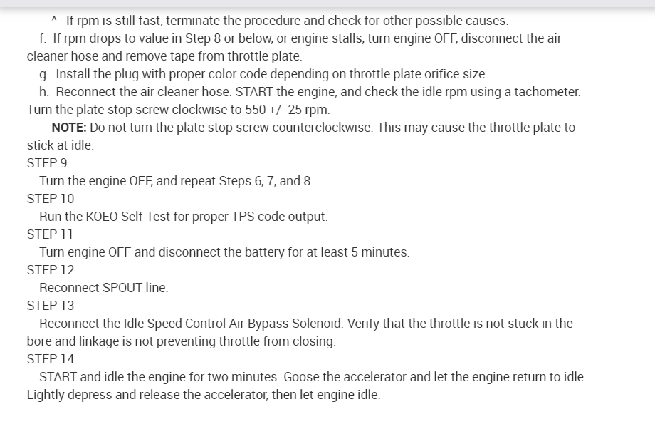

My car normally starts at 2,000 rpm than drops to 1,000 slowly. First time today it started at 1,000 rpm than bog down quickly to 500 rpm and continued, turned it off and over again same thing happen. Trying to run diagnostic but I'm lost and can't figure it out. Sometimes when it sits for a bit and is turned on it will start normally and will drive normally, other times it just sit there and bogs down. If the vehicle is turned off and on even minutes after it will start at a low rpm again than bog.I started my vehicle today it was a bit low on gas so I thought that was my issue, filled it up and I thought the issue was fixed. But like I said when I turn off, than on minutes later it will start at a bog.

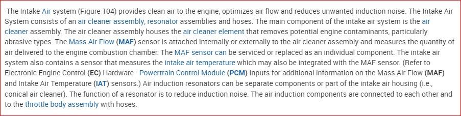

Hi Aaron,

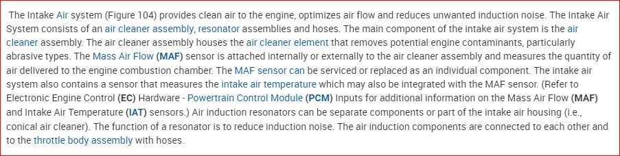

This could be an IAC but usually when these fail, the engine starts and shuts off quickly. However, if it feels bogged down then this could be due to a restricted air flow. The other thing it could be is the MAF itself. Sometimes these get dirty and they send incorrect readings to the PCM so it causes rough running or idle issues.
Here is a video on how to test the MAF. It is easy enough that I would start with that and go from there. Worst case you can test and replace your sensor if needed and then clean your IAC and see what happens. I included videos for both. Please understand they are not exact for your vehicle but the theory is the same.
Let me know if you have questions or what results you turn up and we can go from there. Thanks
https://youtu.be/p0ocaDmcAIM
https://youtu.be/rNQGEGvophg

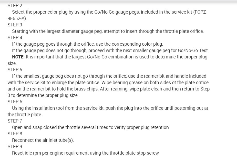

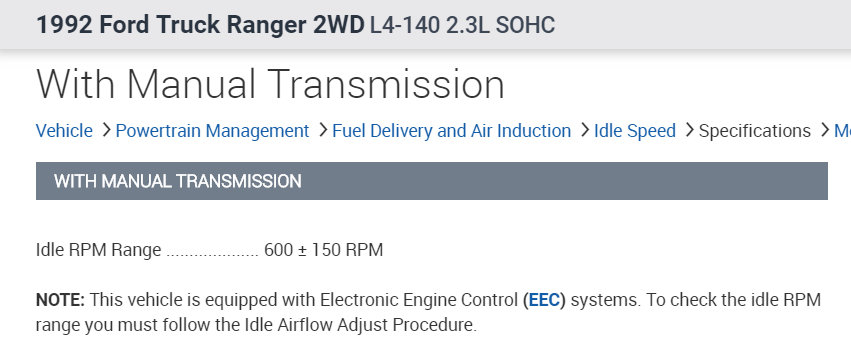

SCGRANTURISMO
  • 4,897 POSTS

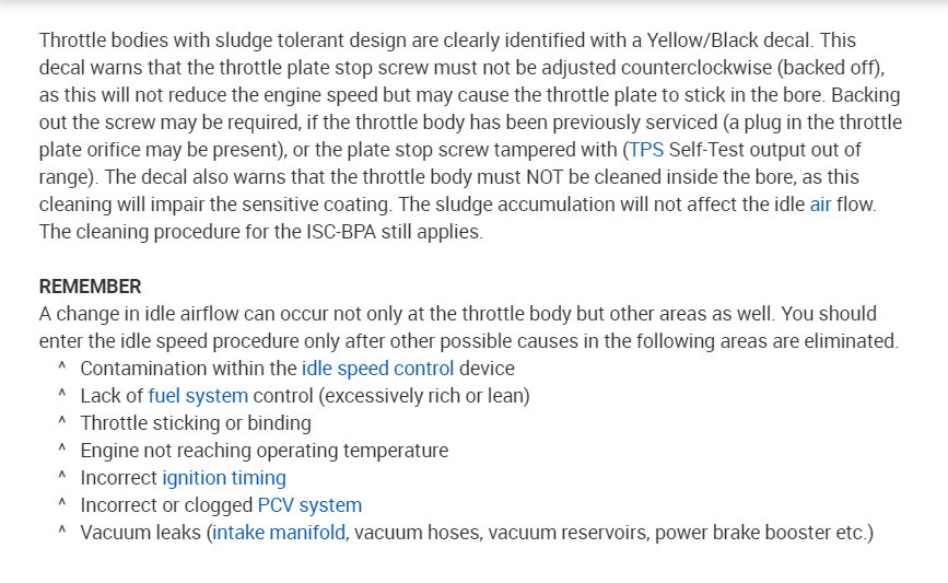

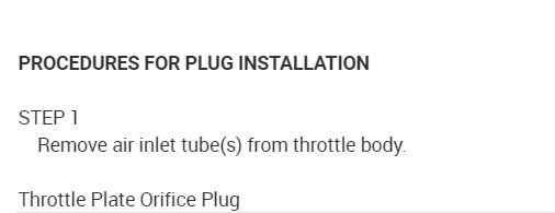

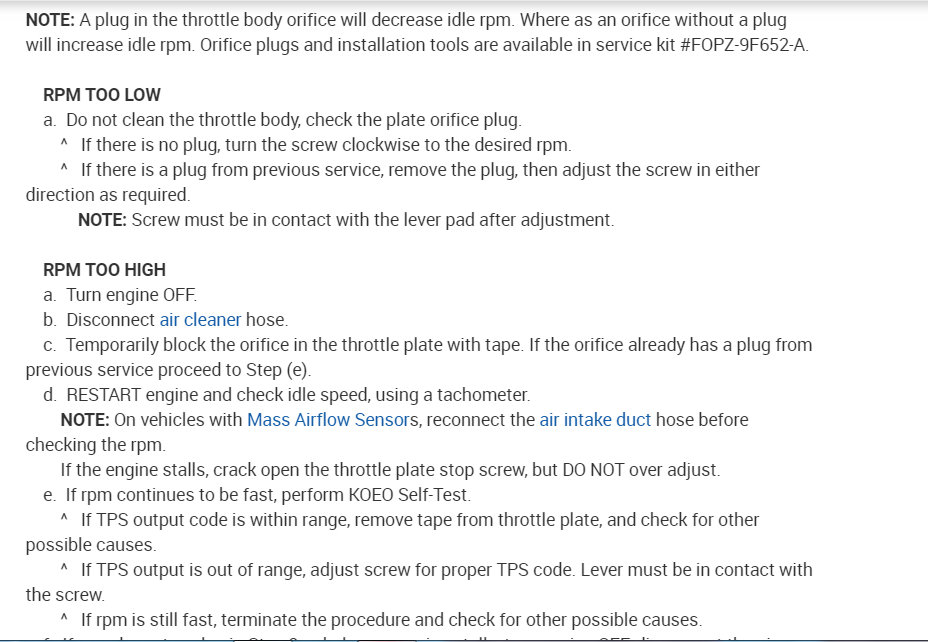

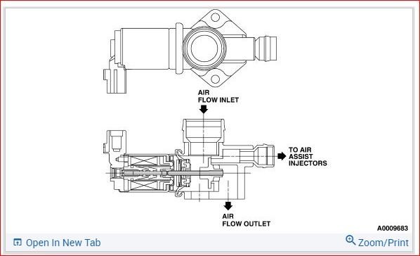

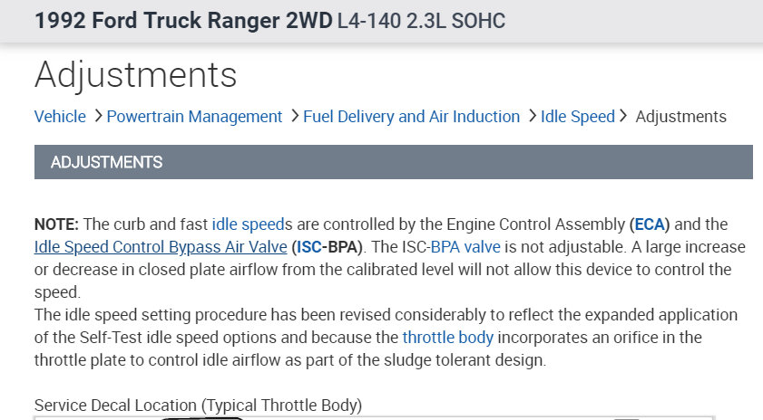

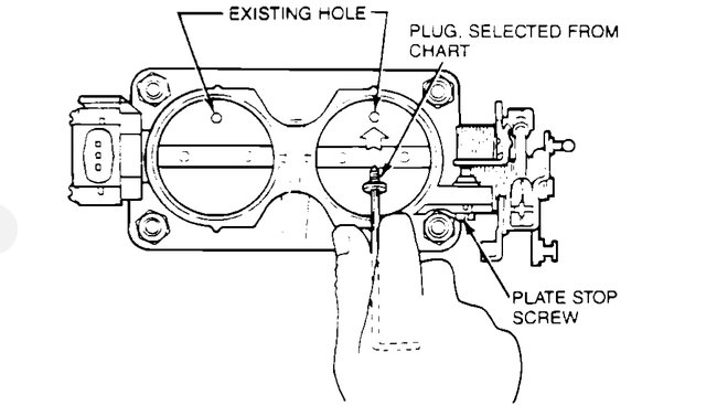

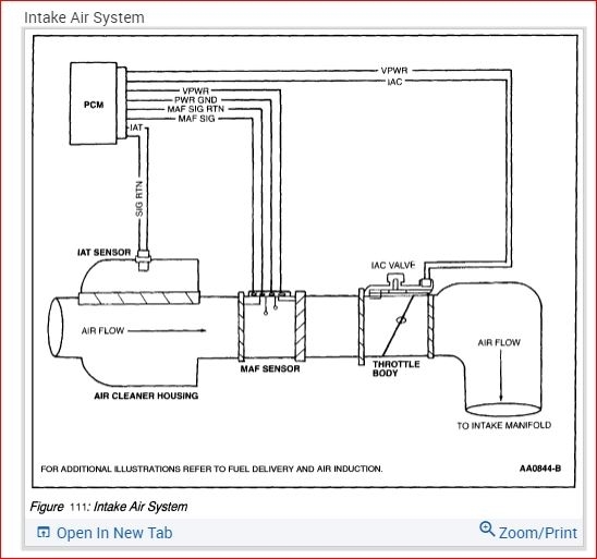

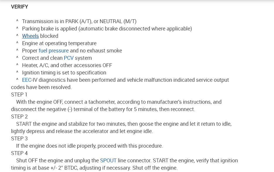

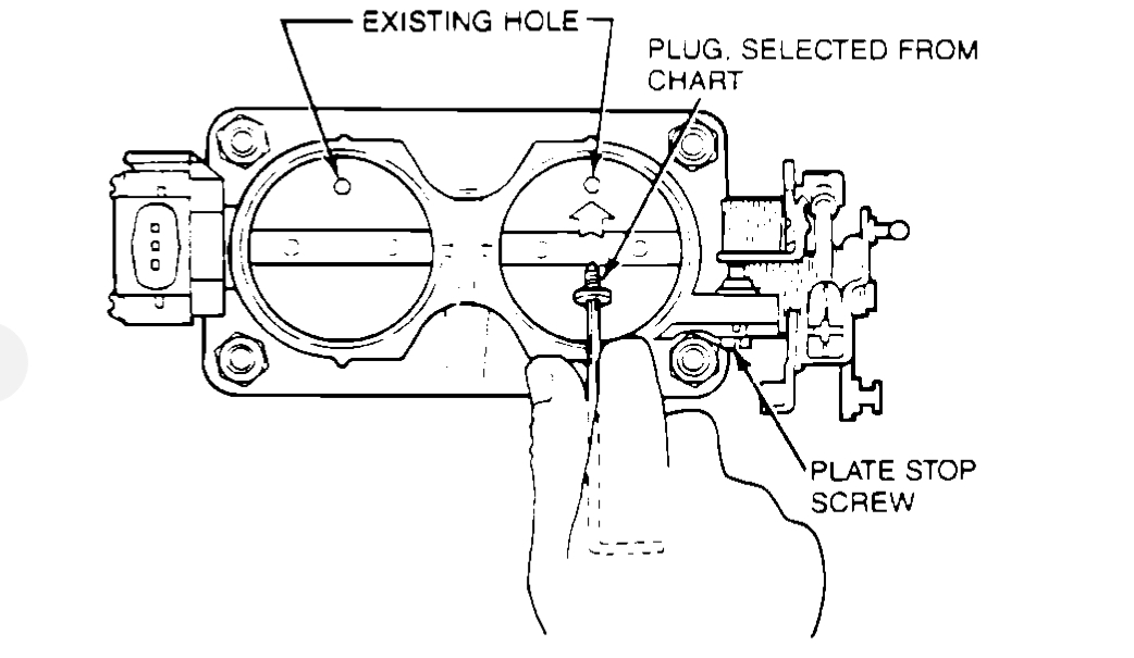

This could be a problem with your Idle Air Control Valve (IAC). I have included in the diagrams below the Ford Motor Company adjustment procedure for your vehicle's air control including what your idle speed should be set at. Please go through the guide and get back to us with what you are able to find out.
Thanks,
Alex
2CarPros
