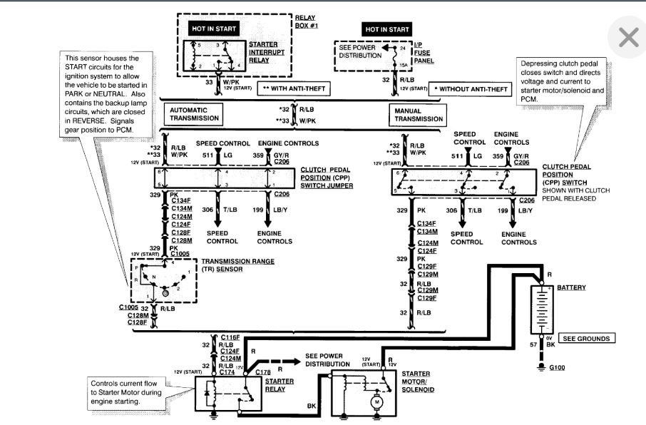

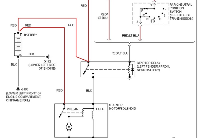

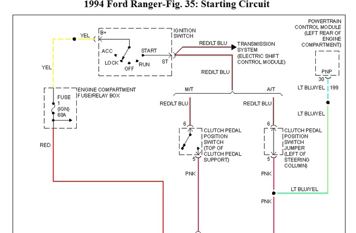

MERLIN2021
  • 17,250 POSTS
If you hear a click, then either the battery is weak, or the starter, possibly bad battery cable connections, check and clean both ends of BOTH cables! Dissconnect negative(-) first, and put it on last! If no click the starter relay is no good!
Monday, March 8th, 2021 AT 5:39 PM (Merged)
  • 75,992 POSTS
If battery/connections are okay-check fuse no. 24 10amp if okay-jumper clutch switch at clutch pedal support red and blue or white and pink wire to the plain pink wire at connector. Note: The red and blue or white and pink wire at the switch connector should have power when key is at start positon. No power to this wire and fuse no.24 okay-the ignition switch is bad.
When clutch switch is jumpered the red and light blue wire at starter relay should have power and also the black wire going to the starter solenoid. Power at black wire on the solenoid-Replace the starter-
See starter circuit below
https://www.2carpros.com/forum/automotive_pictures/12900_st1_4.jpg
https://www.2carpros.com/forum/automotive_pictures/12900_st2_4.jpg

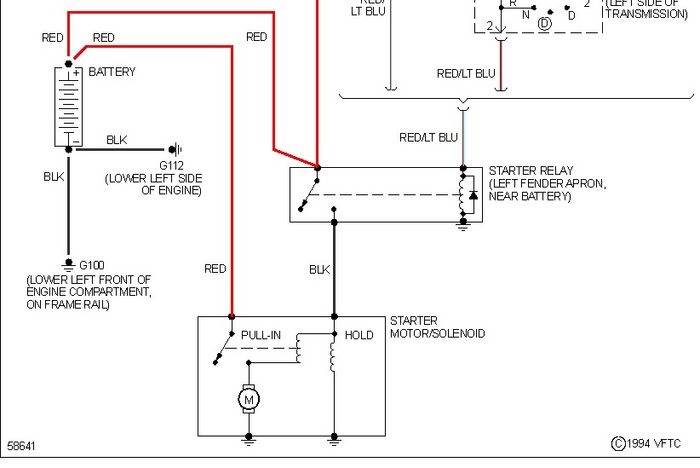

  • 52,797 POSTS
Good afternoon,
Let us start at the beginning. What are you attempting to do with the relay? This guide can help us fix it
Check out the diagrams (Below). Please let us know what you find.
