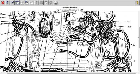

  • 75,992 POSTS
All the fusible links are on the starter relay which is located on left front inner fender panel forward of strut tower see item no.13 below
https://www.2carpros.com/forum/automotive_pictures/12900_starter_relay_9.jpg
