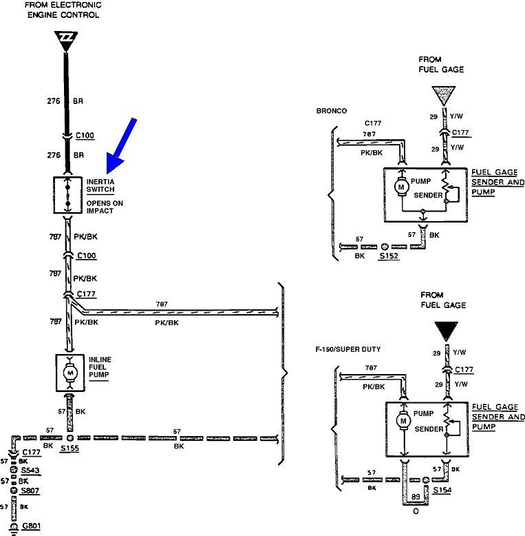

I bought this truck 6 months ago and the sending unit in the front fuel tank stopped working. The rear tank was removed due to a hole in it, so the truck would not run as it only had one tank. The sending unit was replaced, but I went ahead and replaced the inline high pressure pump at the same time. Life was good then. However, the other day, the truck sputtered like it did when the sending unit stopped working. I hauled the truck home and immediately noticed that the inline high pressure pump wasn't heard running. I climbed under and saw that the hot wire was disconnected. I was thankful to find that, thinking this would solve the issue. I rewired it and nothing, so I got my voltage tested and learned I had no power at the pump. I proactively replaced both the relays in the left side of the engine compartment, with no change. I ran a wire from the battery to the pump to test the pump and that caused it to run, and subsequently, the truck did as well. What on God's green earth is keeping the fuel pump from getting power? I don't want to purchase a new EEC-IV and that not be the solution, but I am at a loss in trying to determine why the fuel pump isn't getting power.

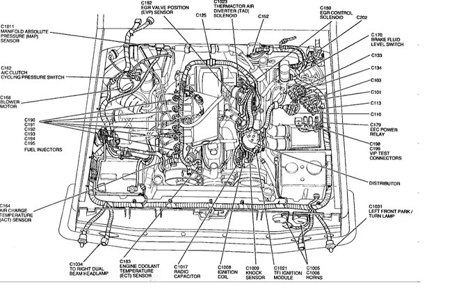

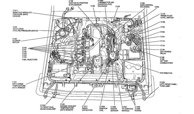

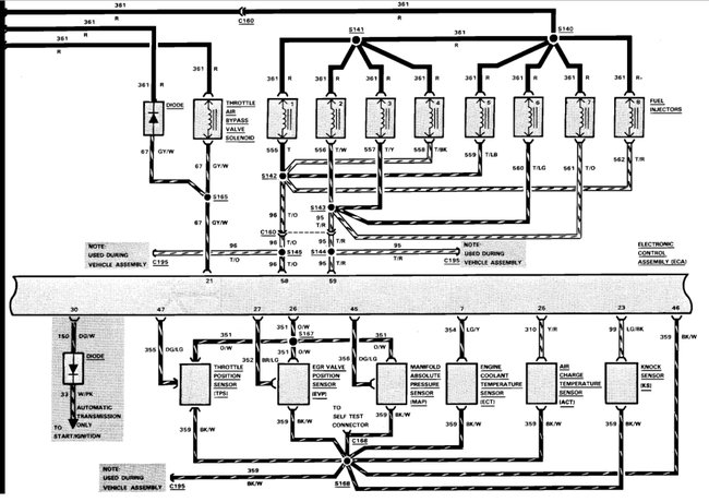

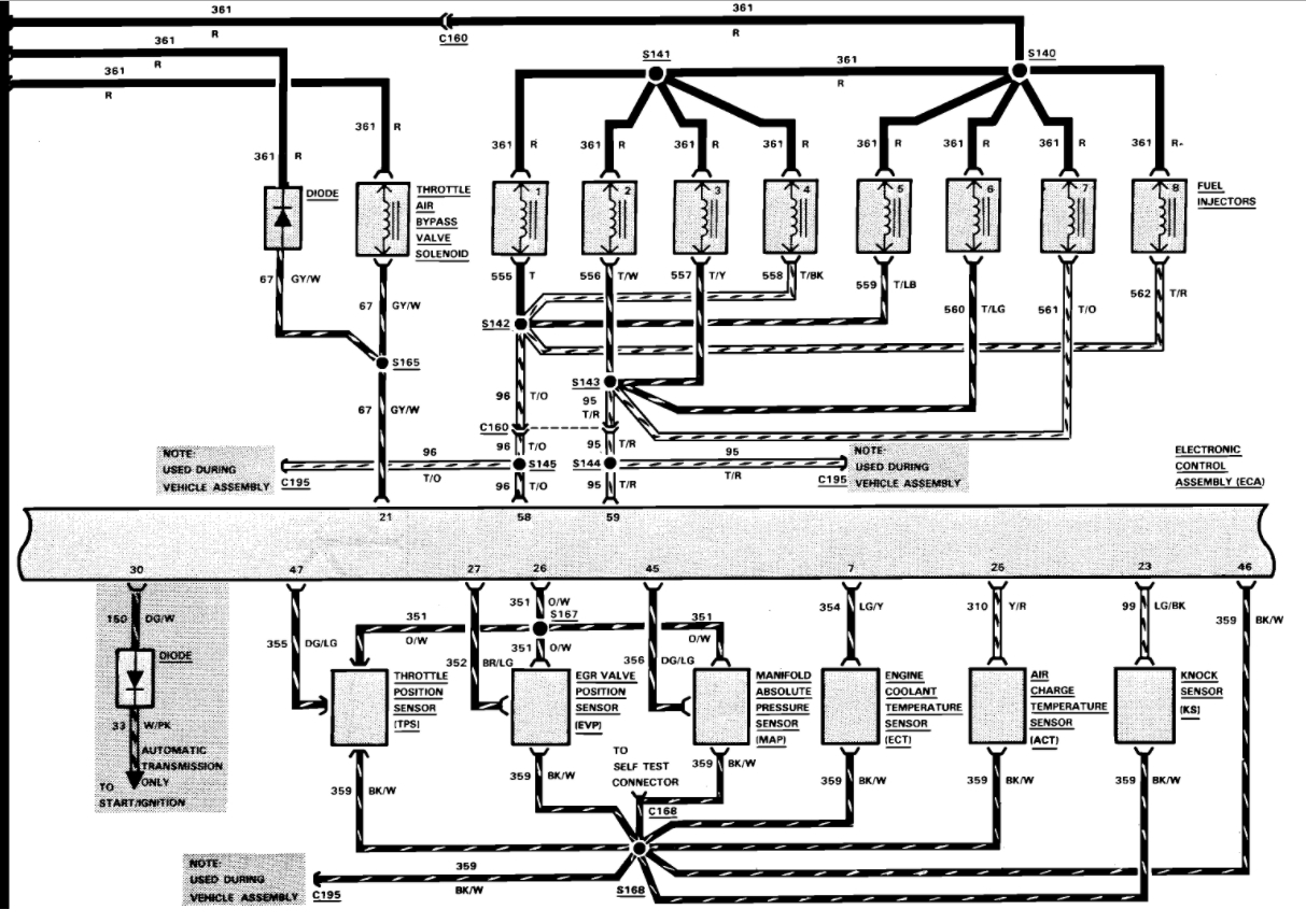

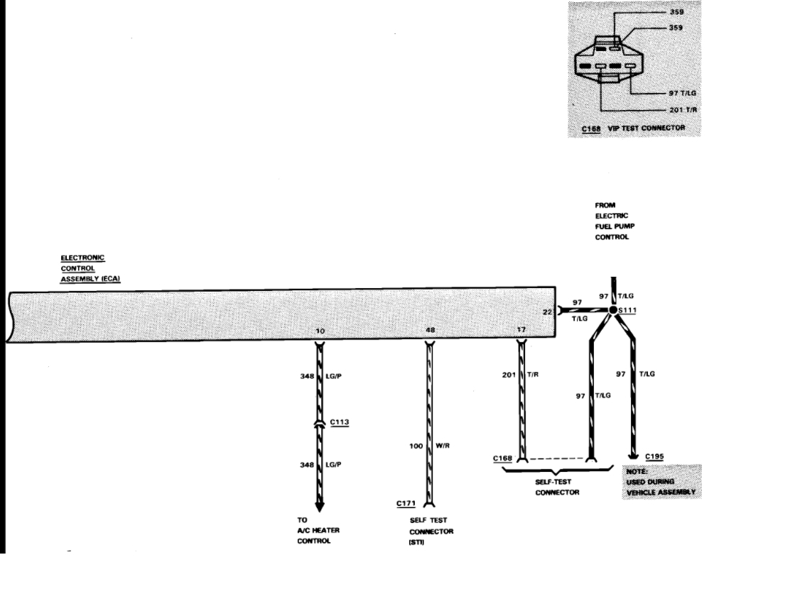

Have you tried starting the engine? The fuel pump must not run unless the engine is rotating, (cranking or running). That's for safety on all vehicles with electric fuel pumps. On most models it will still run for about one second when you turn on the ignition switch. If you don't have 12 volts at the pump at that time, check the inertia switch. Use a test light to check for that one-second pulse. Digital voltmeters don't respond fast enough.

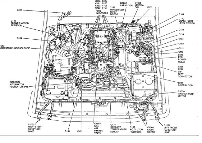

I cut off part of the second diagram so it could be expanded for easier reading. It's just missing the injectors. Let me know if you need the entire diagram.
There's no drawing showing the location of the inertia switch. This is from the service manual: "On F-series, the Inertia Switch is located at the far Left part of the toe-board, near the parking brake assembly. On E-series, the switch is on the passenger side cowl panel, just forward of the right front door".

Yes, the truck has been running during testing. I will check the inertia switch in that manner and return tomorrow with my results. Thank you

The culprit was determined to be a bad wire feeding the inertia switch from the relay. It has been rewired and now works. The truck is all fixed

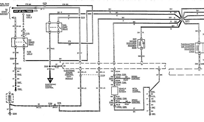

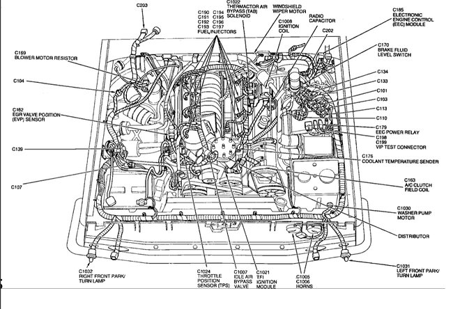

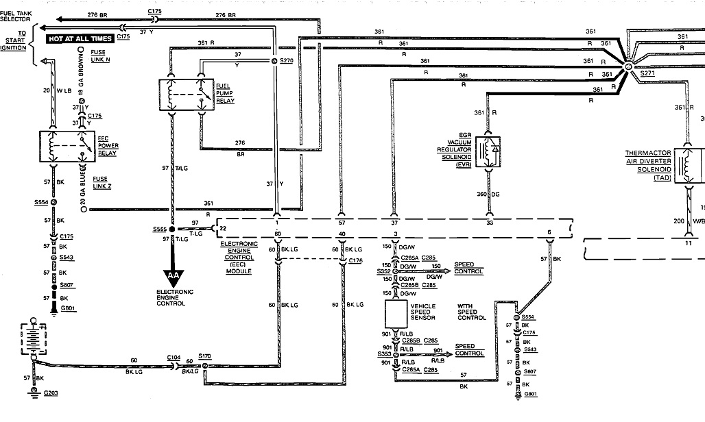

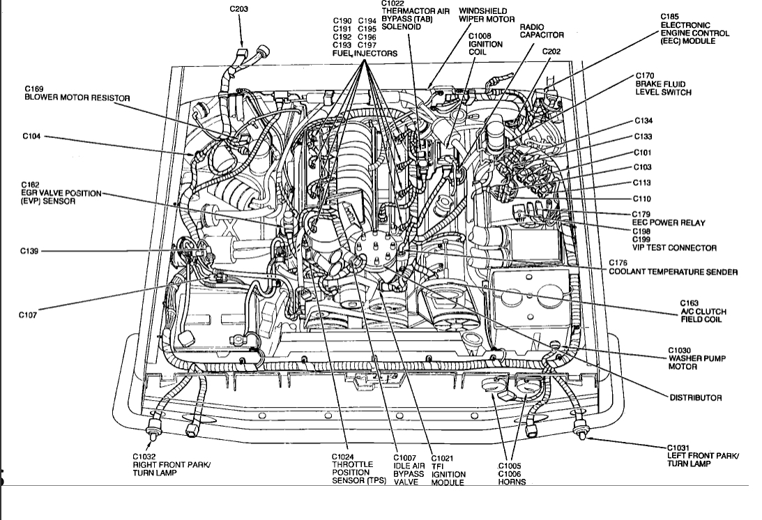

The pump is grounded near the pump (black wire) to chassis .. (pink/black) wire goes to inertia switch then carries on (brown wire)to fuel pump relay .. relay is grounded from EEC module (electronic engine control) which gets it's signal's from ECU/PCM check wiring from EEC module (tan/light green) wire from relay to EEC module.... (red) wire from relay goes to fuel injectors.
LH Side Of Engine Compartment, On Relay Bracket. Fuel pump relay is next to the EEC Relay.

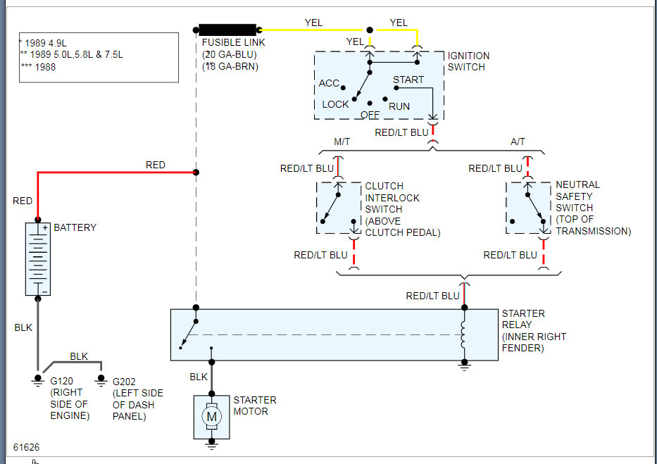

Hi, we have a problem with the truck listed above Custom 5-spd, with dual fuel tanks. When we try to start it, it won't start, no clicks. We figured it out and it was a fuel pump problem. There is no power to the fuel pump. When we turn on the ignition, the fuel pumps won't come on, even with clutch to the floor. Tried checking the fuses, but no luck. What could be the reasons we have no fuel pump power?
Saturday, May 29th, 2021 AT 11:35 AM (Merged)
So we need to check a couple things because we may have a different issue then the fuel pumps. If the fuel pumps are the issue then the engine would crank but not start. So if you are not getting anything when you turn the key then I suspect the issue is different then pumps.
Let's start with the clutch position switch. Check power coming out of the switch to see if you have power. If not, then this may be the issue. Also, when you say you have not power at the pumps, did you confirm that with a meter or test light?

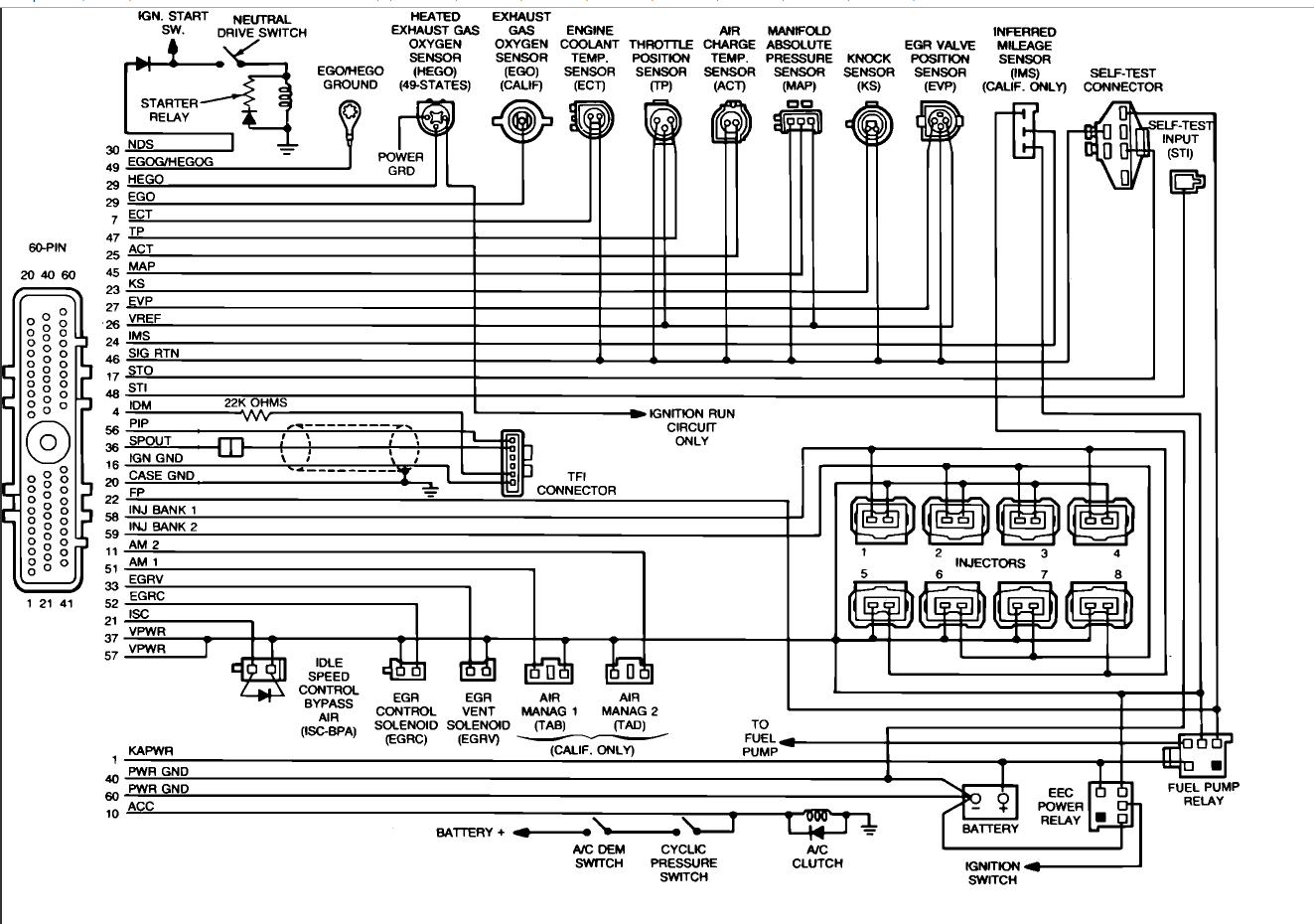

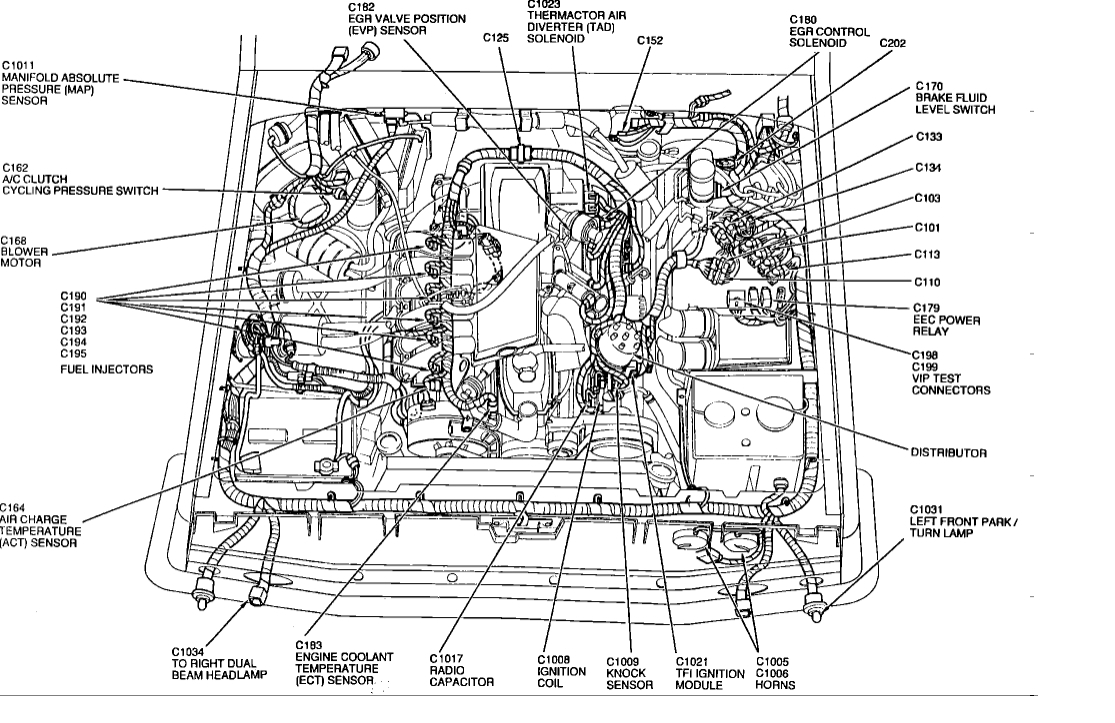

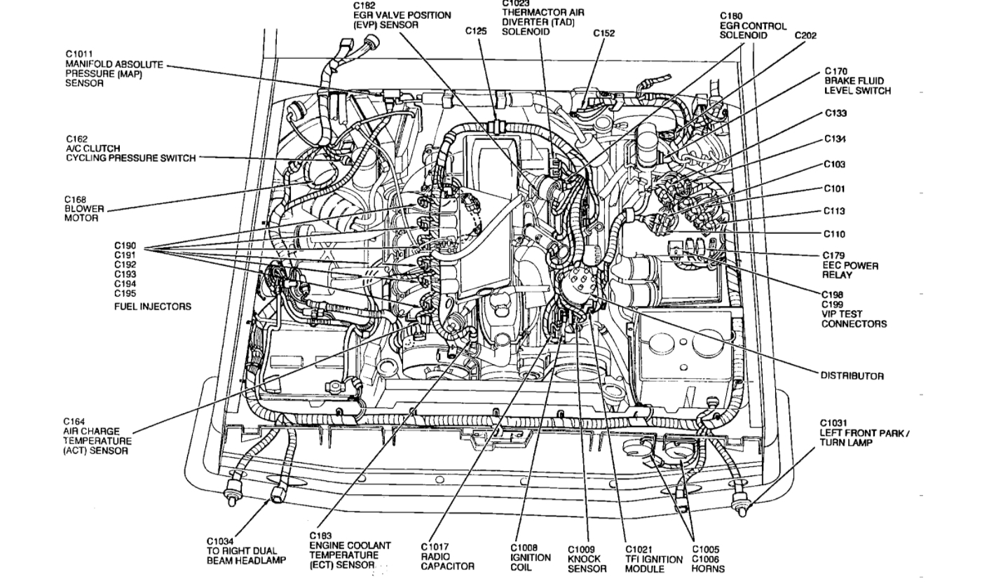

It sounds like the EEC relay is not working here is a guide to help you test the relay and how to test for power
and

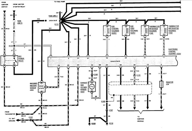

OK are you sure that the main fuel pump is not working? How old is the fuel filter? Do you have a digital multi meter to do some testing with? Have you checked the fuel pump relay? See this truck has 3 fuel pumps a lift pump in each tank and then the main pump on the inside of the frame on the left (drivers) side about under the drivers seat. Then there should be a fuel filter just in front of the pump.
There is a black can back by the tank this is the switch valve sediment bowl. There may be filter in that but we will get to that later. Lets first determine that the main fuel pump isn't working ok. Let me know if when you turn the key on that pump hums, it may be that you will have to put you hand on the pump and have someone turn the key on should run for about 3 sec. Let me know what you find here and we will go from there.
Check out the fuel pump wiring diagrams below. Please run this test and get back to us.

Ok with the relay this is true it should have constant power to one term and switched power to an other term this turns the relay on to send power to the pump. We will get to that in a second. I also must know if the engine from the lincoln is an HO or not. Did the upper plenum from the lincoln say H.O.? This will change the firing order so get to me with that ok. Now back to the relay. Red wire should be constant power. Now the other power comes from the inertia switch. So keyed power to the inertia switch then to the switched side of the relay through the pink wire with the black stripe. Now also if you haven't done so yet up on the fire wall inside near the brake pedal is the inertia switch with a red or white button in it push that and see if it starts here a pic of one.
https://www.2carpros.com/forum/automotive_pictures/249564_DSC01070_1.jpg

The inertia switch wires are 1 wire going to fuel relay and 1 wire going to fuel pump which is pink with black stripe. The red wire on the relay goes to the computer. Yellow wire is hot and goes to switch or coil. It has a brown and blue stripe wire that goes to a red-plug in beside the battey that is not pluged up. It is a wide plug-in and I don't see a place for it to go.
I think I need to check the input wire on the inertia switch to find out why it dont have any juice because you said the inertia wire going to the relay needs power.

Ok great then everything should work fine once we have power to he fuel pump. Now did you check wires to the tank selector switch? Now the pink wire with the black stripe comes from the relay to the inertia switch and then to the fuel pump. Now the power comes from the yellow wire to the fuel pump relay, which is provided from the starter relay on the fender near the battery. Sorry I was reading the wiring diagram incorrectly. So it is like so yellow wire from the starter relay to the fuel pump relay then out the pink wire with the black stripe to the inertia switch then from the inertia switch to the fuel pump. The tank selector switch determines which pump gets the power.
