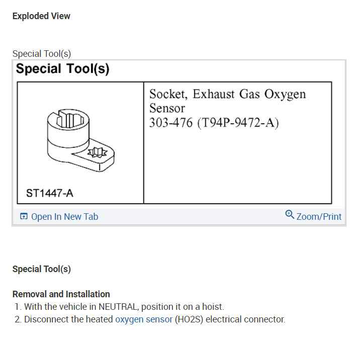

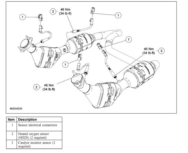

Yes if the heater sorts to the sensing element they can cause the engine to stall here is a guide that can walk you throught he steps and the sensor location and instructions on how to replace net in the diagrams below.
https://www.2carpros.com/articles/how-to-replace-an-oxygen-sensor

JAMIESM2481
Will a bad oxygen sensor cause my 2003 Ford Expedition to not idle? I have to keep constant gas from the petal to keep it running or it will die. Diagnostics sais it was a bad sensor in Bank 2. Which side is Bank 2 on? Thank you
Left as in driver's side??
Nov 12, 2020 at 8:00 AM (Merged)
  • CAR REPAIR CONTRIBUTOR
  • 75,992 POSTS
Bank2 Sensor1 is at left exhaust pipe and Bank2 Sensor2 is at the rear of exhaust system.
Also try cleaning out the idle air control valve and see what happens
JDUB37
i need tochange my o2 sensor in my expedition. where are they or it located at? is it hard to change, and more importantly, do i need any special tools,like an oxygen sensor sockit? thank you in advance, jdub.
BMRFIXIT
  • 19,053 POSTS
you have 4 O2 sensors
https://images.2carpros.com/forum/automotive_pictures/99387_02_V6_2.jpg
