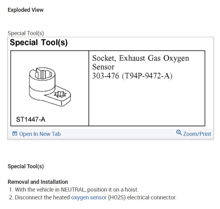

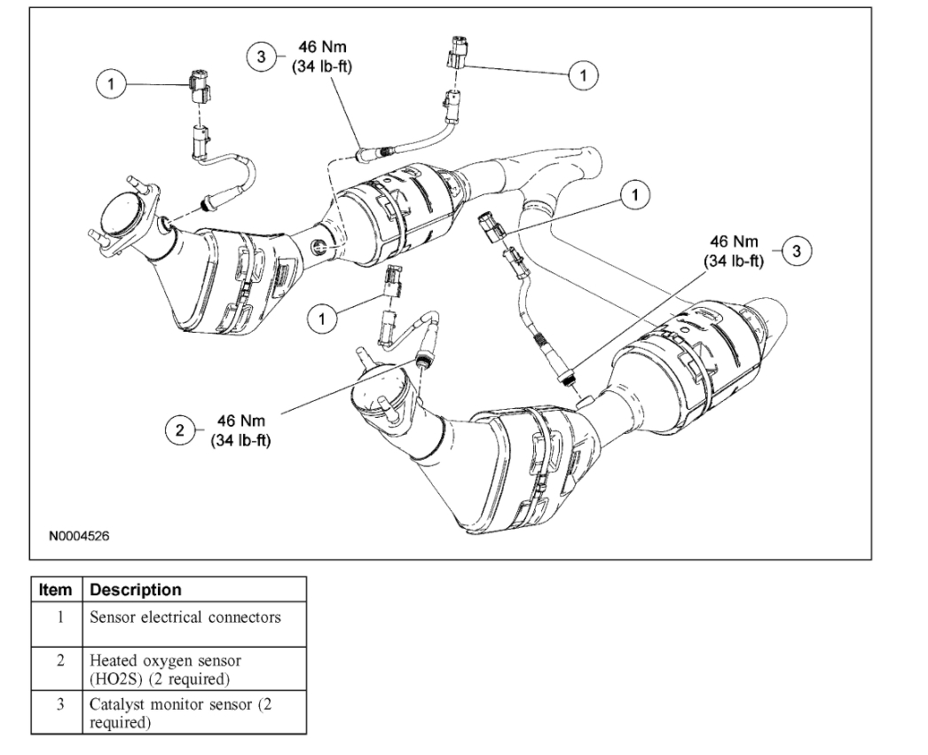

Where is the Bank 1 Sensor 1 location on this vehicle. I need to change the O2 sensor at this location?
Tuesday, November 24th, 2009 AT 4:19 PM
19 Replies
  • 75,992 POSTS
Here is a guide to help locate and change out the sensors, the diagrams below show the location for your car.
https://www.2carpros.com/articles/how-to-replace-an-oxygen-sensor
Check out the diagrams (Below). Please let us know what you find.

Can, t remove the sensor on the front passenger side we heated it and still can, t get it out any suggestions
Thursday, November 12th, 2020 AT 8:04 AM (Merged)
  • 52,797 POSTS
Go in through the right side tire well. We use a special o2 sensor rachett handle to break it loose. It is very tight.
DJCL
  • 767 POSTS
Its a 7 8th wrench or socket
WILLY2BE
  • 12 POSTS
I tried that still would not come out I even applied heat and still no luck I even took out transmission dip stick to get to it
+1
DJCL
  • 767 POSTS
Did you heat the pipe? Not the 02 sensor. @ This point you might need a new pipe or have to repair the 02 hole when it comes out. Is the nut striping or just not braking free?
+1
WILLY2BE
  • 12 POSTS
I do have the rethreader tool cause one of the other ones had to be re treaded and I heated the pipe and the nut just ain, t braking free the nut is not striped yet but i, m afaid that might happen the worst part I seen the nut move alittle bit now it won, t move any further

Work it back and forth spraying it with lube.

Where is the heated upflow 02 sesor located on this vehicle?
  • 109,628 POSTS
The upstream heated O2 sensor is on the exhaust before the converter close to the engine. Here is a picture. It is the best I could find. I hope it helps.
