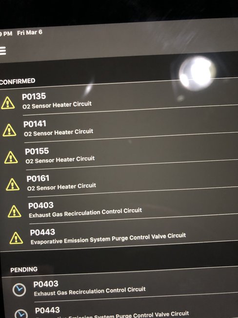

I have the same issue (2008 Explorer-V6), but it's all the sensors on that circuit, all 4 O2 sensors, EGR and PCV, see picture for codes. I checked the fuse (#42) and it's okay.
I recently pressure washed the engine, maybe a connector got wet and corroded?
-1

Hi type 85. Please start a new question specific to your vehicle. A 2008 model is as different from a 1997 model as they are from a Model A. The standardized computer language, and fault codes, are different too along with how most circuits are monitored.
The bigger problem is unlike with other forums where anyone can chime in and confuse the issue, this was a private conversation between just two people. As such, none of the other experts are going to see your addition or have a chance to reply. That is likely to not get you the help you need. Here's the link to post your new question:
There's at least a half dozen experts here who are real good at solving emissions problems. Your new question specific to your year and model also helps in categorizing them to help others who might be researching the same problem. Please be sure to list the engine size and mileage. The recent pressure washing is a valuable observation too, so be sure to include that again.
