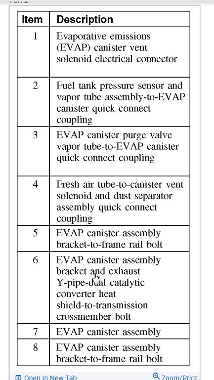

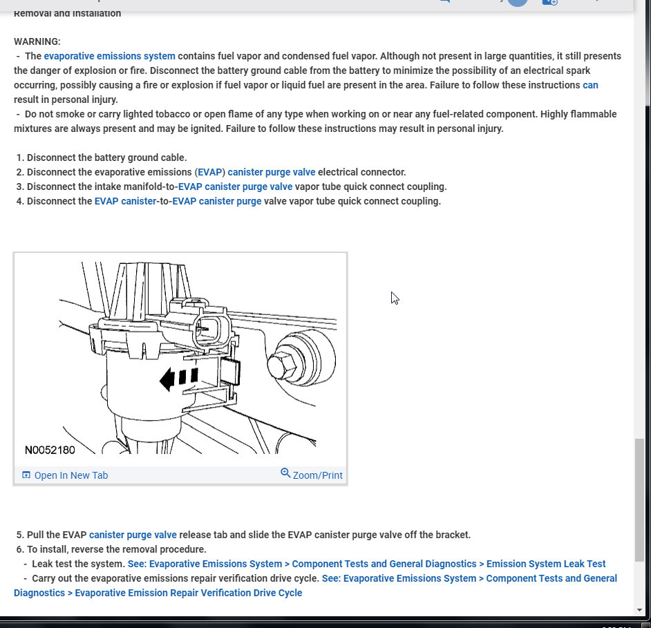

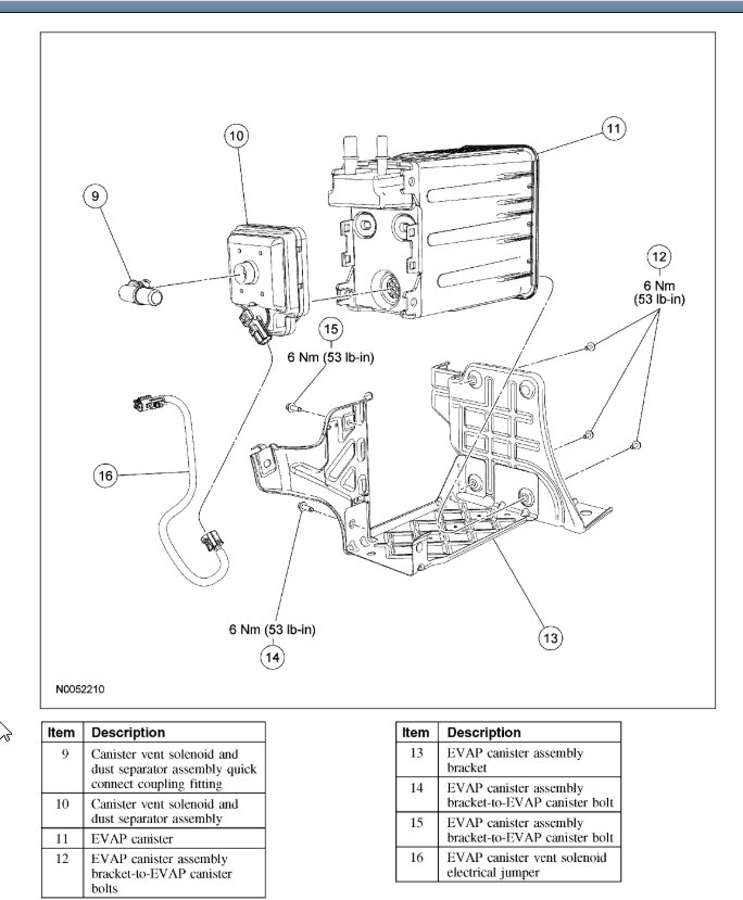

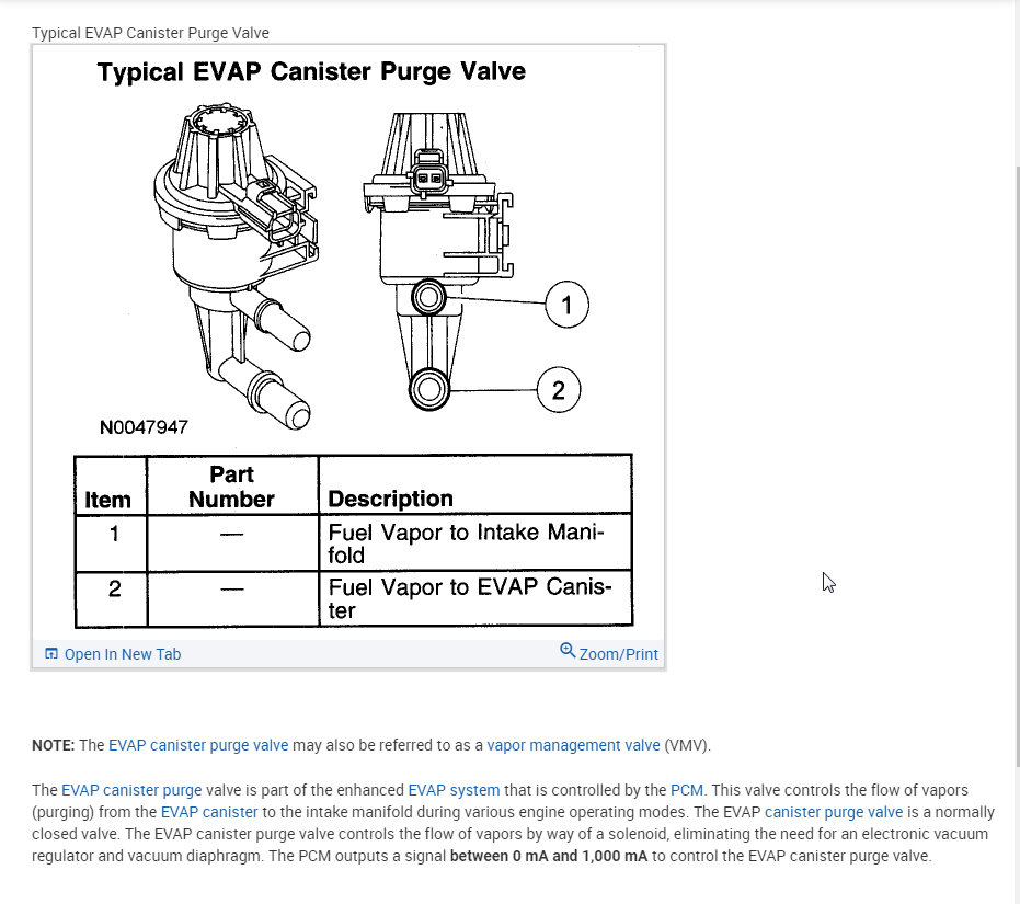

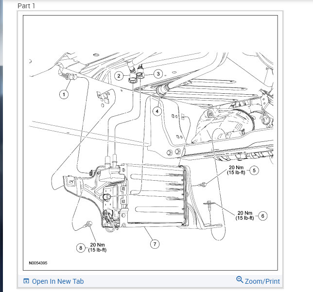

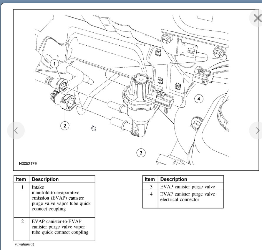

I suspect this is the purge valve that is sticking as it would explain why it is intermittent. Basically the engine purges during idle times and if reving the engine smooths it out and until it stops would fit as well because you are basically allowing more air in to even out the air/fuel ratio.
I would remove the purge and see if there is carbon in build up in it. Basically what happens is if you top off the fuel tank, fill the tank with the engine running, or the charcoal canister gets fuel in it other ways, it breaks down the charcoal. This then causes the charcoal get get into the purge valve and cause it to stick. Once this happens, there are fuel vapor coming into the engine when the PCM doesn't expect it making it too rich or even too lean if it is stuck closed and the engine will run rough or stumble.
Let me know if you have questions. Thanks
