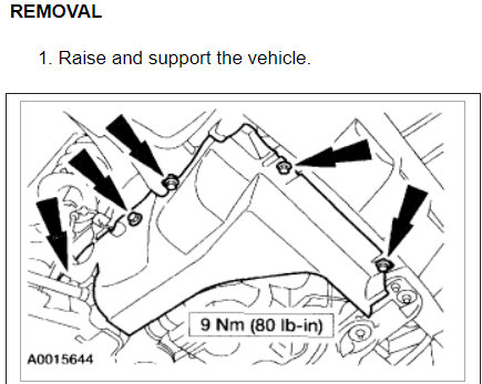

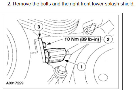

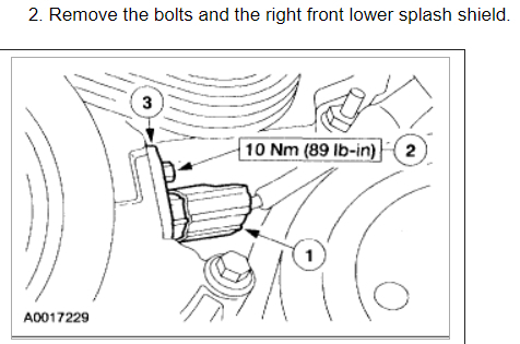

KEN L
  • MASTER CERTIFIED MECHANIC
  • 55,404 POSTS
This sounds like a crankshaft angle sensor is failing which can happen without triggering a check engine light. Here is a guide to show you what you are in for when doing the job:
This is what it will be like for your car (below).
Here is a guide that covers all of the bases:

KEN L
  • 55,404 POSTS
Yes is sounds like the crank angle sensor has failed, when this sensor fails it sometimes wont throw a code, here is how you check it https://www.youtube.com/watch?v=RvuzZJqQDf4
