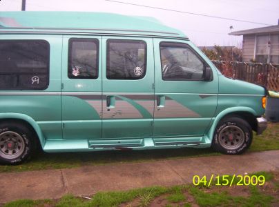

vents will only work on defrost and floor not the front or face ports any idea i like a dashboard exploded view but cant find one must be a big ford secrect
http://www.2carpros.com/forum/automotive_pictures/426421_big_van_002_1.jpg
