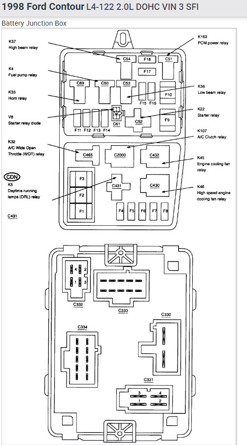

1998 FORD CONTOUR

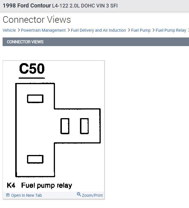

Where is the fuel pump relay located?
Thursday, June 4th, 2009 AT 11:02 AM
SQM
MECHANIC
6,383 POSTS
The fuel pump relay is located in the fuse block under the hood.
I have attached the diagram (see below) for that fuse panel. It should be number K4.
