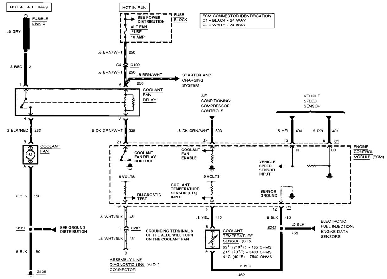

Steve I can run just about 180 to 200 F when I only run with the A/C on. This keeping the fan on. When off it goes red line. I did see the fan cycle at one time a few days ago, but not on a regular basis, this being red line temperature. Since I changed out the relay, new therm, etc. Any new ideas I can try?

Normally the fans won't turn on until about 210-218 degrees. With everything else it sounds like the ECM isn't responding to the coolant temperature sensor to turn on the fans. That points to the ECM as the failure point as the rest of the system is working.

The only item really left that could cause it. Normally on those if the wiring was broken it would tun the fans on and if the sensor is unplugged it would do the same. In this case it sounds like an internal ECM fault, either a broken trace or some 5 cent part failed on the board.

Following your comment on unplugging the sensor, in my case it does nothing to unplug.
Like I said earlier, I did see the fan kick in, but in this case the temp gauge was red lined. It should of been cycling on and off certainly I would think below 220F.

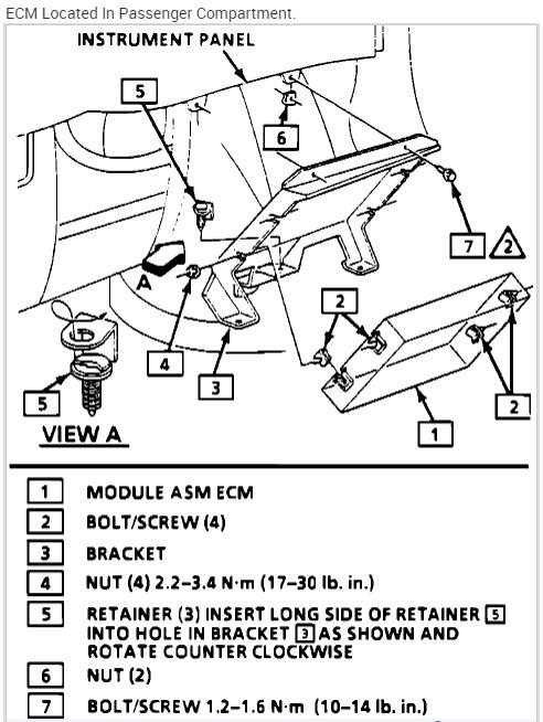

Think location of ECM is under dash on passenger side if I can rememeber. Is there some reference to this somewhere?
Thursday, July 30th, 2020 AT 11:30 AM
STEVE W.
  • 15,702 POSTS
Yes it's behind the glove box area. See the images below. You or the mechanic will need to swap the PROM and if installed the Cal-Pak chips over to the replacement unit.
This is from the service info on that car -

When replacing a production ECM with a service ECM, transfer the broadcast code and production number from the production unit to the service unit. Also, during replacement, the PROM must be removed from the ECM being replaced and transferred to the new unit. Some ECM's are equipped with another chip called a Cal-Pak. If the ECM if equipped with a Cal-Pak chip, it will be located next to the PROM and must be transferred along with the PROM.
1. Disconnect battery ground cable.
2. Then disconnect two computer electrical connectors.
3. Remove computer mounting hardware.
4. Remove computer from passenger compartment.
5. Reverse procedure to install.
