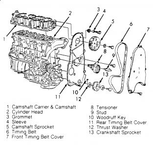

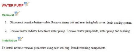

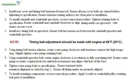

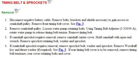

1989 Pontiac Sunbird 4 cyl Front Wheel Drive Manual
How do you change a water pump on a 1989 Pontiac Sunbird 4 cylinder
Tuesday, June 23rd, 2009 AT 4:18 PM
BLUELIGHTNIN6
MECHANIC
16,542 POSTS
Hello and thanks for the donation!
Below is the information you requested..
FIGURE 3
