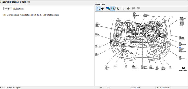

The engine will not start, want to check fuel pump relay.
Wednesday, February 3rd, 2021 AT 7:02 AM
3 Replies
SEVAG P
MECHANIC
405 POSTS
Hello.

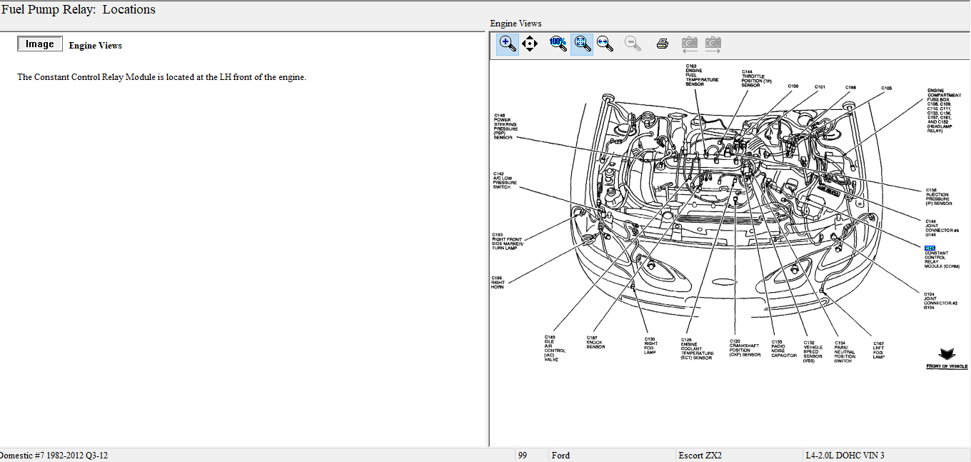

Ford Escort 1999 turbo is 4 cylinder 2.0L engine no v6 turbo, check the diagram below figure 1 for fuel pump relay location.

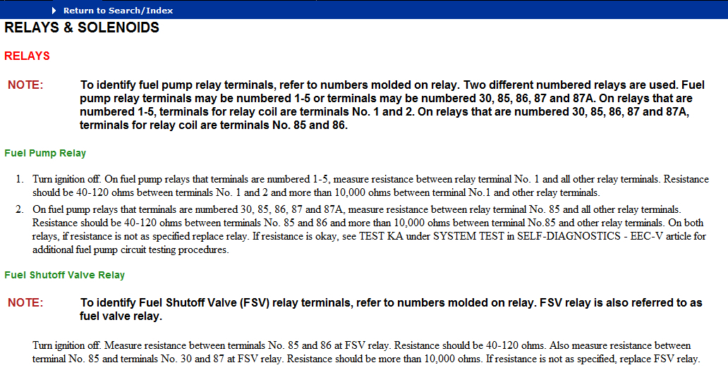

check figure 2 below procedure how to check fuel pump relay.
check our link below how to check relay and how to test a fuel pump.
