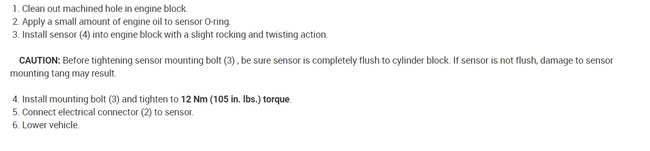

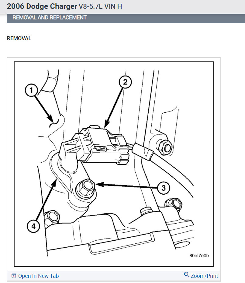

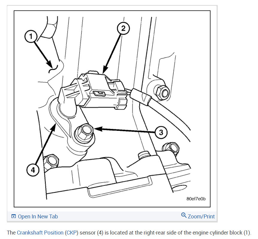

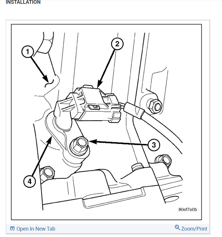

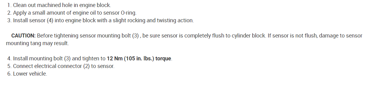

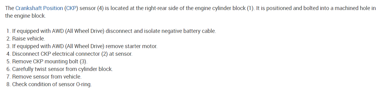

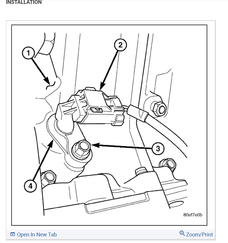

This sounds like the crankshaft angle sensor or the fuel pump has gone out, when you turn the key to the on position without cranking the engine over can you hear the fuel pump run in the tank for 5 seconds? These guides should help us fix it:
https://youtu.be/dCjmRL3p4Cs
and
Also, lets run the codes to see what come up.
if you can hear the fuel pump prime here is the location of the crankshaft sensor.
+1
Saturday, June 5th, 2021 AT 1:12 PM (Merged)
STARLORD1976
  • 173 POSTS
It was the crankshaft sensor thank you.
