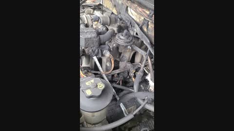

Engine runs rough and codes PO175, PO172, PO351, PO161 and PO141

I can't really see good enough. I can say this, some of the components are melted on the back side.
Friday, October 29th, 2021 AT 11:47 AM
SQM
  • 6,383 POSTS
If the pins got hot enough then it will melt the base of the pin. So good chance the injector connectors are melted.
Friday, October 29th, 2021 AT 12:41 PM
SWEETIE1965
  • 158 POSTS
I believe they are. So I'll need wire harness and all components, including fuel injectors.

I don't think it's too bad. Just a couple of sensors and check fuel injector connection. Repair/Replace as needed.

I found 8 problems. Three faulty fuel injectors. I had my right foot amputated so I can't do too much so I got this guy that came recommended to me by a friend. Well, the passenger side is fine. The driver's side had to leak gas then caused a fire under the hood. Needless to say, I have never heard from the guy since. He changed his phone number, and I don't know what else to do. I need to look at the video I attached and tell me all parts that need to be replaced and a rough estimate of the cost of just parts needed and the name of the parts. I will find the guy and sue him for the damages.

Looking at the video, it appears to have quite a bit of damage.
Besides the injectors, you will need to have the wiring harness for them and might need the engine harness as well. Of course, the fuel lines and the fuel pressure regulator.
I agree with you on the video, the best course of action would be to go to a junk year or one of those pick n pull places where you can remove the parts that you need from vehicles and take off the items that are burnt.
As for the cost, it will depend on what all the parts have been replaced.
But if you were to take this to a shop it is easily a few thousand dollar's worth of repair.

I plan on buying the harnesses brand new. The injectors I can get them from Amazon. The fuel pressure regulator I replaced before my amputation, so it has a warranty. From the video can you tell me the names of the parts that you can see that need to be replaced? I know most of them. There's about 2 or 3 which I'm not sure about
