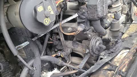

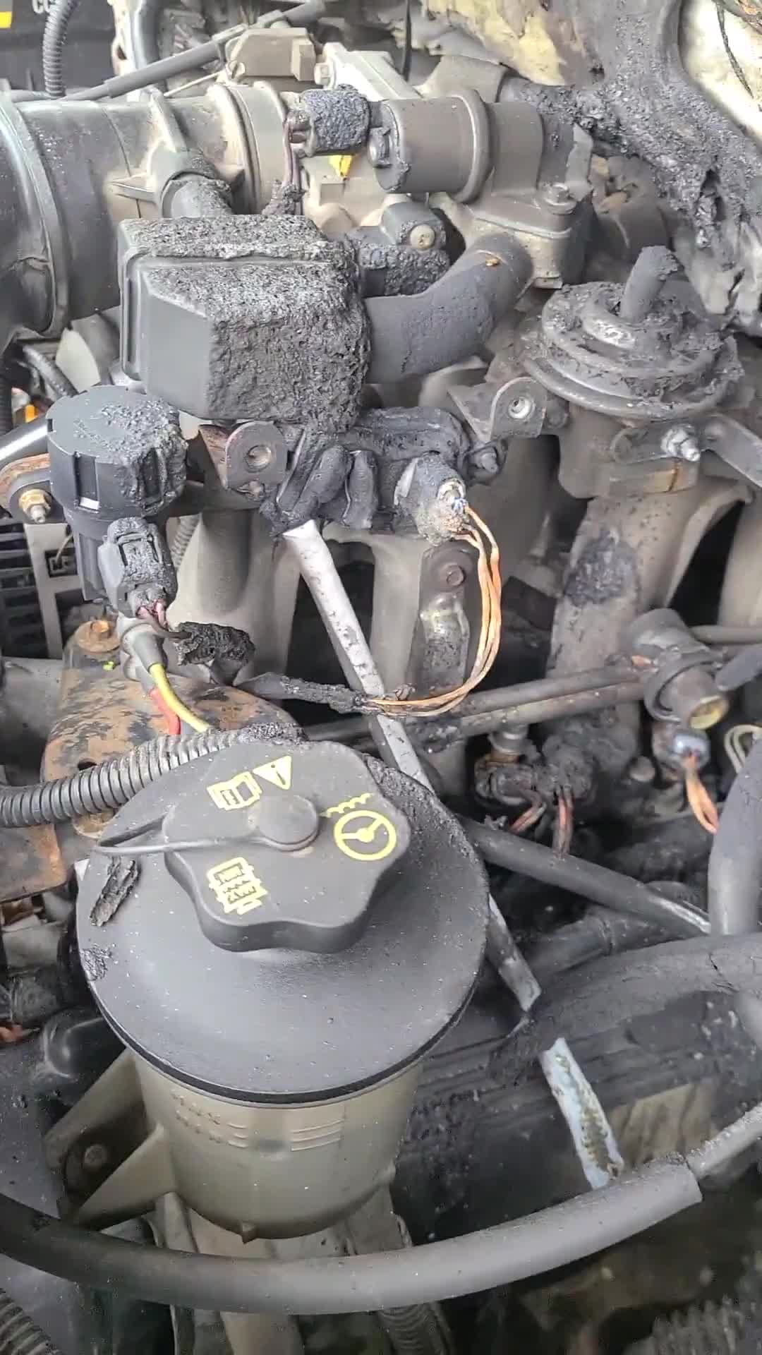

Good morning. I received the new fuel injectors. Then I had to have emergency surgery or lose my foot. Well. While I was in the hospital, my stepson said he knows someone who can change the injectors. I said okay that's great. Well, when I got home from the hospital yesterday, I popped the hood on the truck to check things out. I was very seriously shocked to say the least. Almost the entire driver side of the engine was burnt! Now this guy isn't answering my stepson's calls or anything. My question is, what would be a good, educated guess of repairs needed now? I know these for sure: coil packs, fuel injectors, hoses, EVAP solenoid, mass air flow. When I am able, I will take a few pictures to send you so you can see the damage done. And can I force him to pay for the repairs.

Wow, that is crazy with the truck. I wonder what he did.
I hope you are doing well though.
As for the burnt parts, can you upload a video of what you can see is burnt?

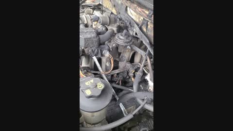

Here's a video.
Friday, October 29th, 2021 AT 7:10 AM
SQM
  • 6,383 POSTS
That is quite something with all the damages. I think it will be the best option, as you mentioned in the video, is to go to a junk yard and take off all those components from a truck. All the harnesses and lines and any other burnt components.
From the video it looks like all those plastic components got burnt.
Did he install the injectors on this side?

Yes. They were installed on both sides.

I would need to remove all damaged components. Would I remove the main power cable from the PCM to the battery?

If the main cable is burnt/melted, then yes.
From the video it looks like good amount of work. I think the best approach would be to first get those replacement components then start the remove them from your truck one at a time. This can help with keeping track of all the locations for those parts, especially the wiring harness.
Can you tell if it melted back of the injectors?
