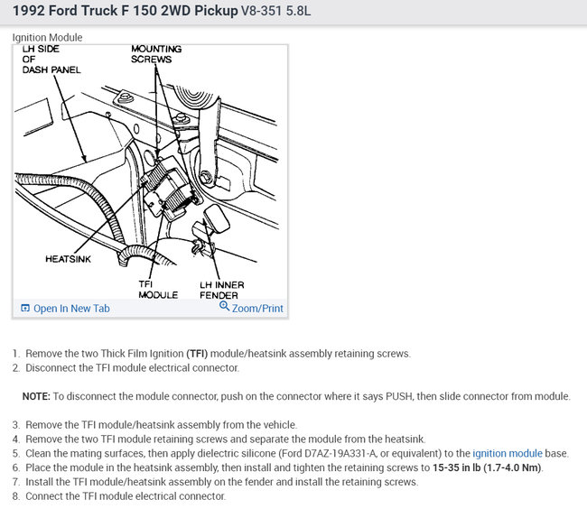

New fuel filter, fuel present at rail. New Throttle position sensor. Recently new tune up which included plugs, wires, cap, rotor, oil and oil filter, air filter, new battery with clean connections.
Engines starts ok, drives great for about 2-3 miles. Then starts missing very badly will not accelerate and eventually dies. Cannot be restarted until the next day.
Need some advice as to where to begin? Any help will be greatly appreciated. Thanks very much.

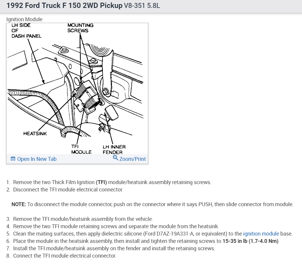

Most likely the TFI Module located left rear engine bay. see diagram below. Check out the diagrams (Below). Please let us know what you find. We are interested to see what it is.

Thank you so much I will replace this today! I appreciate your help.

Let me know how it goes. This guide can help as well.

Replaced the TFI module. It has done the trick. Truck is running great now. It seems to be getting better gas mileage although not sure yet. The smell of gas is considerable less at the exhaust.
Thanks so much Doc!
