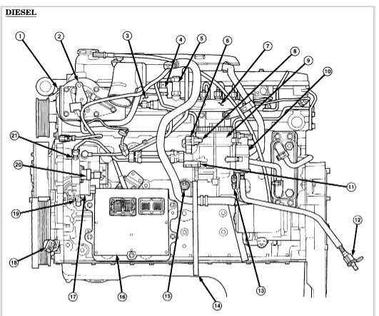

My battery(s) died Friday. I tried jumping it with another Dodge truck and it wouldn't start. I bought 2 new batteries from interstate and installed them. My truck turned over and started right up. I parked my father's truck and went my truck and it had died in the space of 45 seconds or so while I parked my father's truck. I couldn't hear my truck during this time so I had no idea if it had started to choke and cough or if it had just suddenly stopped running. My over head computer says I have 50 miles until empty, my fuel gauge reads an 1/8th of a tank left. I just put in 2 gallons of diesel (encase that may be the issue), but it will not start. Turns over just fine. Lots of cranking power. It just won't run. At all.

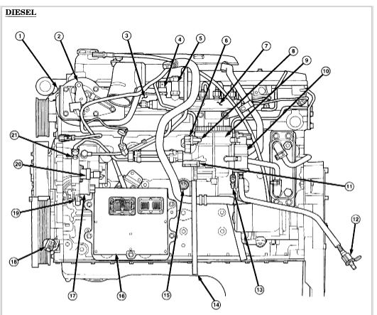

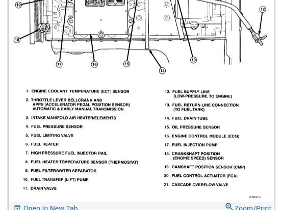

Okay, as I suspected it sounds like you have an issue with the lift pump. I have attached a diagram showing the fuel system. The other issue you are likely to run into is very poor fuel quality proportionate to how long it has been sitting. I would recommend using cetane booster and diesel dry to help revitalize the fuel, and depending on your fuel level adding fresh fuel to dilute the bad fuel. As you can see in the diagram the lift pump is at the back of the fuel filter housing however before condemning the lift pump I would recommend getting a small container of fuel and disconnect the line coming from the tank and put that in the fuel then turn the engine over with the fuel filter out and top off of the filter housing and see if you get any fuel being pumped into the housing. If you don't this will confirm the lift pump is not working. And a quick note about the diagram the feed line ( from the tank ) is mislabeled in the diagram, it will be the line going from the pump to the frame rail. The next thing I would do is check for power to the pump when cranking, a simple test light will do this just fine. If you unplug the pump and check for power while cranking the engine and also reverse the test light by connecting the grounding clamp to the positive post of your battery and see if it lights up brightly on the ground side of the circuit to confirm it has a good ground.

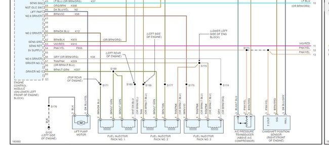

I have attached a diagram of the wiring to help you with the test. I am also including a link to our tutorial on testing wiring here:
If you have good power and ground to the pump and the fuel filter housing doesn't fill then the pump is faulty and needs to be replaced. Please keep us up to date on your progress.
